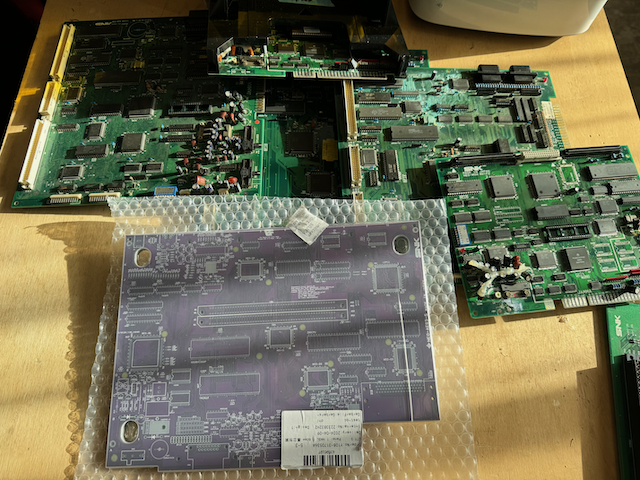

Huge thanks to @xodaraP for sending this Anzac care package of goodness - there is way, way more, this is like 1/4 of it.
With this enormous stash of NeoGeo spares I'm now ready to complete all my half done repairs. AND build my own AES for only 4x what it would cost to buy a tested fully working one :)
Most of the BOM is reasonably straightforward, except for all the bits that are unobtanium and need to be salvaged from an existing board of course.
