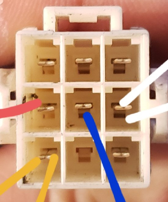

Here's the pinout for those wiring directly to the stick at the connector. I eventually figured this out from the posts in this thread, but @XeD sent me this fine piece of art which I'm sharing here for people to reference.
Luckily I had ordered a bunch of random YL, VL and NH connectors from JST before they faced their stock shortages, so I will make a proper harness on the weekend. At the moment it's wired directly to the pins for testing and in case of any troubleshooting.

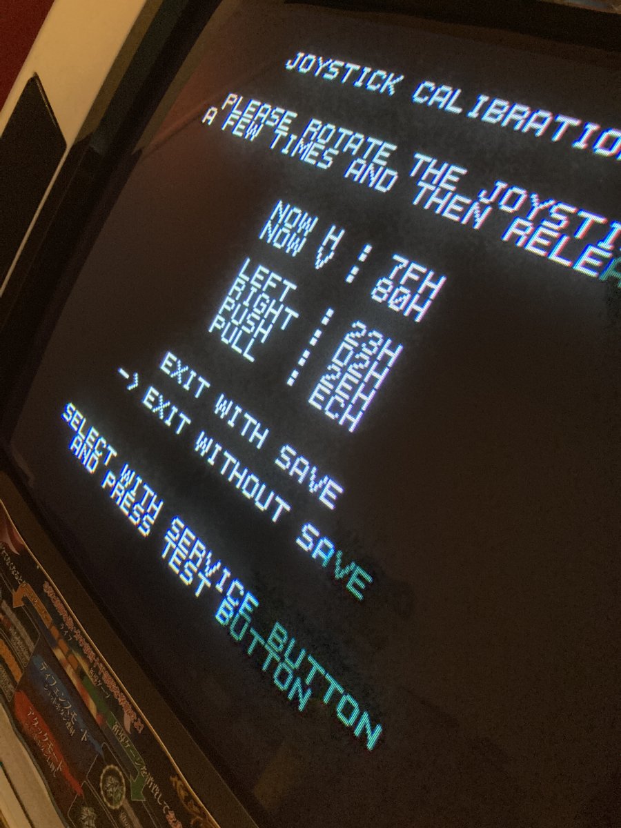

Also, reporting my calibration values below, as wired directly to the Gundam stick. Converted from HEX to DEC:
LEFT: 35
RIGHT: 210
PUSH: 46
PULL: 236
Not sure how these compare to other users or the original stick, but it seems to run well.

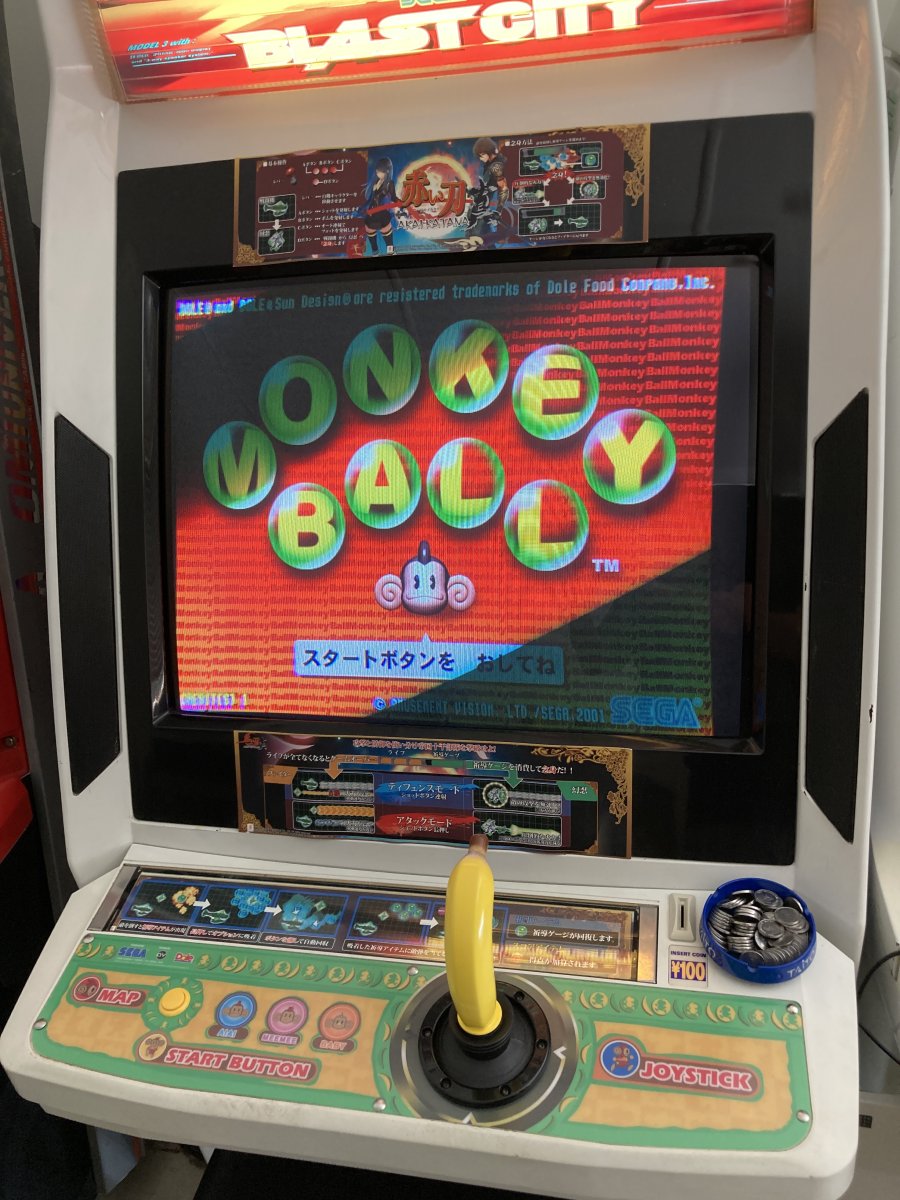

And here she is mounted in the cab, couldn't be happier! I might have to find another cab to mount this one in permanently, can definitely see myself sinking time into this. I also need to peel off the plastic off the control panel, which will make the colours pop out more and install some arts.
