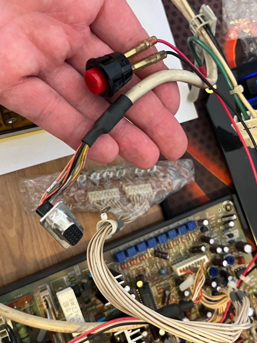

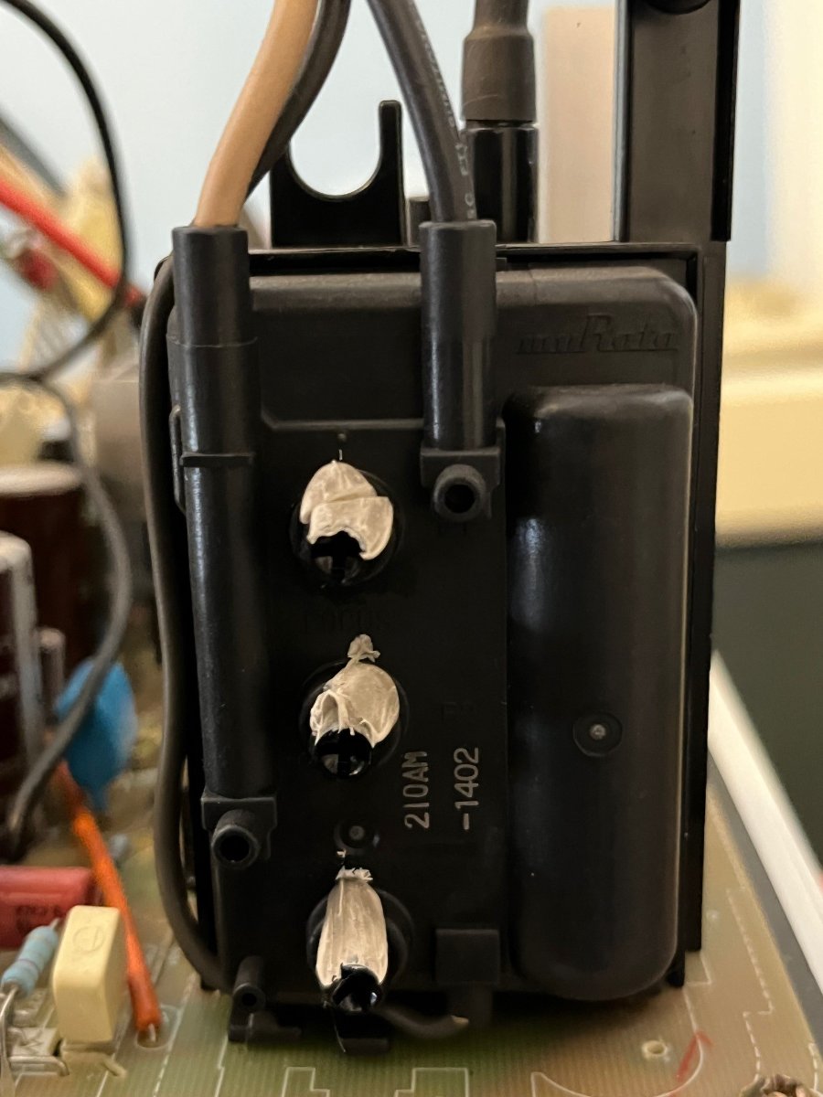

I recently ordered a (junk labelled chassis) from yahoo japan auctions for what i thought was meant to be a dead Nanao MS2933 (for parts). Instead, i have been sent what looks to be an almost new Toshiba PD0214 Arcade Chassis. This thing really looks like it has been seldom used or has been given an excellent cleaning job.
Anyway, I cant seem to find much info about this chassis except for that fact that its most likely a tri sync and has dual focus. It only appears to have a VGA input.
Does anyone have any more info on this particular or similar chassis? (PD Toshiba's) Or know if these is a decent Tri Sync board...
Would anyone have the required Yoke Specs to match ? Reading the above very helpful posts, if i can find a yoke that reads 0.200 - 0.280mh on the horizontal that would be a very good start if this is indeed a trisync.
Im just trying to figure out if I sell this as is, or end up using it for something: EG a project with one of the EDTV / HDTVS i have that are 68 CM and VGA Enabled.

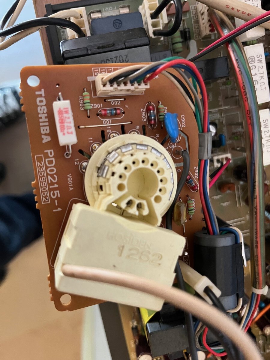

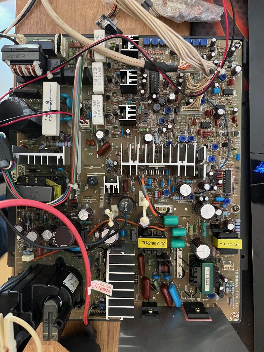

Here are some pictures of the chassis .
Appreciate any advice or help.
That's an odd chassis. Middle connector is labeled 25K, but nothing else to swap to it.
PD0032 and PD0613 are both dual sync chassis.
But then there's the dual focus socket?
Anyway, I wouldn't make too many assumptions on what that thing should be connected to. You could look up info on the ICs.
My only guess is this may have been used in some sort of showcase cabinet in the model 2/3 era where big dual focus tubes were common and they needed mid res. Konami was known to commission custom chassis from Toei and Toshiba, so it's possible it's from some larger Konami game.

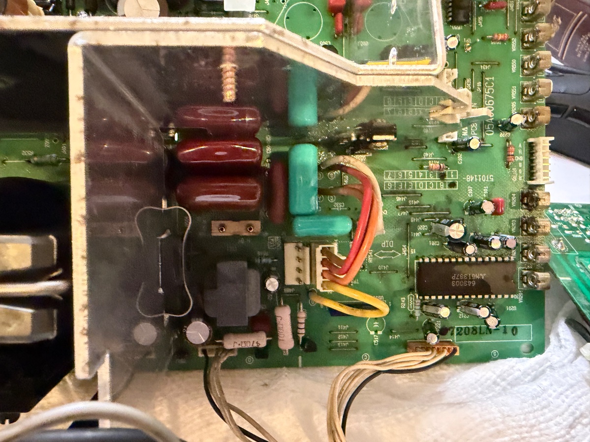

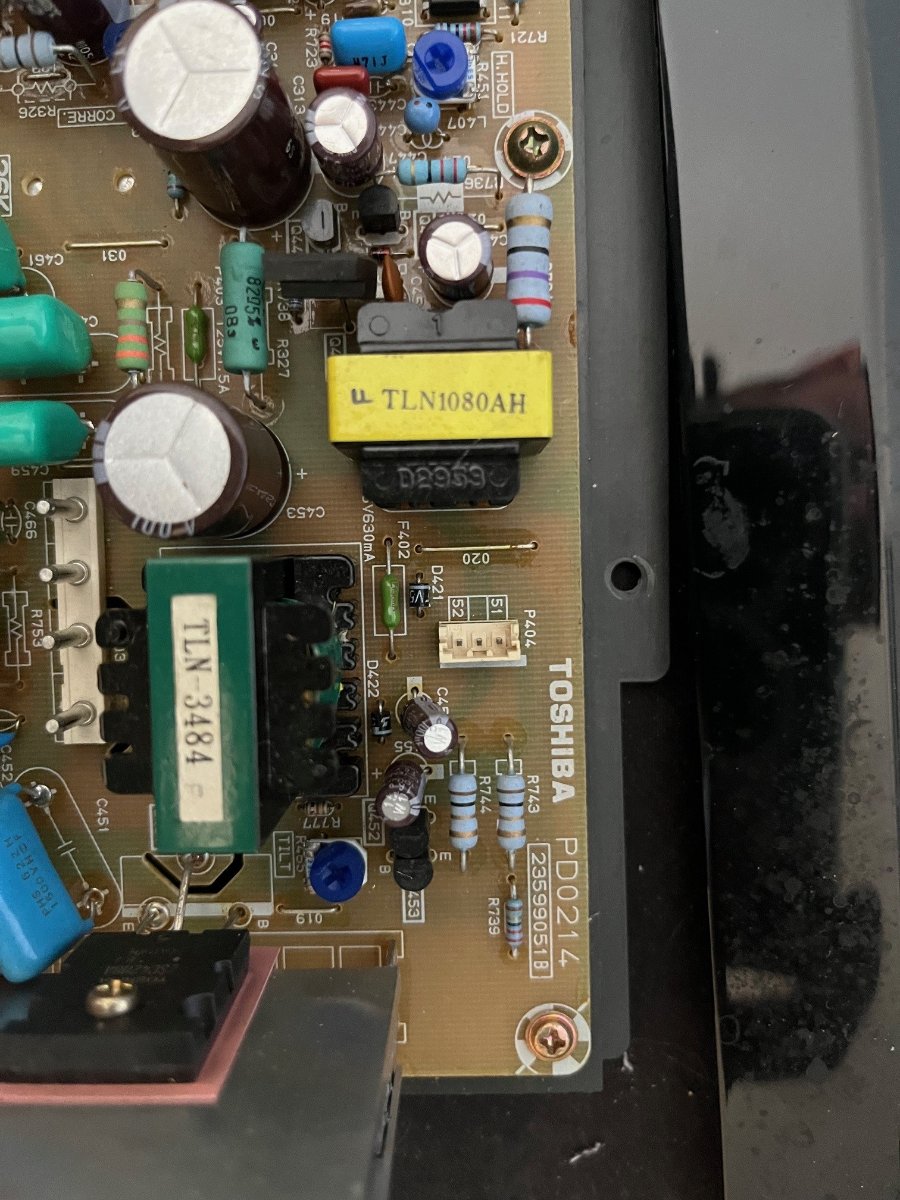

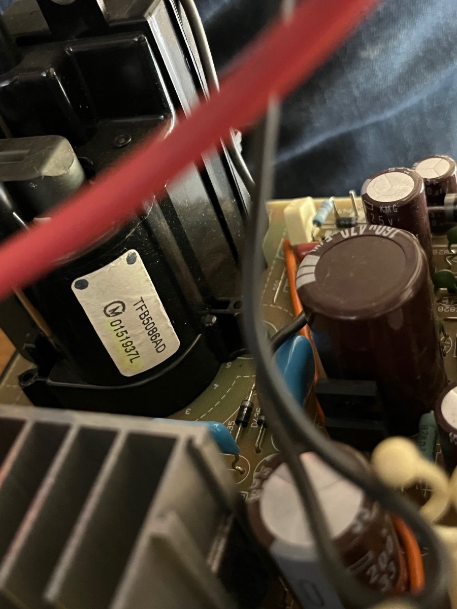

Update: x 3 Chips noted on the board are LA7856 , Mitsubishi M52327SP & TDA1675A (Vertical Deflection) . Chat GPT is telling this is a 15khz chassis with these chips but a quick google shows these chips can be indeed used on some tri sync chassis, such as the LA7856 can be found on some Sanwa Trisync's. I definetly need to research more.

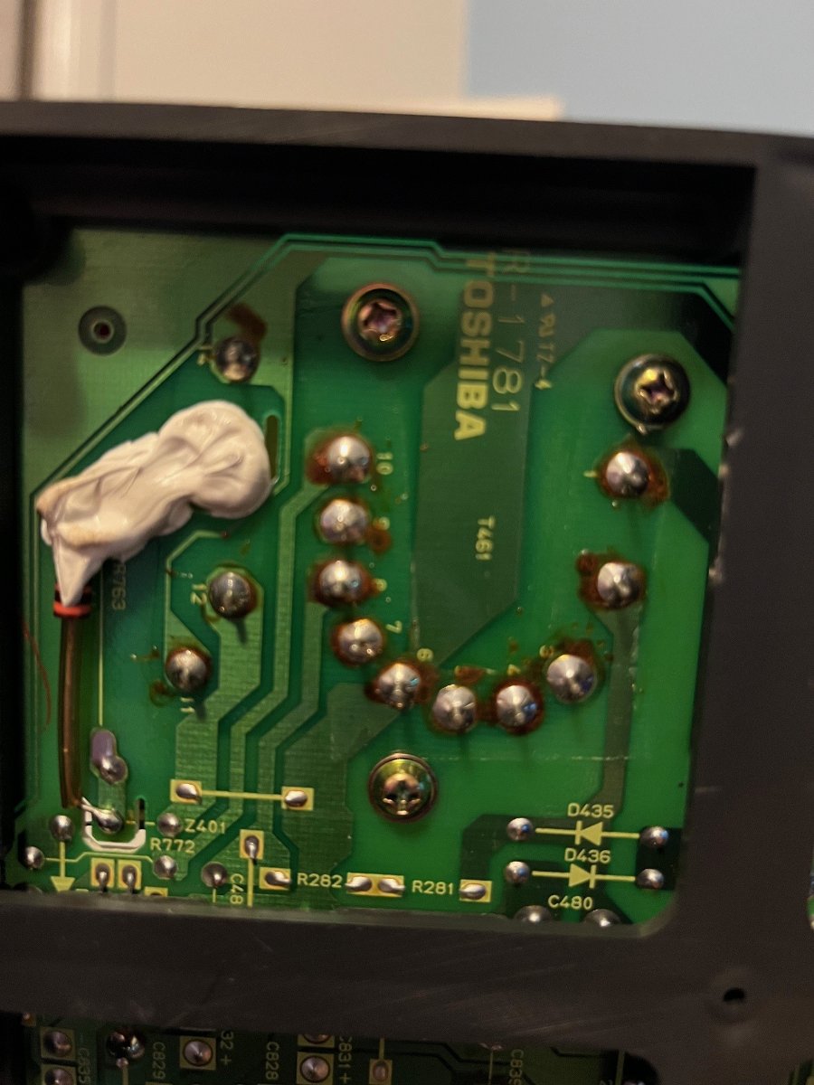

Update 2: Now i feel a bit silly, flipped to the underside of the board and we have another model number guys - Toshiba R-1781
When i google this i find many differnt results
Toshiba (from MSV-U4 / 25)
Tube: A59JMZ90X
Neck: ?
Chassis: TOEI TC-HV25LMK
Yoke:
LhLvRhRv
0.46mH18.51 mH 0.8 ohm9.4 ohm

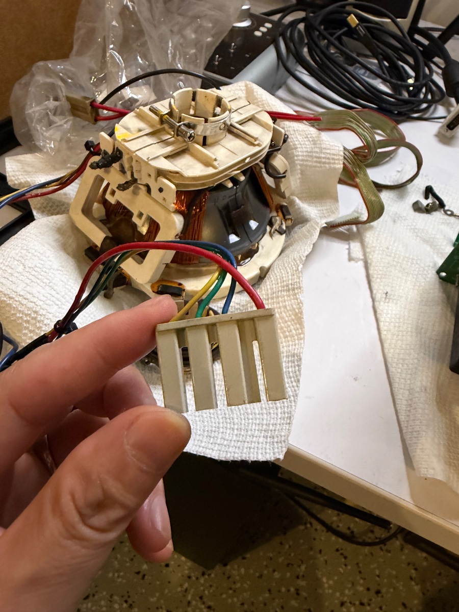

I’m trying to fit a ms9 yoke with an ms9 chassis but seems like the colour connectors do not match. Where does the colour signals go from the chassis?
That's not a MS9 yoke. MS9 yoke have a separate connector for the horizontal and vertical. This looks more like a MS8 yoke.
The other thing you can do is break that connector and make it into 2 connector. But I don't recommend it.

You may need to re-pin some new connectors that fit the two separate connection points on the board. There is another you’ll see like the one you photographed but with a narrower pitch from memory. You may even be lucky enough to cut that exisiting four-way connector in half and plug the now two connectors straight into the board - if the pitches are correct.

I would persist with this one personally. Measure the distance between both the horizontal and vertical deflection pins on the board and see if that matches the distance between the two groups in your four way plug. RED/BLUE and the other two. If the same then that’s good. You could cut it in half and connect them - as long as the female pin on the cut plug is the right size to fit. You could test that first by just plugging in one pin of the four as a test. Power off etc obviously. This is from Grok AI:
Those four wires are the deflection yoke leads (two for horizontal deflection, two for vertical). On a Nanao MS9 they plug into the chassis as two separate 2-pin connectors rather than one 4-pin plug (the MS8 often used a single 4-pin).
Typical colour coding on MS9 yokes:
• Horizontal: red + blue
• Vertical: brown + yellow (sometimes brown + white/grey)
On the chassis the headers are usually labelled CN501 (horizontal, closer to the flyback, wider pin spacing) and CN401 (vertical).
The plastic housings themselves are small 2-pin connectors (commonly sourced as 2.36 mm pitch types such as the CM1001 style from arcade parts suppliers). They are not a single well-known branded series like the JST VH/EH used elsewhere on the MS9; people just call them the yoke connectors or yoke plugs.
Some more AI blurb for you. Obviously I’m no authority but know enough to at least explore this option if you don’t want the pain of researching and ordering parts.
Cutting a typical MS8-style 4-pin yoke plug in half is a common workaround, but only one half is a reliable drop-in fit.
• Red/blue (horizontal) — usually fits the MS9 horizontal header (CN501, the one nearer the flyback with slightly wider pin spacing) after you split the housing.
• Brown/yellow (vertical) — the remaining half of that same 4-pin housing is typically too large for the MS9 vertical pins (CN401). It will be loose or won’t seat properly. People normally re-terminate those two wires into a smaller 2-pin housing (commonly the 1.55 mm style such as CN1001 + matching pins from arcade parts suppliers).
Keep the pairs separate: horizontal only to the H header, vertical only to the V header. Mixing them can damage the chassis. Each pair can be reversed independently if you need to flip or rotate the picture.
If the original 4-pin housing is the type with uneven pin spacing, cut between the second and third pins so each pair stays intact. After cutting, check that the remaining plastic still grips the pins tightly on the horizontal side before powering anything up.
