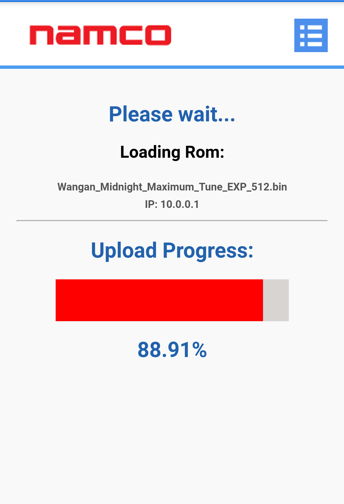

However, when I try and load it from a web browser, no game will load.
The ipad is successfully connected to the "naomi" wireless and I can see games when browsing a web page gg.com for example, but the moment I click on the game, the naomi system is just in a "checking network" state and the webpage just appears to be "loading" a page.
