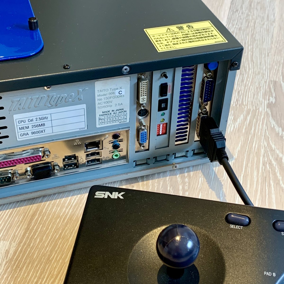

@jj1929 looks like your TTX has seen a model number upgrade with that label. My 006C has a sticker with the C on it as well…
Ah, yes you're right. Would it be more reliable to check the actual boards to find out the model?

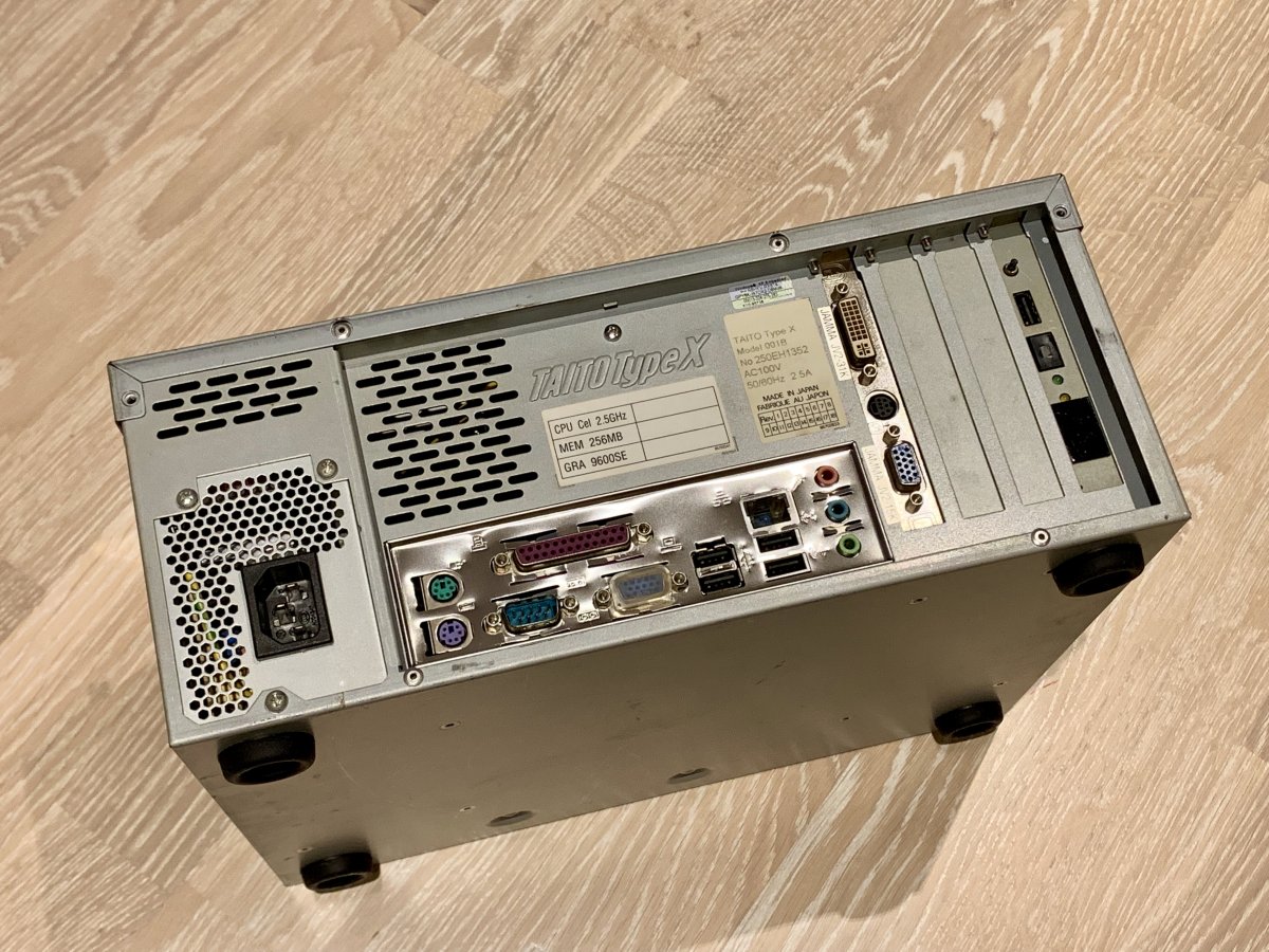

I will say I've noticed that between the Type X and Type X+ the revision on the mobo is different (same model number, but different revision). Given how similarly specced all of the different Type X models are I'm guessing there are other differences beyond CPU, GPU, and RAM

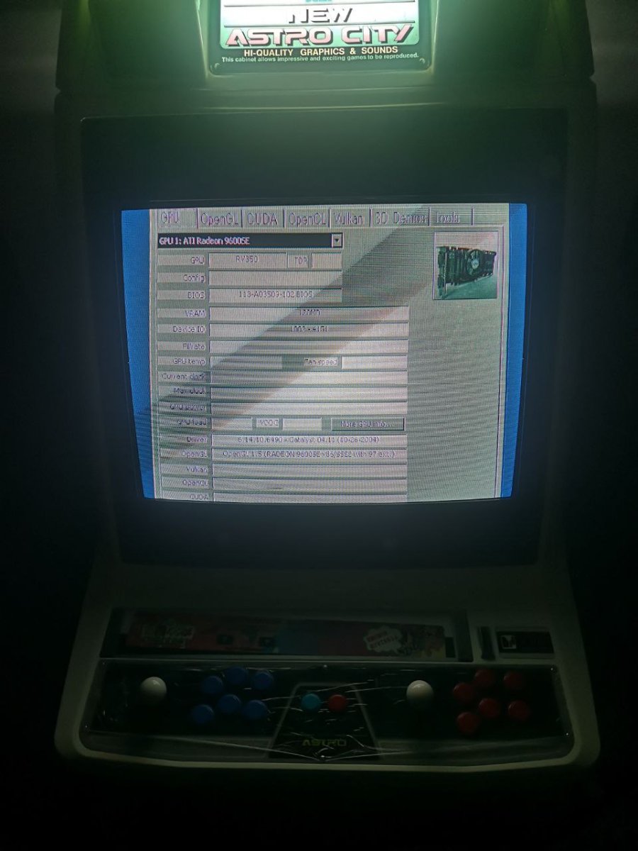

I think we need to find out which version of the GPU BIOS you have @AlxUnderBase .
Anyone here aware of a simple tool which can show GPU info and runs on winxp ?
I tried that, the new version is an installer so I tried version: 0.4.6 and it just hangs on the TTX.
edit: 0.4.6 tries to check for update which is maybe why it is hanging.
Well that took a lot longer than I anticipated :)
https://we.tl/t-h3IaZevB9p
  • Unpack the archive above to the root directory of your game partition i.e. : TTXMulti[Games]
  • Connect it to your TTX and power on
  • You should now have a game called: _gpu_test_
  • Start _gpu_test_ and take a picture
Here is mine:
My gpu bios is : 113-A03509-102 BIOS
I would appreciate it if other people could do the same thing on their setups and report their versions.
The version in @AlxUnderBase's card is very different from mine.

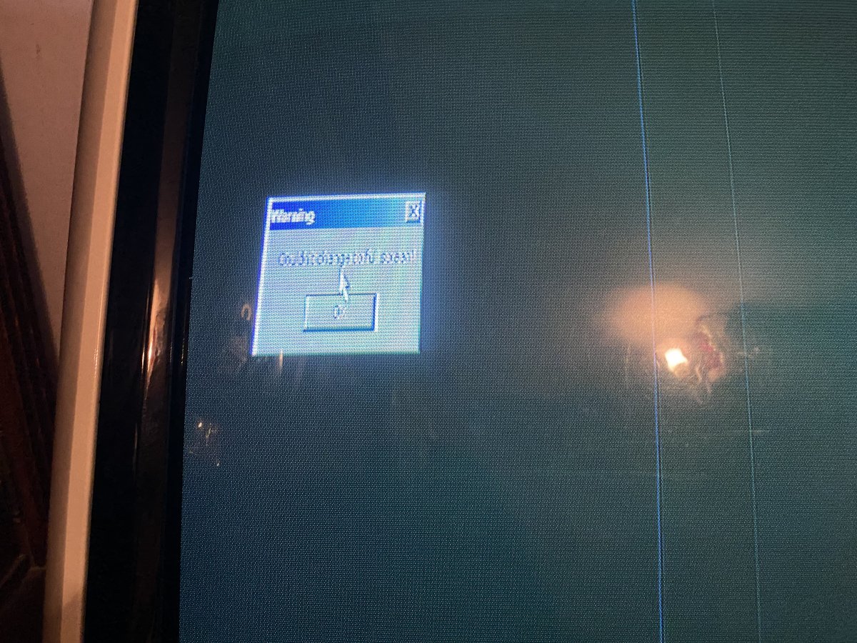

I'm struggling to get a clear photo on my PVM but my GPU BIOS is:
BK-ATI VER008.017D.032.000
