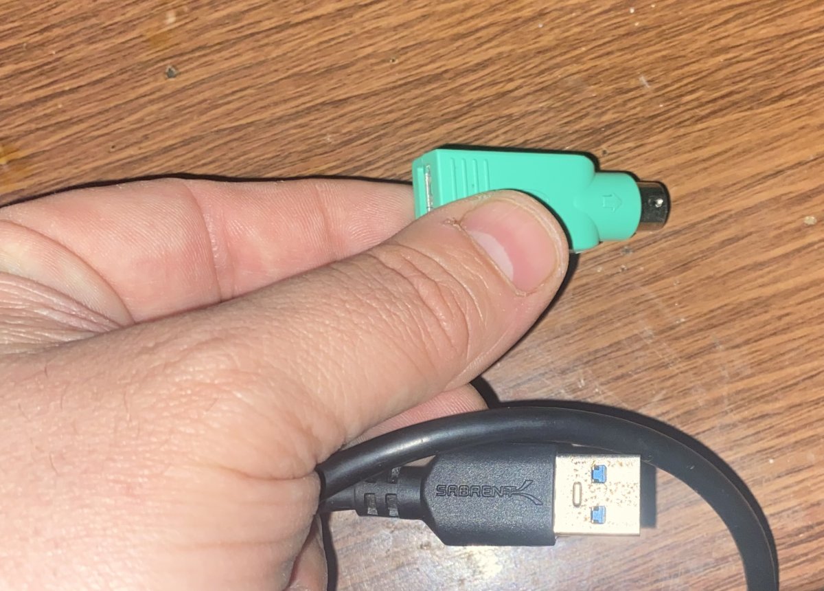

  • Insert original PS2 keyboard. A USB to PS2 adapter will NOT work.

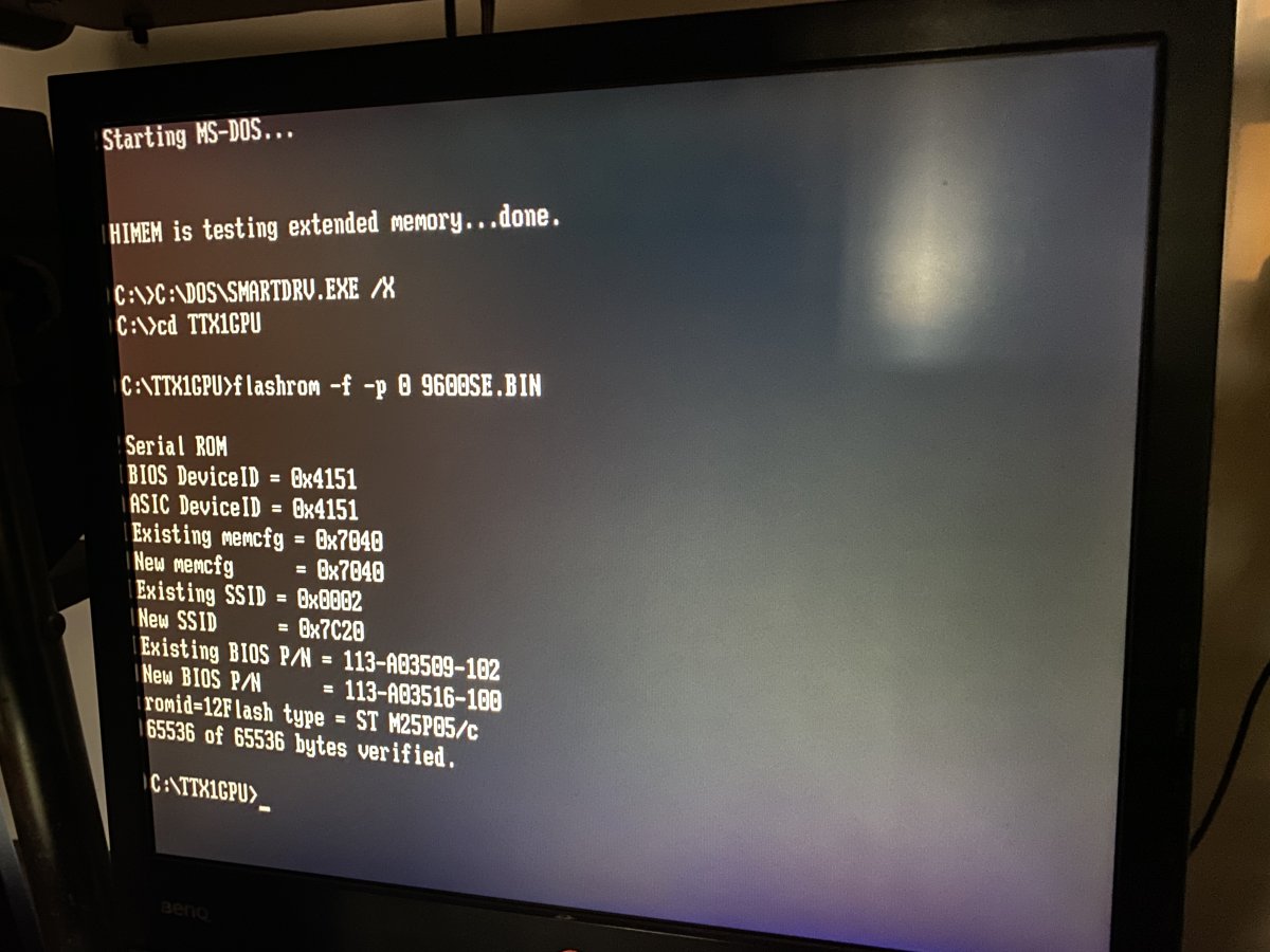

  • cd TTX1GPU

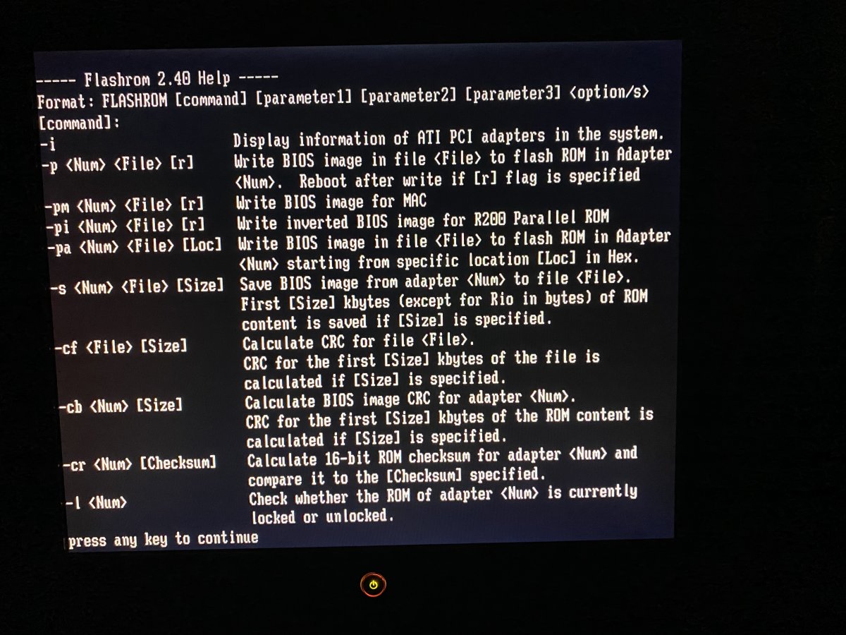

info:
flashrom -i
save:

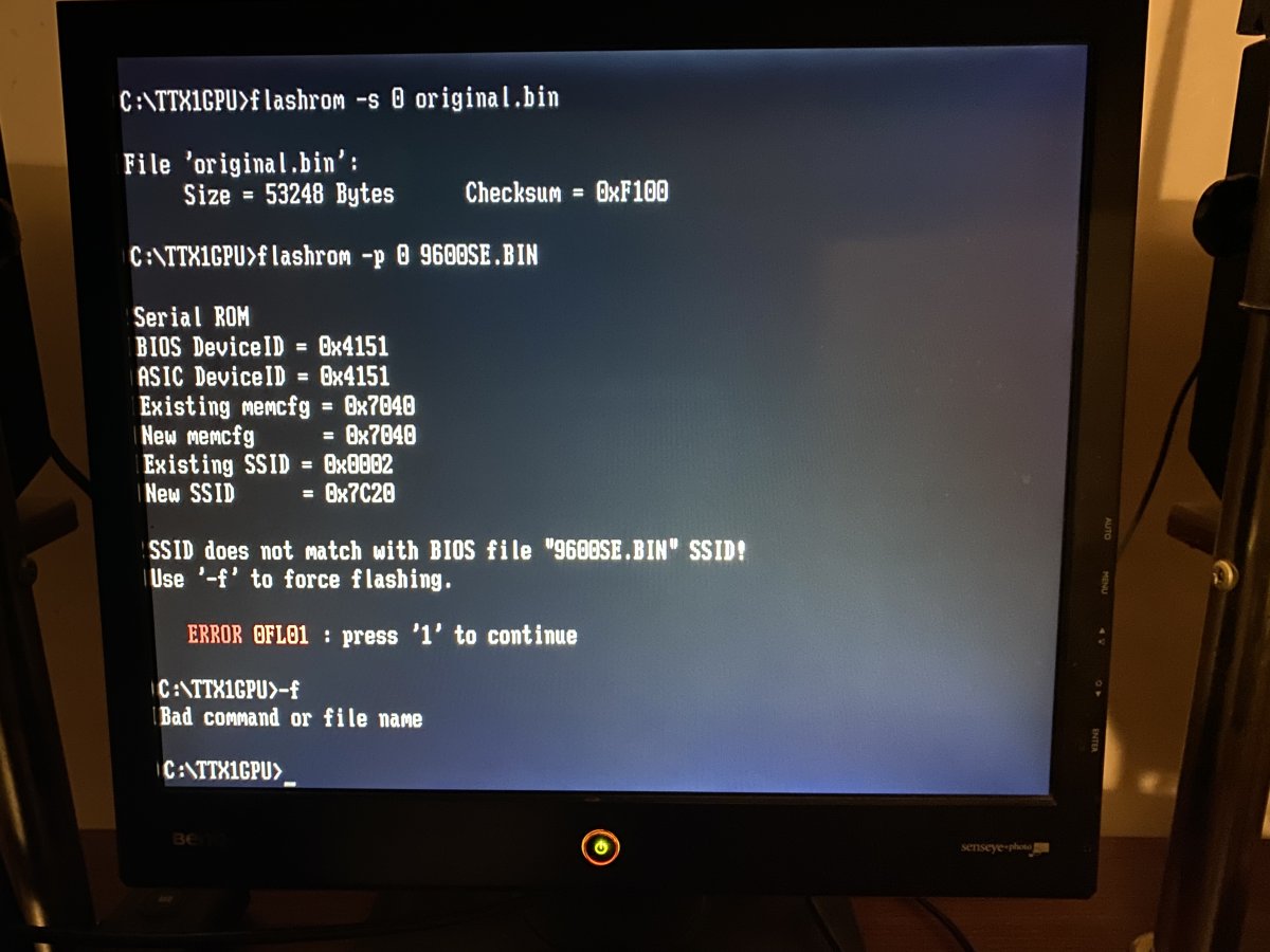

flashrom -s 0 original.bin
write:
flashrom -f -p 0 9600SE.BIN

Im almost ready . Hope tomorrow to find a proper way to test it 🙏🏻 Ive tried with an adapter usb to ps2 but is not working

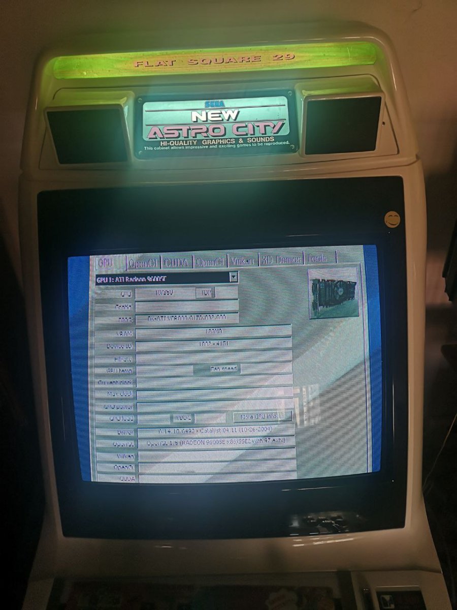

I dont know if i did something wrong or i missed something 😊
ps : orginal bios of my ATI 9600 gpu is hosted here ( https://we.tl/t-M6GVlvYMS4 ) - flashrom-s 0 original.bin i suppose did this file :happy:
@rtw : now remains to fix the menu . Games working amazing after loading each of them
View: https://youtube.com/shorts/h5xCHel7Bms?feature=share

@AlxUnderBase Nice to see you have it working somewhat. You should redo the operation with the command:
Then when that is done reboot and save the image to verify that it is the same as 9600SE.BIN.
And post it here. Just zip it up and attach it to the post, it is tiny.

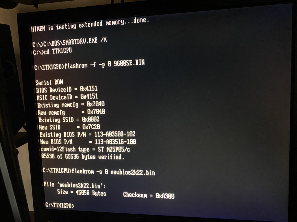

@rtw : all went great with some nice sounds from MS Dos after flashing the bios . Now all games working amazing✌🏻
Thanks @rtw & @Niko 🙏🏻
New resulted bios is here : https://we.tl/t-CFOkoEXhp3

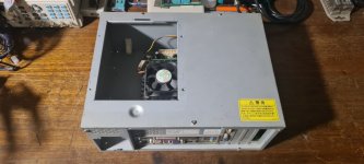

I misread or misunderstood, because I thought that the downloadable file was an image on the hard drive and they are just files that are copied to the hard drive since unfortunately I do not have any original hard drive with the operating system included to test it on my TTX :(
Looks like you are missing a PSU unit as well :)
Everything is there, read the instructions carefully... ;)
I read the entire thread but nothing. I can't find it, I only find the software that is copied to the TTX system OS but I can't find an image (.img) of the TTX OS, so what I am looking for is something similar to what Niko has (an OS image) . I do not have any original image of the OS since the hard drive that came with the TTX is totally dead 😓
