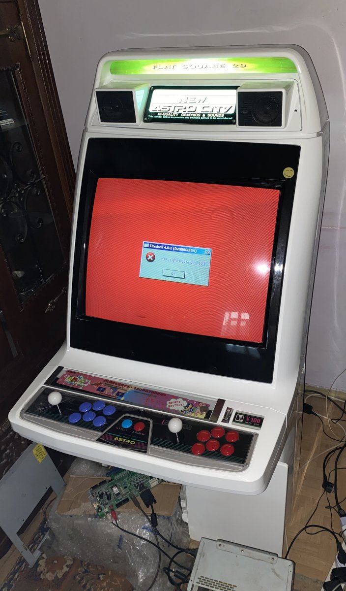

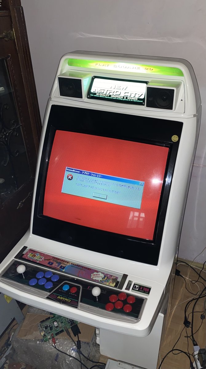

@rtw ... anyway, i was received 2 new messages . in the txt i didnt seen something to be logged . anyway , i did pictures to be sure (i know isnt relevant but just to show you) .
ps : nevermind ... "ttxshell.txt." doesnt register logs . i did " ttxshell " and now we have some logs . i will test again and hope we will get that messages from pictures attached here

What is the error message being shown from ttxshell displayed in your last picture ?
The malformed packet is interesting. What kind of IO are you using ?
Have you seen the malformed packet error before ?
I checked all logs and there are no errors logged. Did you enable logging before or after you got the malformed packet error ?

Logged was before after i figure it out the making txt file ive tried first “ ttxshell.txt. “ and then ive seen nothing in this and ive made “ ttxshell “ txt file and keept both and boot to see if something and where is logs writed and in “ ttxshell.txt. “ was nothing , but in “ ttxshell” txt was the logs . So … all logs are new from after ive figure it out .
Im using the chinesse IO because is handy and much near to my hands than taito io who i keep in the closet :D
That was the first time ive received that message “malfunction … “
Thank you for the information. The error means that your Chinese IO replied with a very strange size of a JVS packet. I might add some debug info to that later.

If it'll help, I'm happy to translate the Japanese error message. Just need a clearer image of the error window.
Can't quite make out some of the kanji in the photo, but I believe it's saying it can't read from some of the memory addresses listed. Program has. shut down, click on to exit
Dunno if that helps or not
