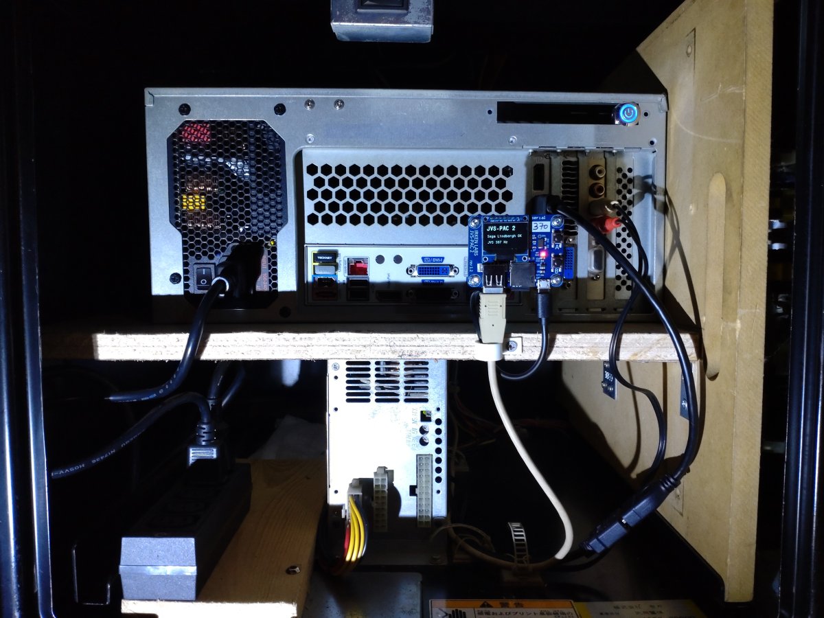

I've settle on a hybrid floating design for the JVS-PAC 2 as I'm quite clumsy & don't won't to catch the wires & damage the connectors.
"Cools" from AO passed by yesterday after collecting a new cab locally to me & to my surprise hadn't seen the new pac in person before.
