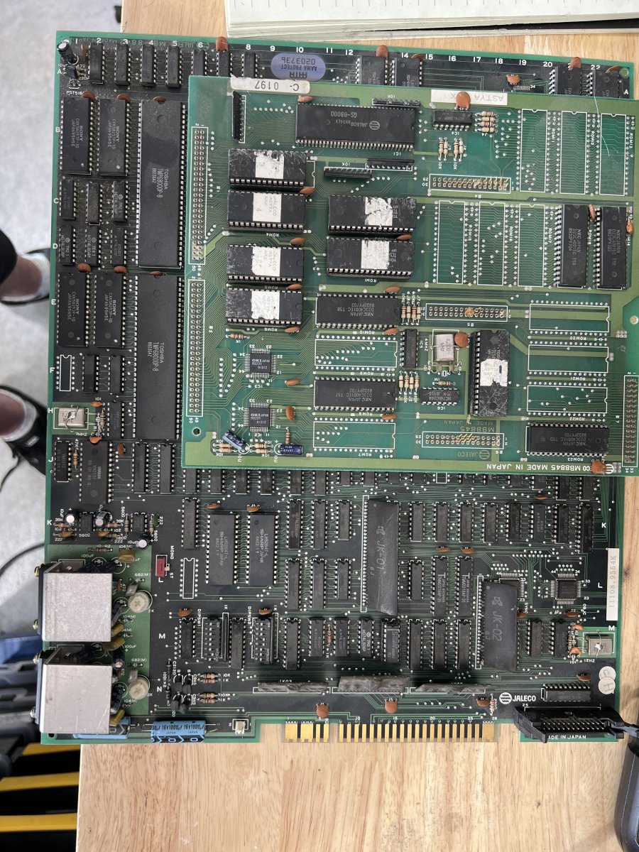

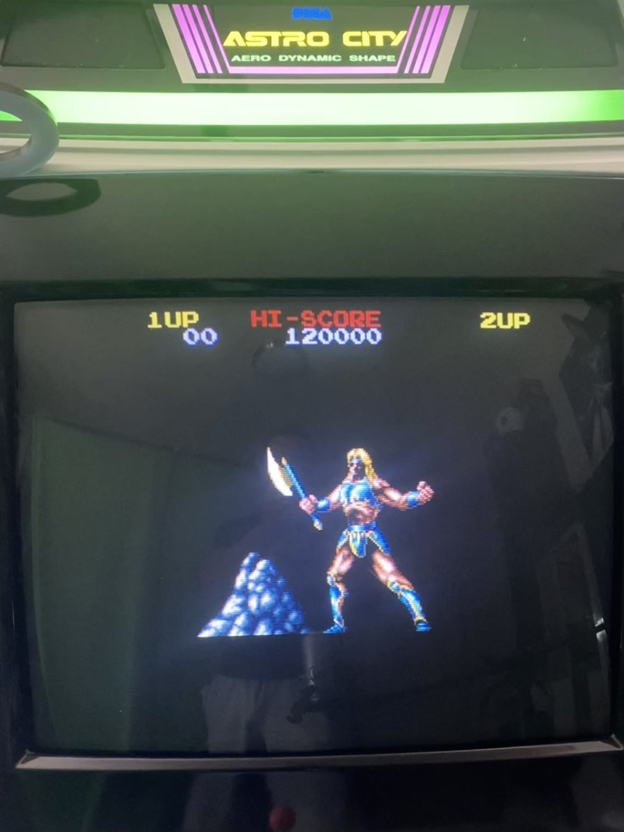

@Hammy any idea what is causing this? I'm hoping it's a ROM board issue so I can use the motherboard with the multi.

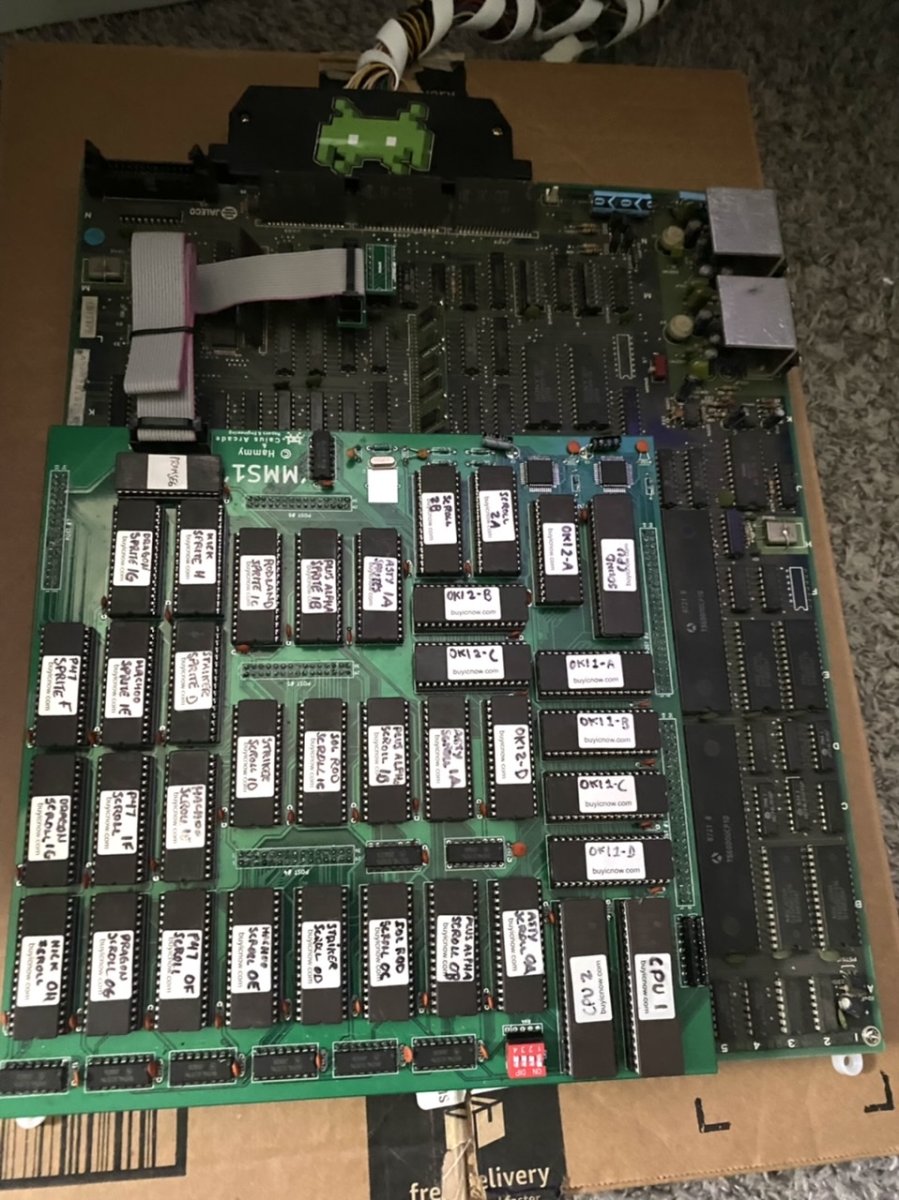

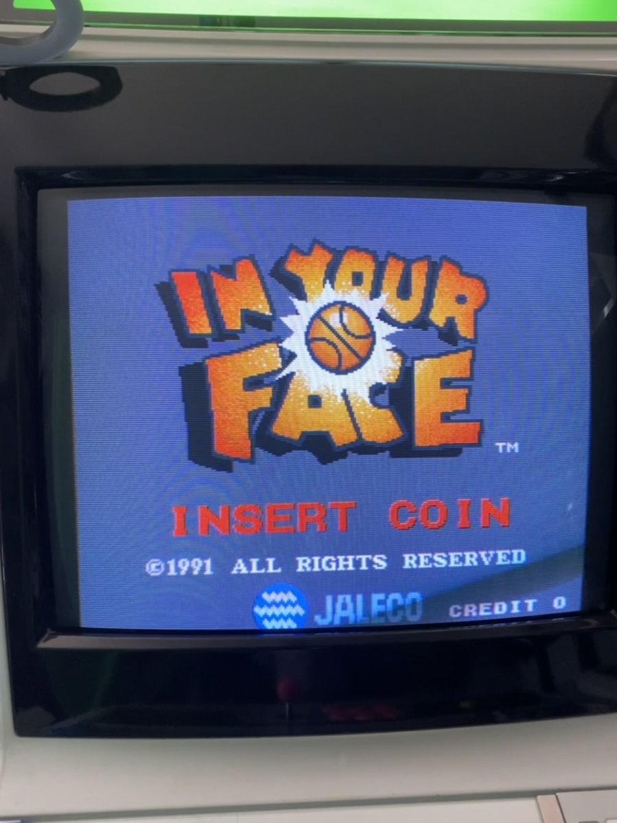

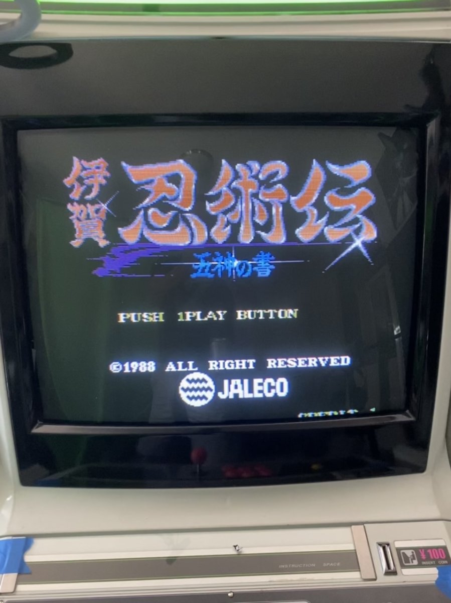

Big thanks to @Hammy for the awesome multi, and tech support. I had a couple bumps along the way but we were able to narrow it down to some bad programmed chips (more on that later).
As well as @twistedsymphony for the eprom burning advice. This was the first time I tried burning my own eproms, with a TL866ii-plus. For the most part it all worked out, except I was having trouble burning the SOUND eprom (27c322), and the PROMSEG (27c512). Thanks to @ShootTheCore for helping me with the SOUND eprom, as for the PROMSEG, I had to lower my VPP Voltage to 12.5 to get it to successfully program.
The result, working Jaleco multi!

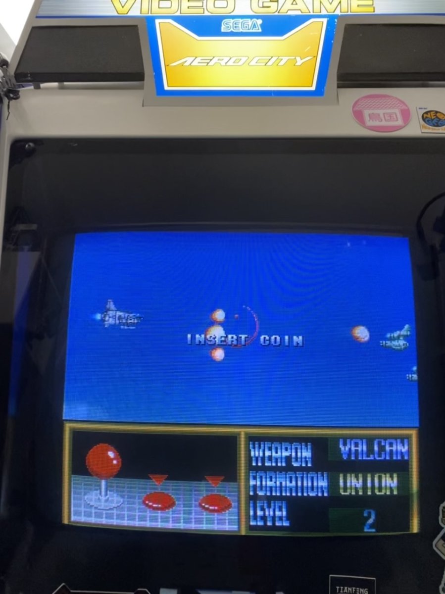

This is running on a P-47 board that I got for $100 shipped. Not overclocked.
Honestly I'm anticipating this one more than CPS1. Maybe because it's a system I've never owned a single board of, though I've played quite a bit of the more well known STGs emulated.

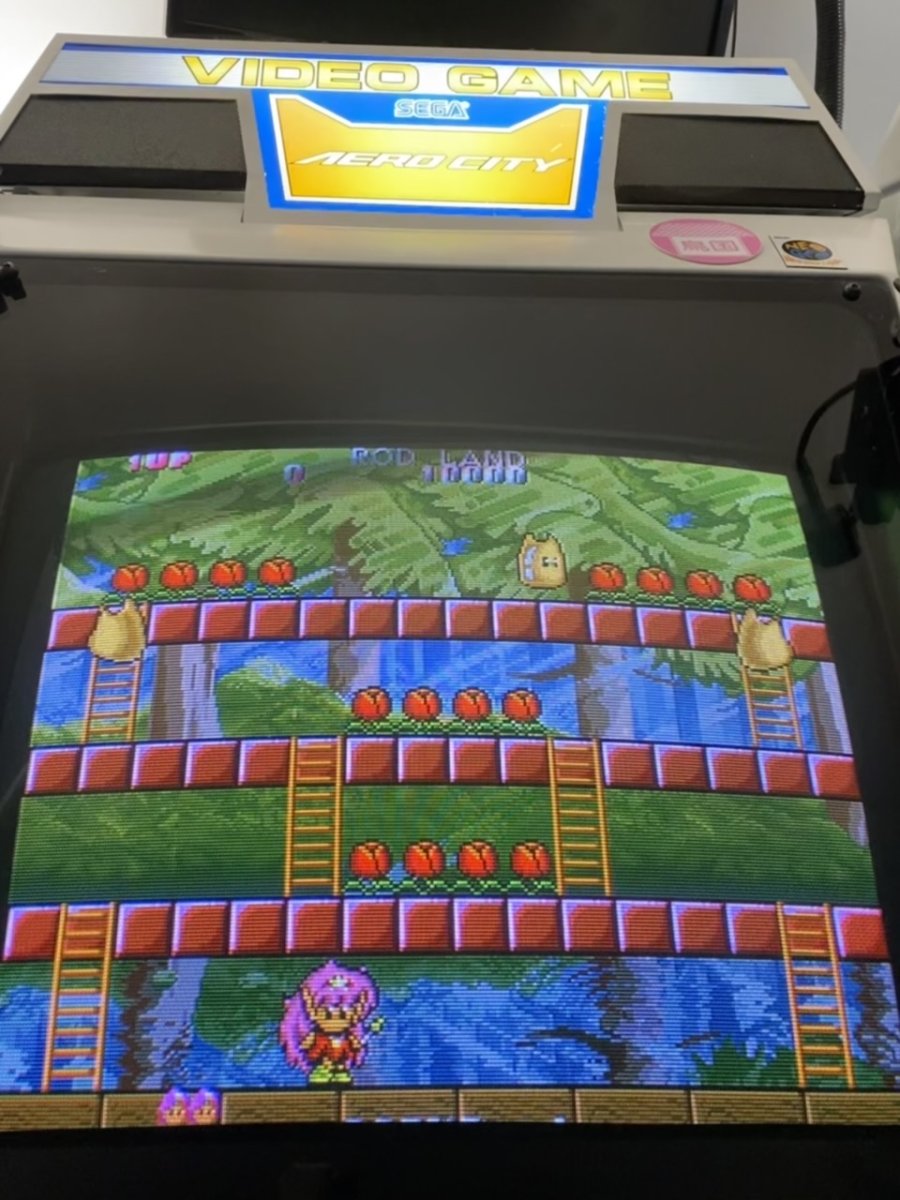

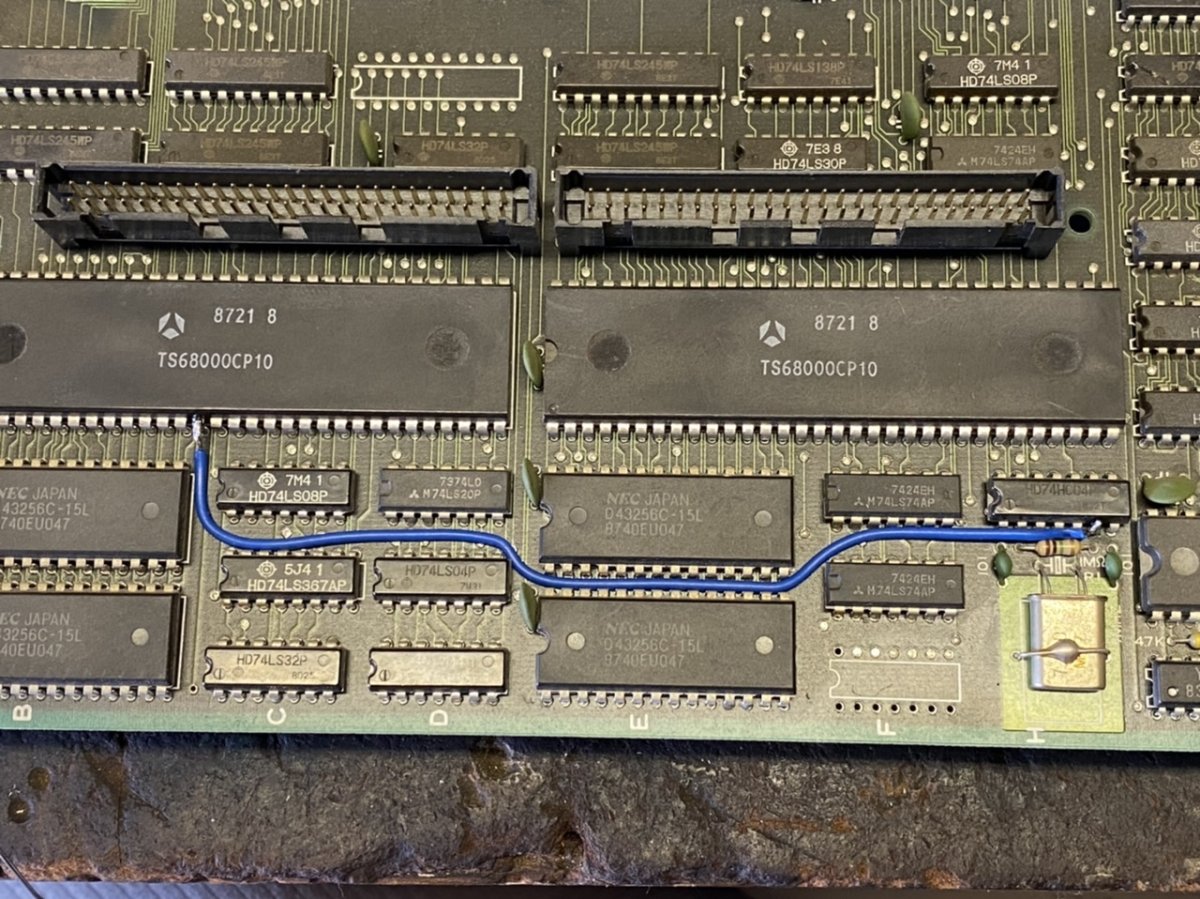

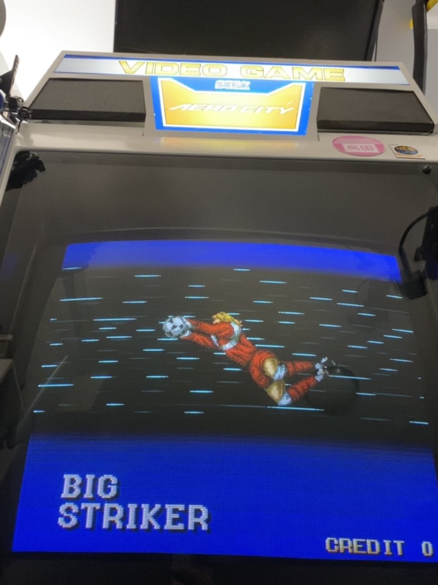

I just did the easy 7mhz overclock on my board.

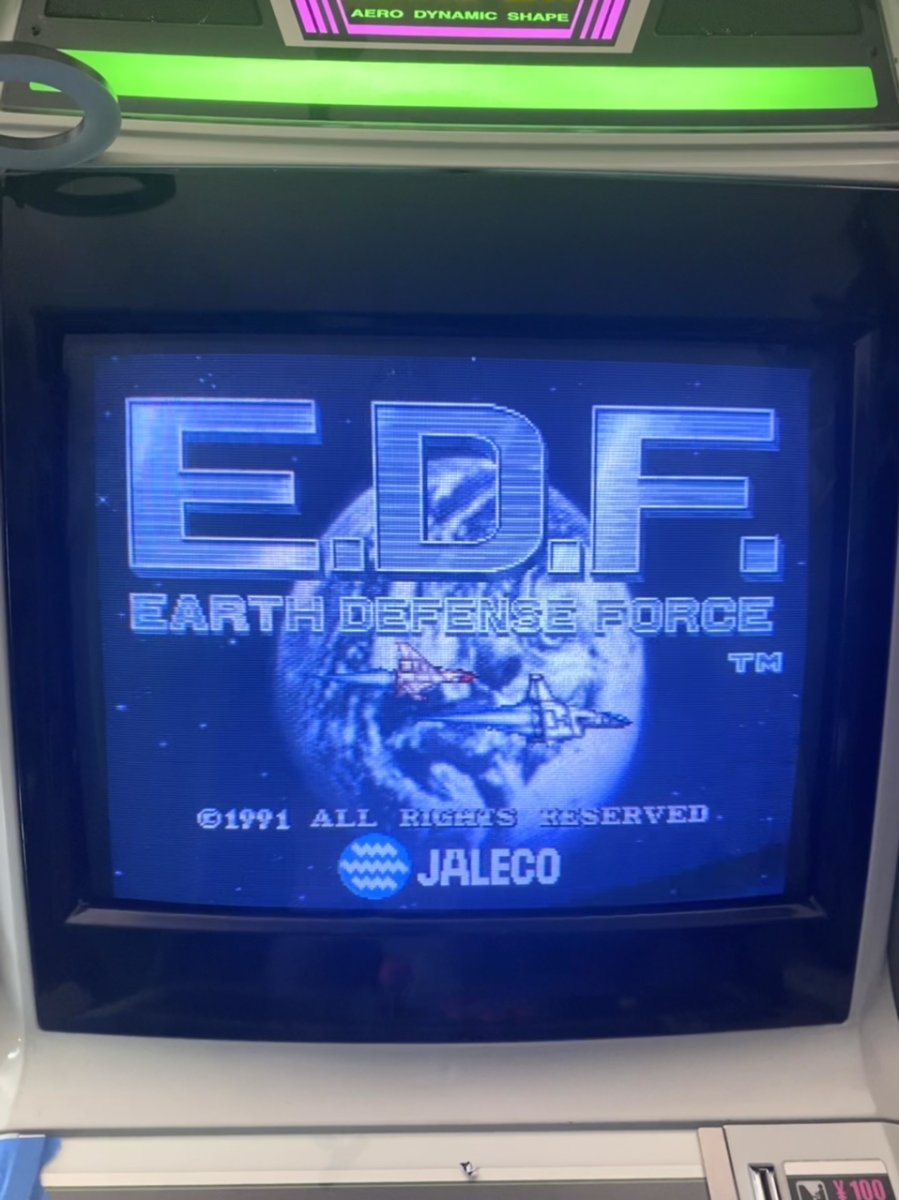

I got a little bit of improvement on some games. Big Striker works now, although slow. Previously at 6mhz it was not working.
EDF still has some slowdown especially when using the laser weapon, but Rodland felt good.
Next I want to overclock to 10mhz and see if I can get EDF to reduce the slowdown.
