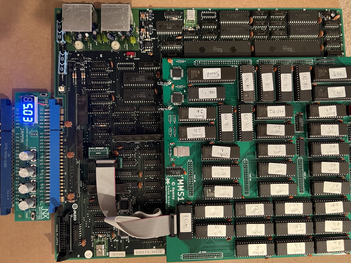

Superb! Certainly one of those days I’m glad I upgraded my rom burner ;)
I will admit I never played these games in the arcade back in the day, and I’m still not familiar with all these titles. But so far I’ve been very impressed with the library of games here — lots of fun and variety. Thanks @Hammy + @caius for another winner!!
