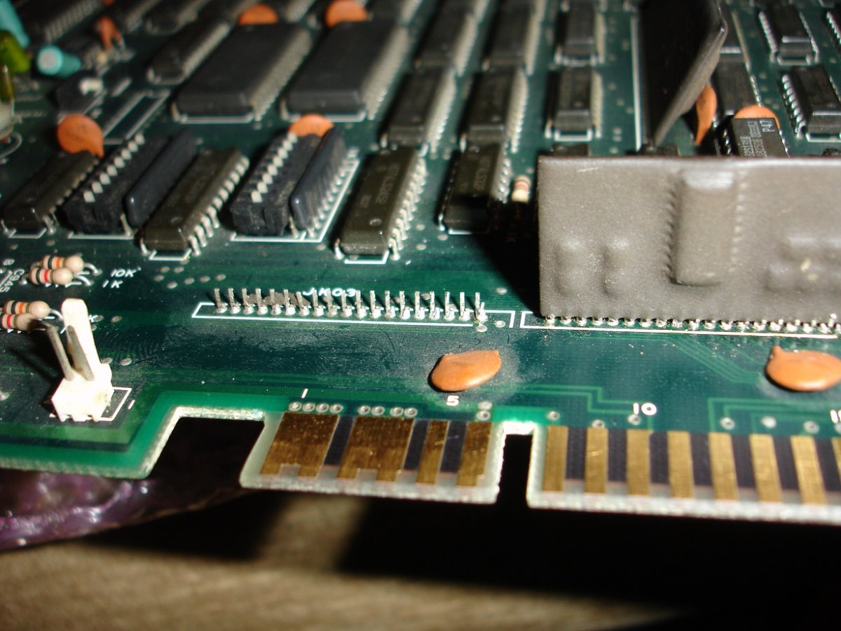

Finally got this Multi done and all IC's checksum...awesome!
THEN this happens...
TBH it was always bent over, ever since I have owned it, wear and tear has just taken it's toll! Just waiting for a Caius replacement of Hammy now
