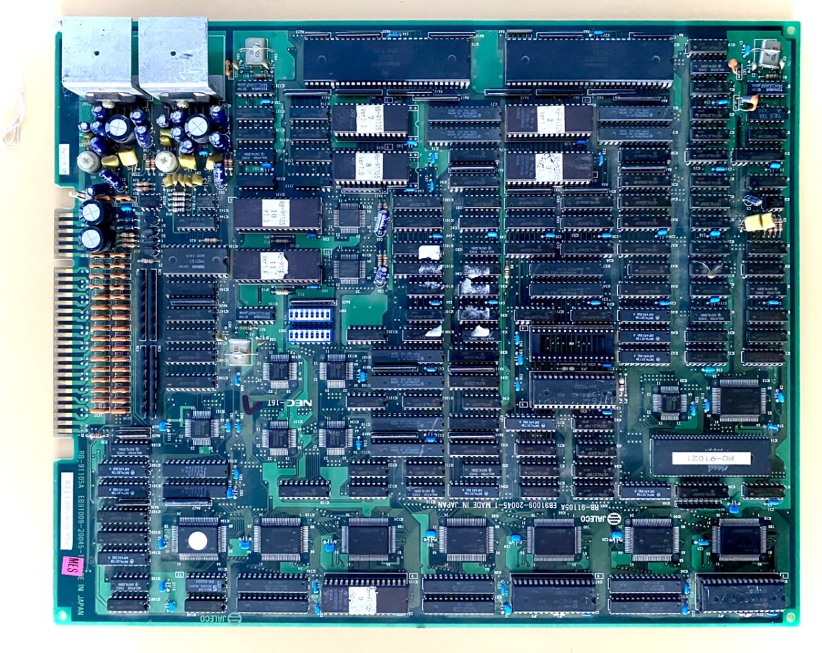

As you can see it is a 2PCB set - Standard romboard + PROM board (connected with a ribbon)
Very easy to install, the same as a regular game. (Hammy said "regular" game when he reffered on P:47 or other TYPE "A" released title)
https://jaleco.fandom.com/wiki/Jaleco_Mega_System_1 -> for those who want a donor , "TYPE A" released titles are the donors you're looking for !
@Brakvader
If you want to use BIG Striker , Cybattler (these are TYPE C) , etc. or other than "TYPE A" as donor , you simply cant . You don't have where to connect the Multi board . I have in my collection (look here) this title and isnt good donor for multi !
BIG STRIKER = NO GOOD DONOR "Type C" looks like this
GOOD DONOR : "Type A" released titles looks like this

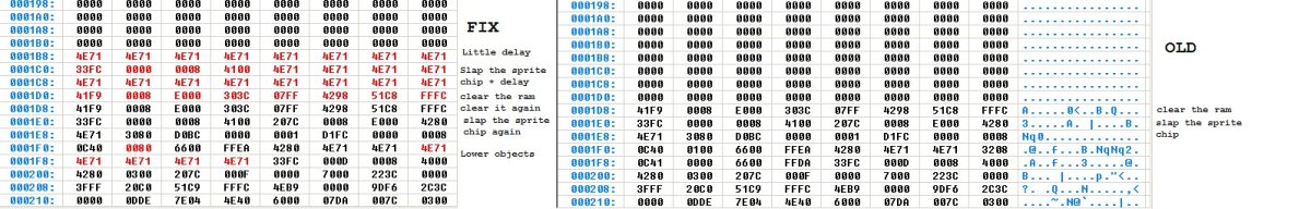

Re- added the full objects (nops / 4e71's after the red "80" not required / put back to normal) and there's no flickering sprites at all.
Very happy to get to the bottom of this one :)
Basically it needed a slap each time BEFORE a sprite ram operation happens, the object number was not the problem in the end.
I guess the double clear could be reduced to a single clear now but the extra nanoseconds of boot time can stay as a reminder of the bad times. ;)
