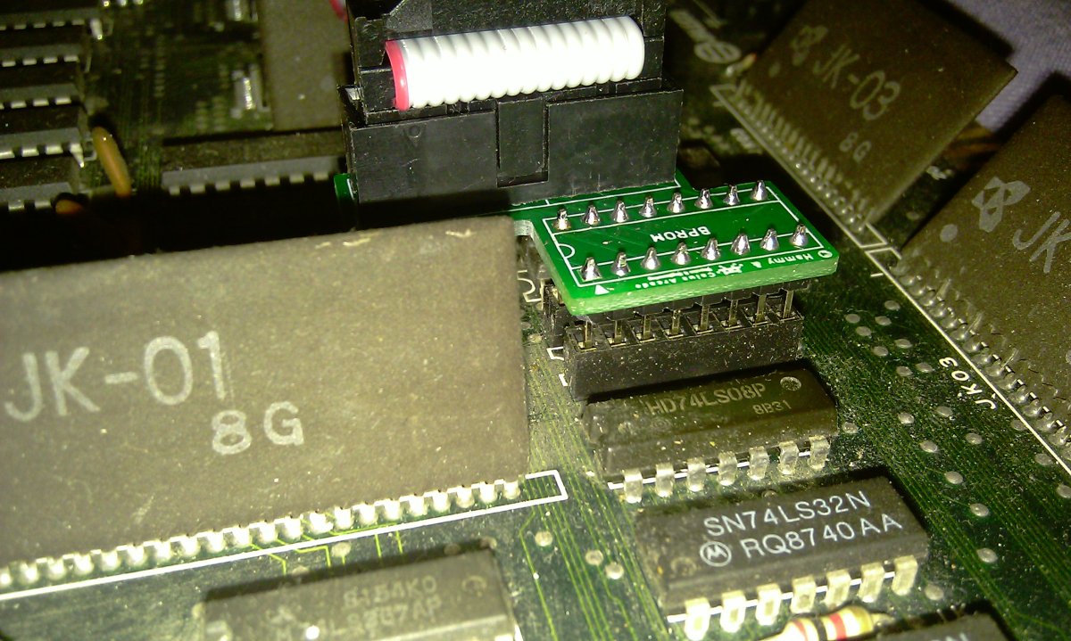

I'm looking for a little installation help -- everything is programmed except SOUNDCPU32. The only file I didn't use was "PROMSEGMAUL". Is that what I should program to this EPROM?
And the 28 pin socket -- is this the EEPROM on the little sub-board from the original mobo?
I feel like I've read this thread 3 times for various reasons, so, apologies if this has been answered already.
Soundcpu322 is the sound program, it goes in the SOUNDCPU 42pin socket near Post 2
Promsegmaul goes onto a 27c256 rom and fits in the 28pin socket
The ribbon connector should be keyed, the security chip on the motherboard near the JK02 needs to be removed and the prom board fitted into this socket.
