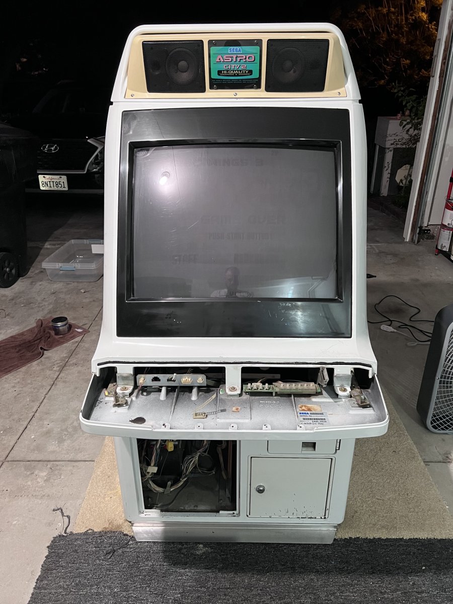

I managed to pull the monitor out myself without a helper. Pretty proud of myself. I did forget one cable I had to disconnect so I had to pull that out and not drop the monitor. Luckily I succeeded.
Looks like other parts of the loom are patchy and cut up a little too.
Think a repair is definitely in order. Maybe a nice clean too for the wiring. But I think I’d rather pay for a pro to do that.

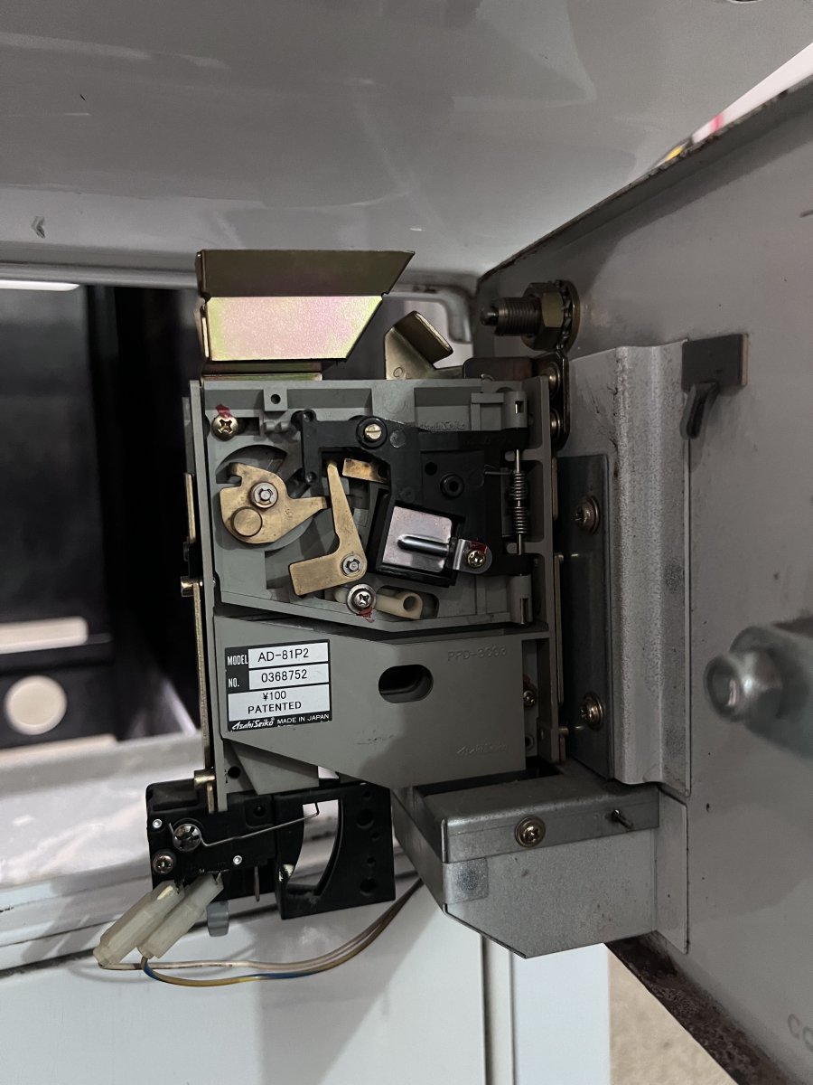

Ewww. Non Japanese coin mech
Worst part was the coin chute was super jammed with nickles, quarters, pennies, straw wrappers. I struggled becuase I tried to clear the jam with it still in the machine at first.
I was getting pretty frustrated.
I took it out and put soapy water in it and continued using a flathead screwdriver to pry it apart a little and then finally all that change came flying out.
Luckily I found a spare one in my OG Astro. Wasn’t sure how to replace but figured it out. Was a very satisfying upgrade. Looks way better in my opinion and didn’t have to anything to make it accept yen.

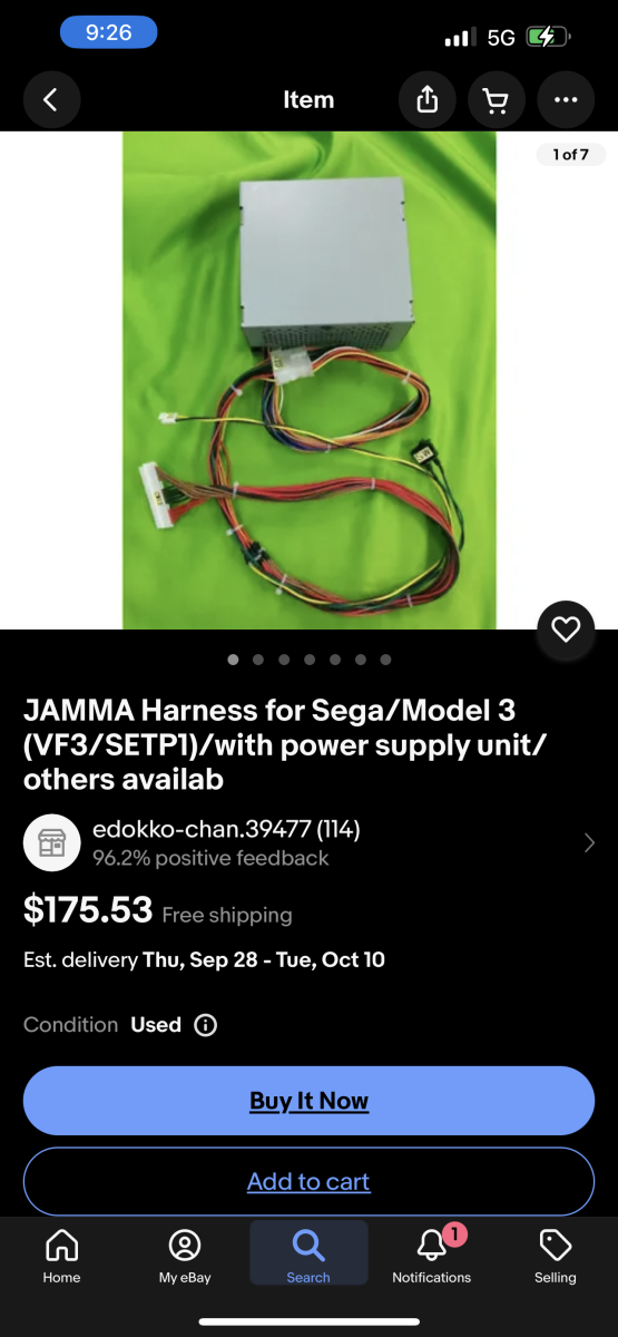

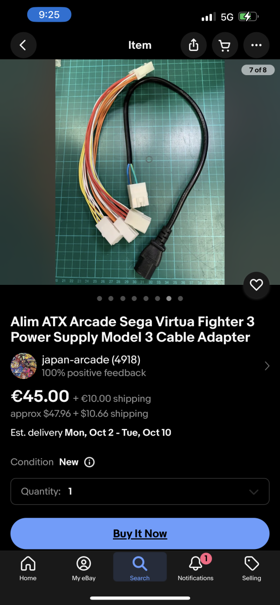

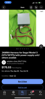

Would either of these solutions work?

I have no idea what the Japan-arcade harness is for.
The Edokko-chan one could work. The problem is it's using a PC PSU. Those don't have user adjustable voltages. That can be hit or miss with arcade hardware.
Mean Well QP-150-3A is the PSU I normally recommend, but you would need to make the harness for it yourself or ask someone like @Lemony Vengeance to make one for you.
