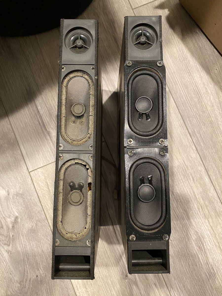

I ended up doing the repair (I know I installed the 3d printed brackets incorrectly, sue me). It sounds “alright”. I felt the original ones were a bit punchier. However, the highs are still cracking when playing 3s. I’m assuming the tweeters need replacing. However, I haven’t seen any replacements for the tweeters on this thread. Anyone else tried to replace those as well?

Alberto hooked me up with these replacement speakers
Will these be pretty plug-and-play? Any idea if I'll have to add any magnetic shielding like @Thomas did here? Should I replace the tweeters too, and if so, what are the best replacements?

Those are shielded so the metal plate will not be necessary however i think the original speakers are 4 ohm wired in series so some modification will be necessary
Yeah, looks like the originals were 4, so 8 ohms total with 2 wired in series. I could get 16 ohms with these in series, or 4 in parallel. It should be safe to wire these in in series, right? A bit quieter, but it shouldn't damage the amp or anything. I assume it'd be fine since he sold me these for the Blast specifically.
There's no risk damaging the amp if wired as 16 ohms but there is a risk of damage if wired at 4 ohms if the amp wasn't designed to go that low.

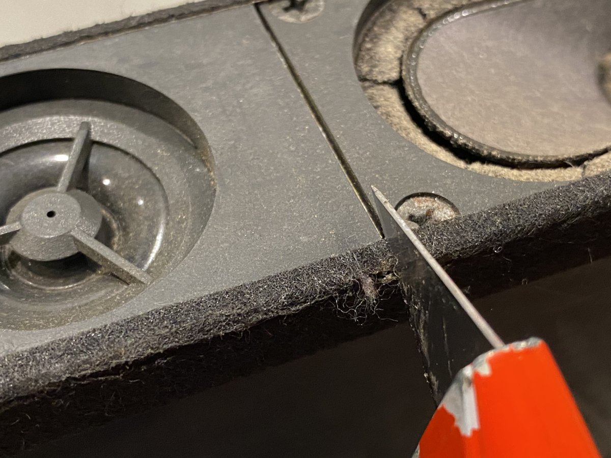

How do you get the speaker boxes out? I've removed my monitor, then I unscrewed the two screws connecting the two brackets to the cab. The speaker box doesn't seem to budge though.
