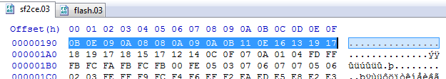

For Neocps1 release, if you want to change the region open rom 03.
Go to 00000190
00 Japan
02 USA
04 ETC

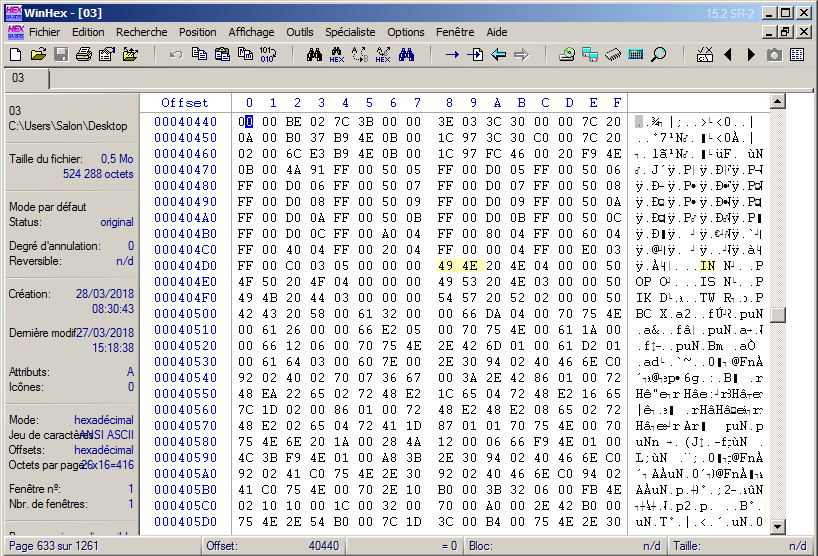

Mikejmoffitt Sf2HF region :
Go to 00040440 on rom 03
00 Japan
02 USA
04 ETC
Sorry if I'm being thick, but I can't see where to make the modification. ?(
I'd be expecting to see a 02 somewhere in the line for neo's release as it's US, that could be changed to 00 or 04 to change region.
Likewise, a 00 in mike's release as it's Japan that could be change if required.

Modification for SF2CE (Neocps1 release) and SF2HF (Mikejmoffitt release) is on rom 03 for B-board version, not the ready version for the multi-cps2.

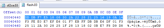

Open flash.02(Mikejmoffitt release) go to 40440 and look picture attached :)
For neo release, it's the same i think.
