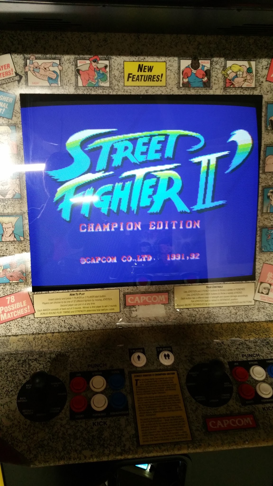

My only gripes are, cant set the dips in SF2CE and the landing from jump sound is playing the hit fighter landing sound (at least with Blanka)
Not deal breakers. Paypal en route.
^ Dedicated Multi-CPS2 in a Dynamo cab is absolutely fantastic!
