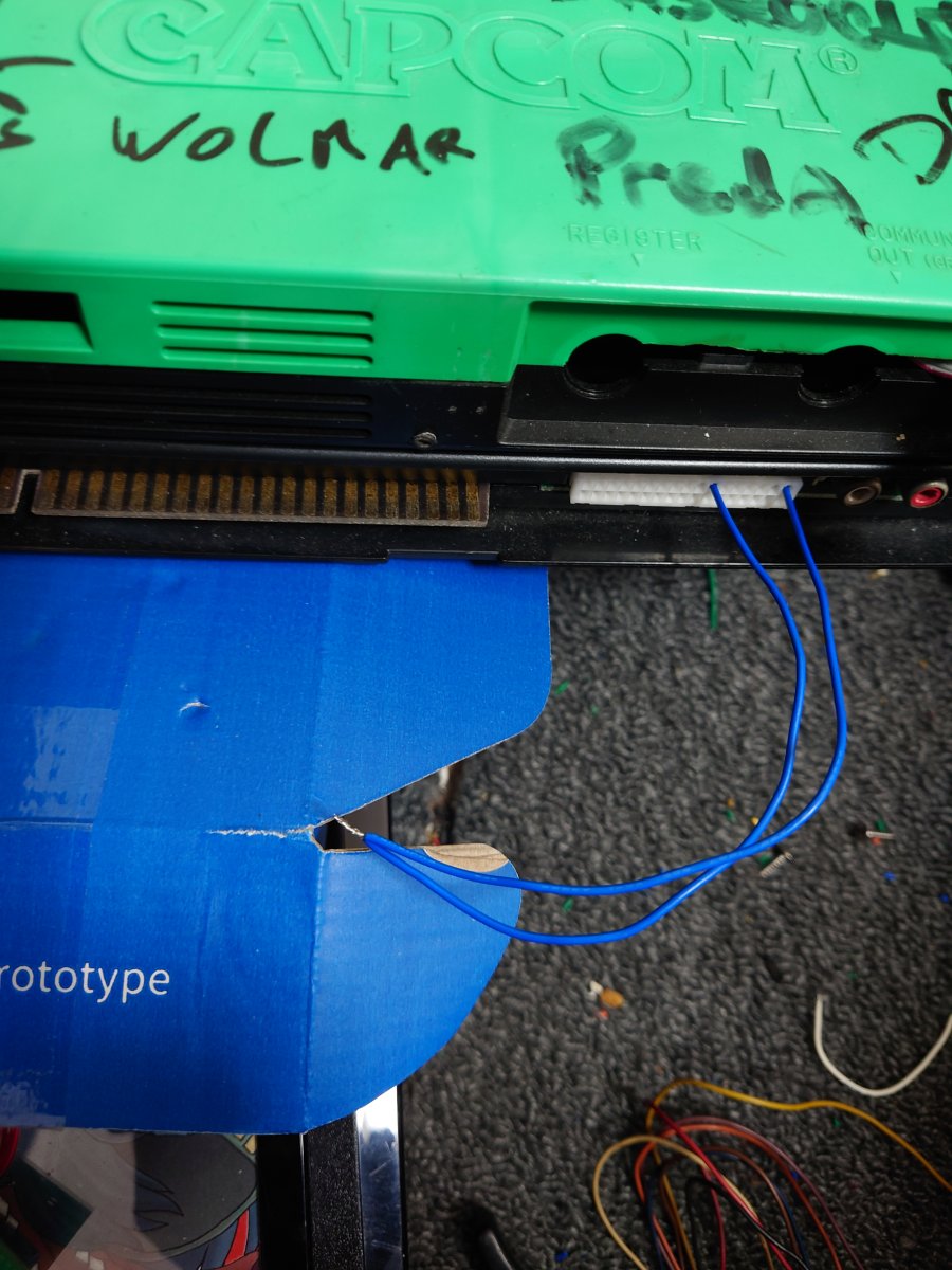

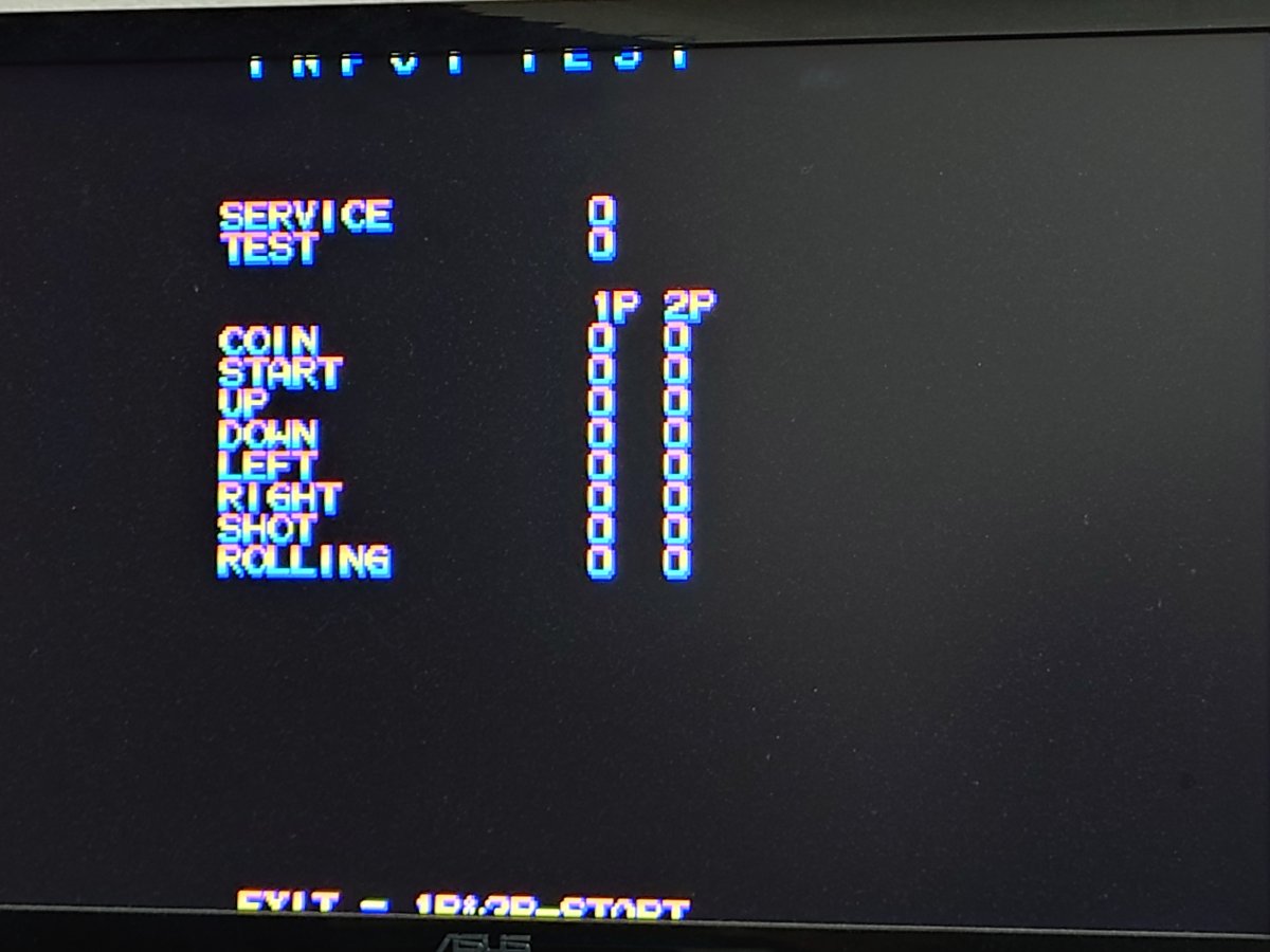

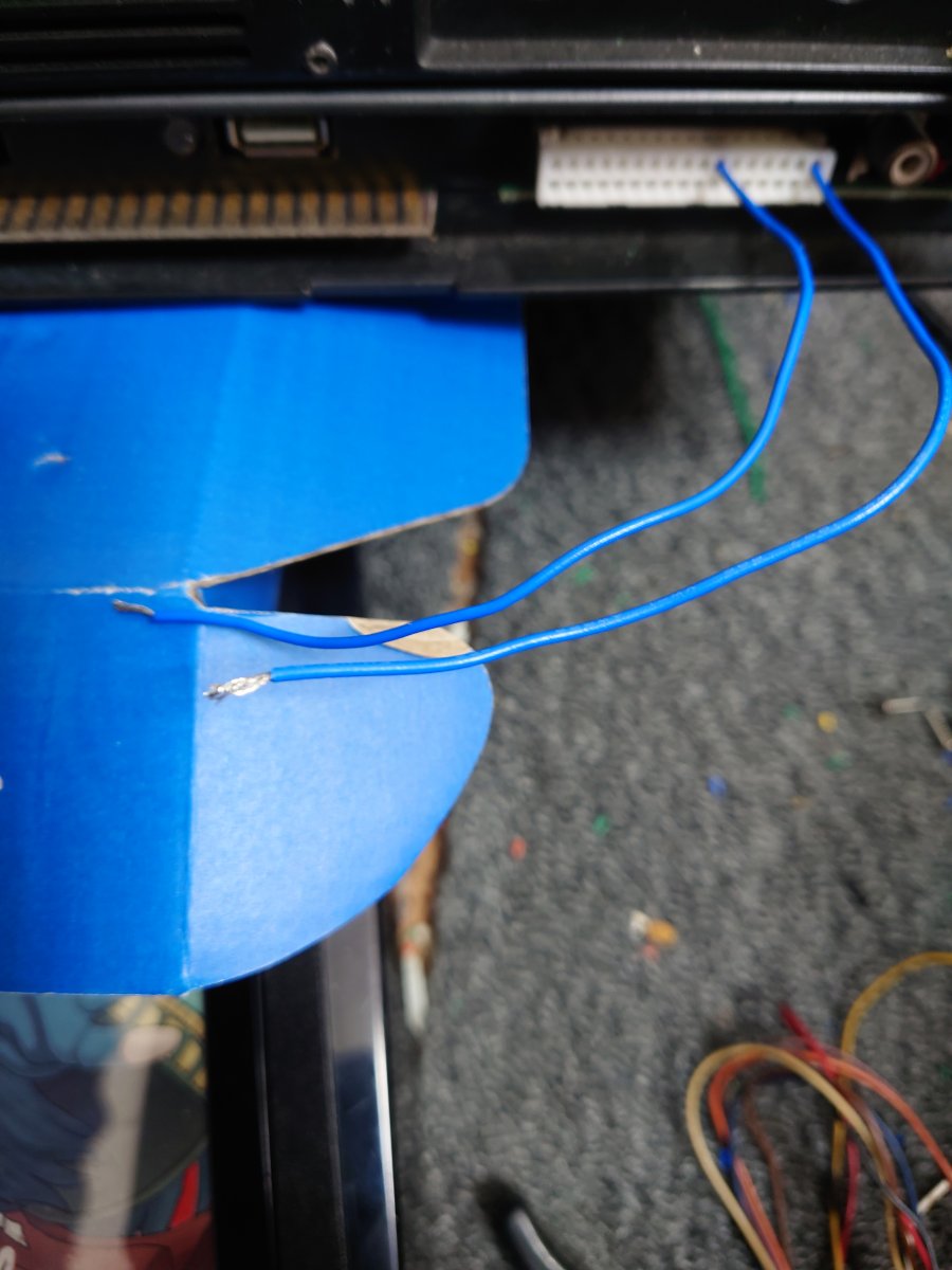

Shorting #21 of the 34-pin expansion connector to GND will put it into rolling switch mode.

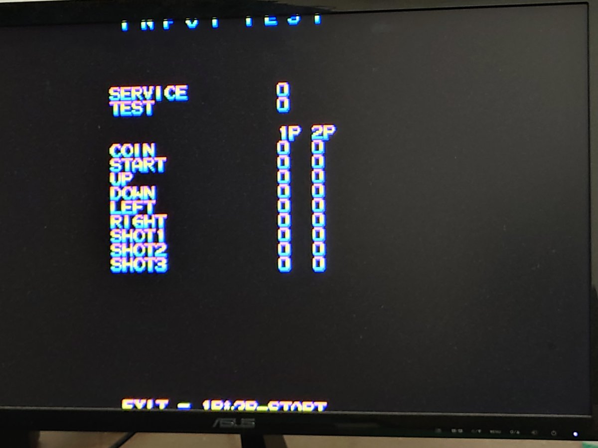

By the way, this is what happens when you plug in the puzzloop2 I/O.
It looks like you can't operate levers, etc. unless you disconnect the input side and connect it directly.
At this point, the spinner is recognized, but I don't know if it's working properly. I don't have a spinner.
