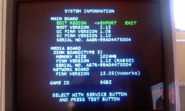

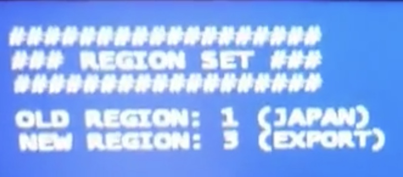

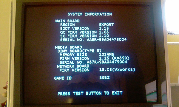

I can get the Game ID change after 15 pushes, but adding 30 more does nothing, I don't get the option to edit the Region. I've not double checked the PIC in this Chihiro, but does it *have* to be a netboot pic specifically for this Region edit to work? I think this one was using a random PIC just to get past the startup requirement, but remained tethered otherwise. Is that perhaps my issue?

Yes, I seem to remember you need a netboot pic. Otherwise the edit region like in your chihiro3.jpg will not appear.
