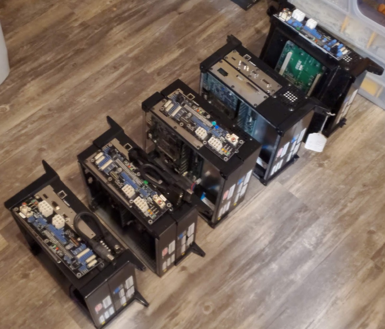

ha! that makes since :) I just updated a bunch of chihiro's .. just waiting for some supercaps to come in for the baseboards.
