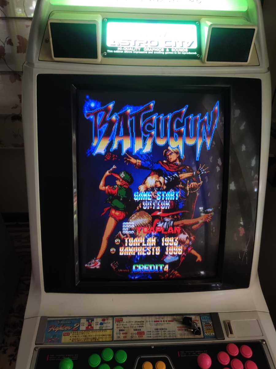

I own both JAMMAizer & SCART2ARC3 and have used both for over 2 years now and can speak on the merits of both.I got tired of waiting, and bought tim worthington jamma driver.
I finally assembled it last week and it works fantastic
