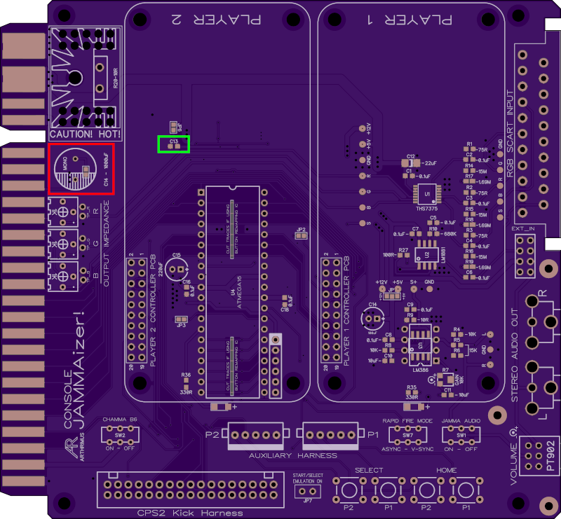

@kasaski, Do you remember what capacitor value you use for C13 (boxed in green)?
One a side note, boxed in red is a cosmetic error. C14 is listed twice. The aluminum electrolytic cap that is under the Player 1 MC PCB is also listed as C14.

I left mine unpopulated as its related to the remapping/autofire circuit and i didnt include that on mine to save some money. I assume its a 0.1uf filter cap as it looks to be on the 5v power line
I'll pull mine off circuit and check the capacitance and report back then.

Alright, so C13 measured on my Fluke meter at 115nF or 0.115uF. So it is indeed a 0.1uF 0603 capacitor that is within 20% tolerance. The bad news.......as I was reinstalling it, it pinched out of my tweezers and slingshotted itself into the ether. Never to be seen again.
Ahhh, well. I am putting together a parts order to whip up five JAMMAizers. Will just add in a few extra caps.
EDIT: Found the cap in the ether and reinstalled it. All is well with my JAMMAizer again.
