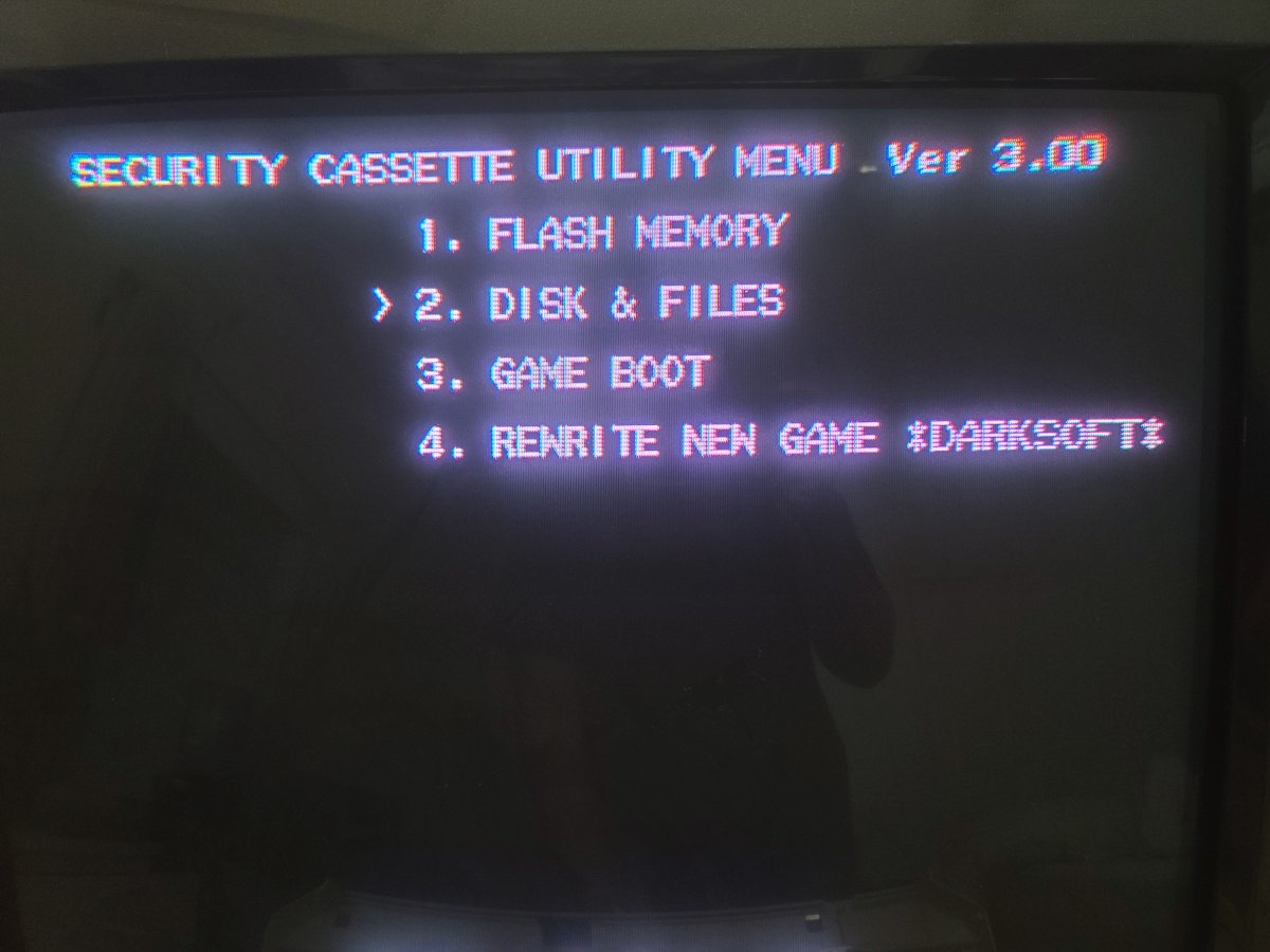

If all you want is the no BGM 3rd Strike and you have Darksoft's UltraSIMMs/UltraBIOS, you can just burn that ROM to your SIMMs. If 4rd Strike works, I see no reason this wouldn't (if anyone more knowledgeable knows this is not the case, please let me know)Hey, will there ever be a CPS III Bios CD with a NO Music mod, that can be installed on the CPS3 so one can have their own playlist on home partys but still get punch & parry sounds etc ??
the CDs and files have a simple checksums, so you will need to adjust that if you change anything.If all you want is the no BGM 3rd Strike and you have Darksoft's UltraSIMMs/UltraBIOS, you can just burn that ROM to your SIMMs. If 4rd Strike works, I see no reason this wouldn't (if anyone more knowledgeable knows this is not the case, please let me know)

Not with my BIOS.the CDs and files have a simple checksums, so you will need to adjust that if you change anything.
Sure I know of the NO BGM Rom, but that only works with emulator on FC2 and such, I would need a compatible bios that was made for no music in mind to burn on a CD also so it can install on the SIMM's, otherwise I don't see how I would change stuff.If all you want is the no BGM 3rd Strike and you have Darksoft's UltraSIMMs/UltraBIOS, you can just burn that ROM to your SIMMs. If 4rd Strike works, I see no reason this wouldn't (if anyone more knowledgeable knows this is not the case, please let me know)

The UltraBIOS should play the no bgm rom like it does with other rom hacksSure I know of the NO BGM Rom, but that only works with emulator on FC2 and such, I would need a compatible bios that was made for no music in mind to burn on a CD also so it can install on the SIMM's, otherwise I don't see how I would change stuff.
but as Mr.Darksoft said "Not with my BIOS" are there alternative UltraBIOS for CPS3?The UltraBIOS should play the no bgm rom like it does with other rom hacks

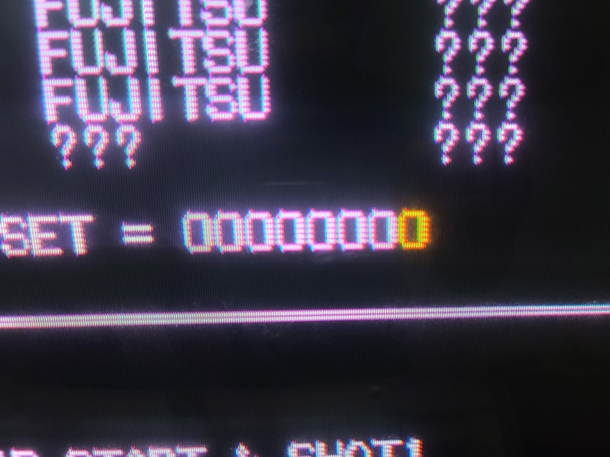

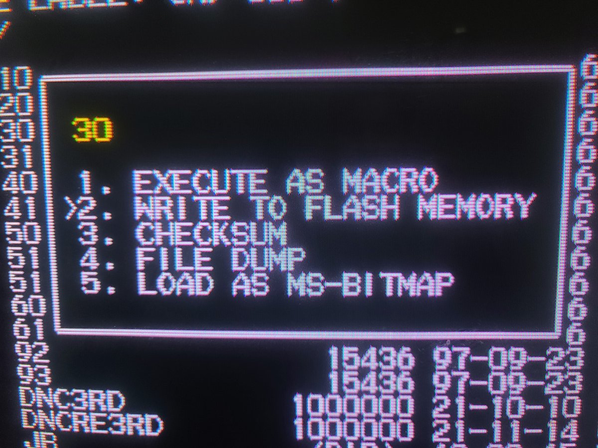

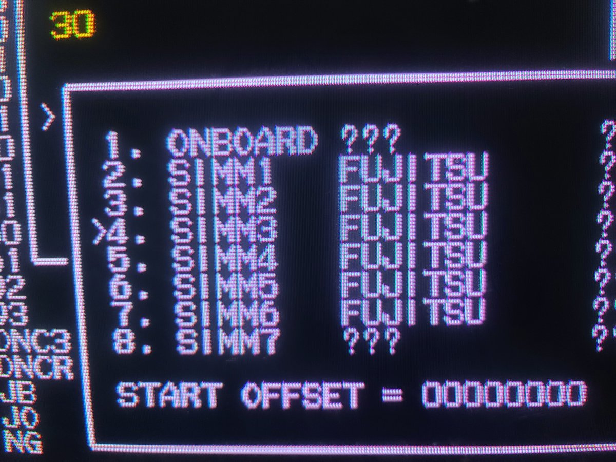

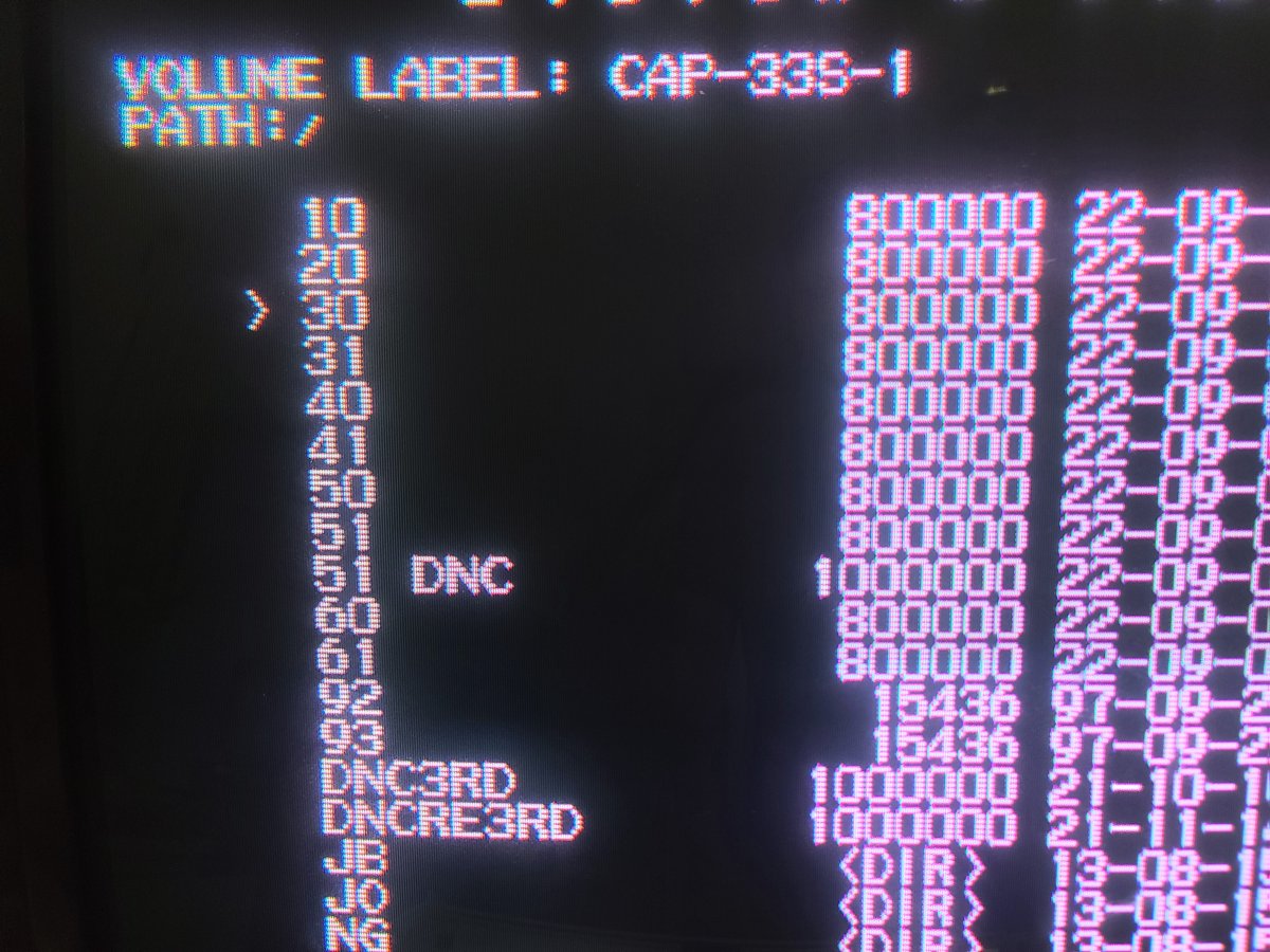

Right, the one part I don't understand (if someone would explain it) is, how you get the files that are SIMM files that you replace from the unzipped ROM files, three of them, files that are not in the BIOS CD's so its not possible to access it from the BIOS CD after you installed it on a CPS3 hardware, so how do I run said hack on OG hardware?The "Not with my BIOS" response was referencing the CRC checks that the stock Capcom cart does against the game. The UltraBIOS doesn't perform CRC checks and thus runs CPS3 hacks.
