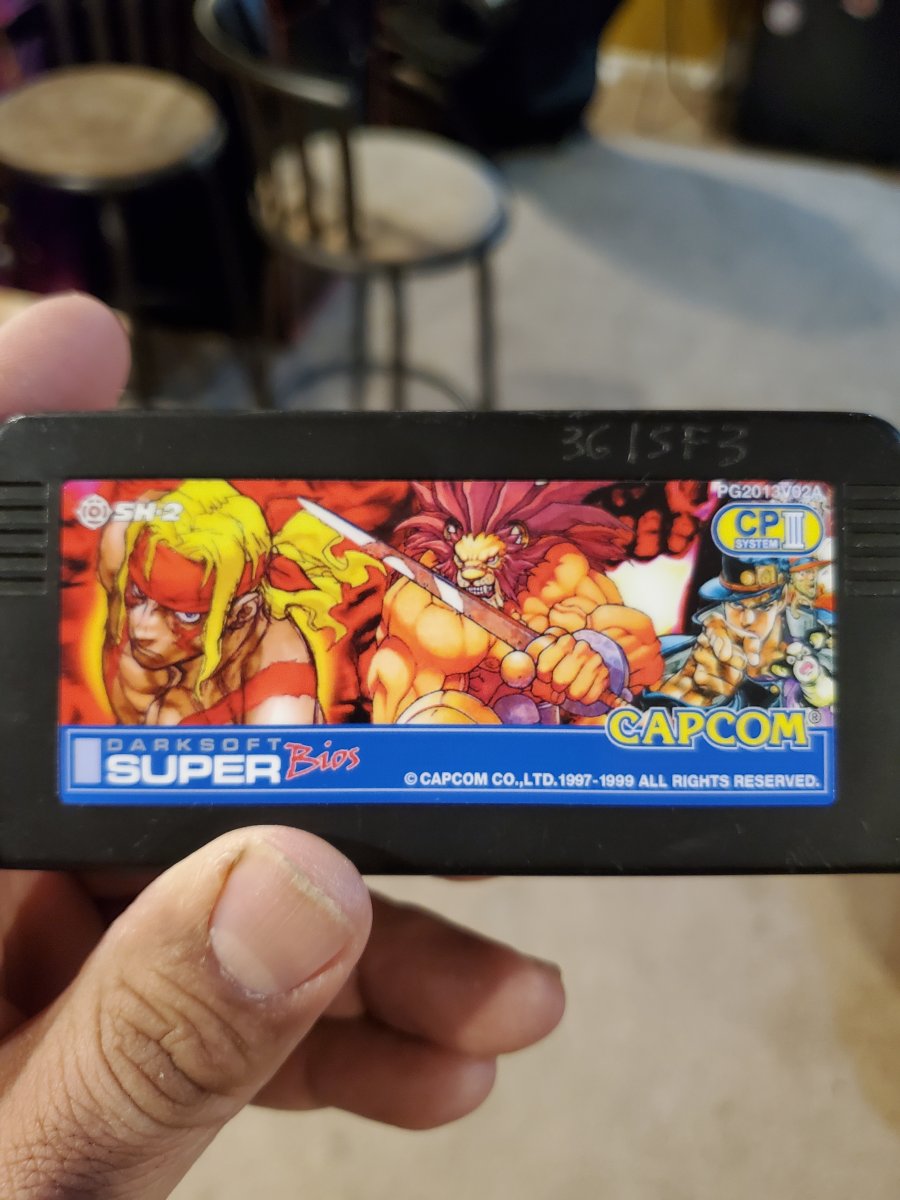

Is there anyway to tell what kind of cart I have. Recently bought and it came allready loaded with 3rd strike. No cd or any other scsi attached. It runs and plays fine. I really don't plan to change the game as of now. Just wanted to know before I attempted to write something and botched it up lol. Thanks
Usually it's STANDARD SH2 version. You can never botch up anything to be honest. Give STANDARD SH2 version a try first

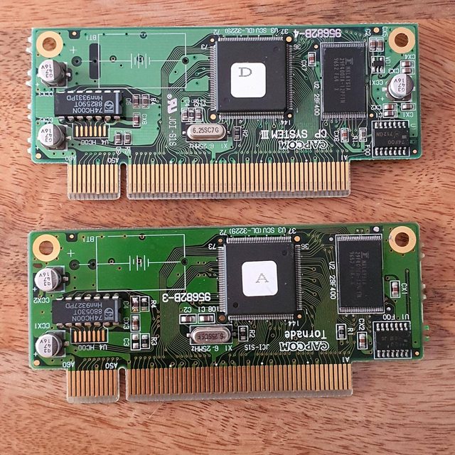

Customs will look like this:

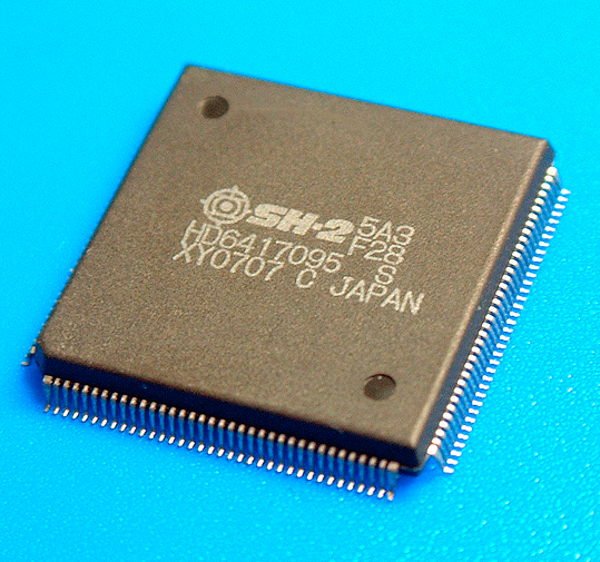

While Standard will have "SH2" on the big chip like this:

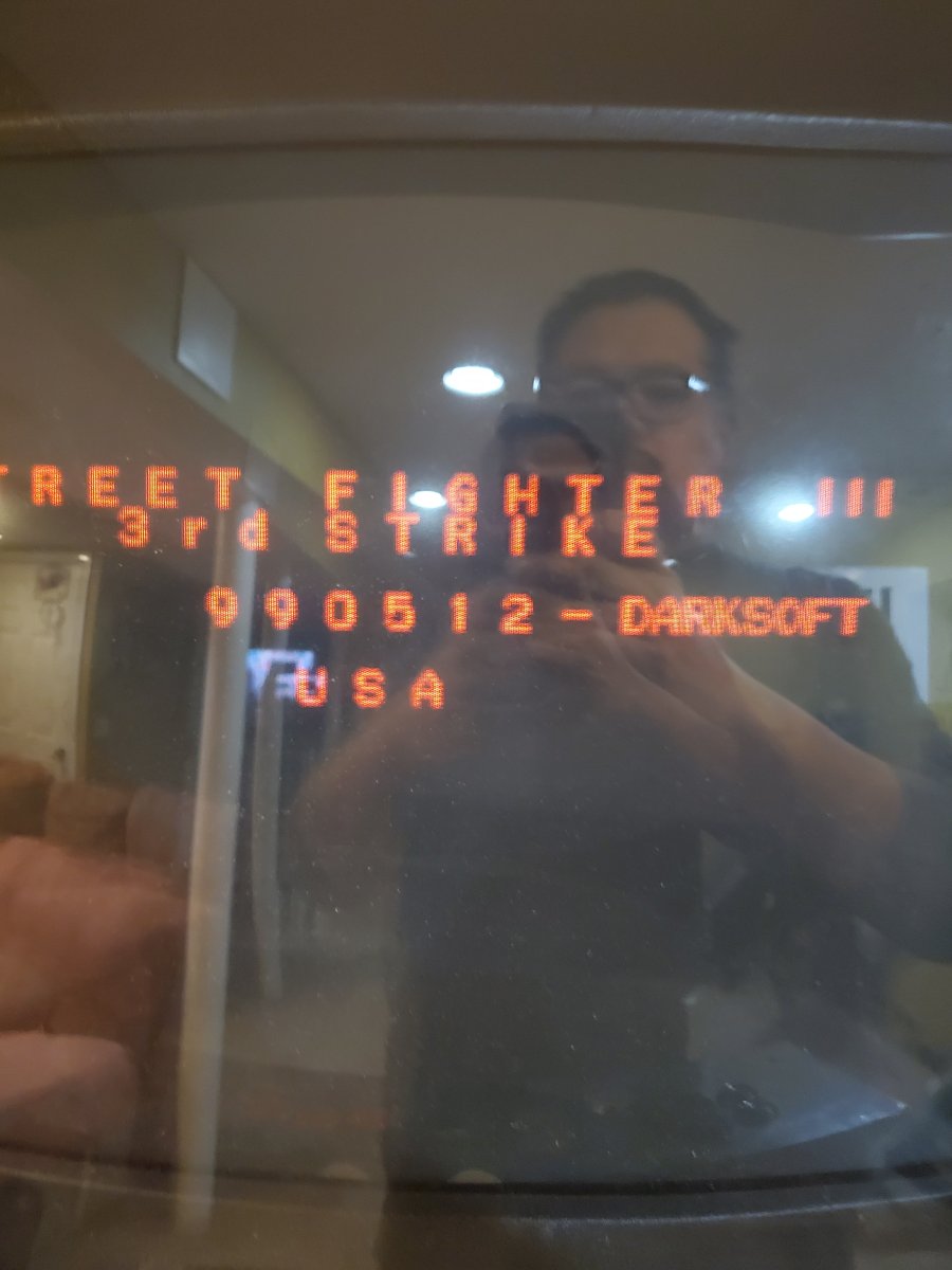

It would be great to know which cart you have there. Also please let us know which region are you running. It shows up on boot on the screen.
Yeah the region never shows up. Just boots to this screen

My guess is that you have a genuine cart that's been converted to the NoCD UltraBIOS and the SIMMs have been programmed for NoCD Third Strike. This seems to be a common thing lately with resellers. I'm guessing there's no CD drive or SCSI2SD connected at the back?
If you have a security screwdriver to open up the cart (slide the case out to be careful not to break the tabs) to show the front and back of the PCB that should let us know if it's custom or standard. Almost 99% sure it would be custom.

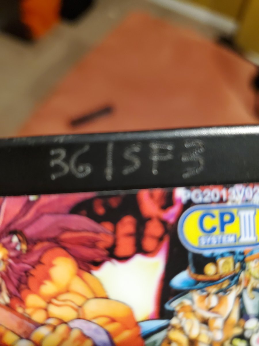

I also have this other cart. Is this standard sh2? Waiting on the scsi and just want to make sure I get right iso.
whats in your picture is a piece of plastic with a sticker on it.
you will need to open the cart shell and look at the chip on the PCB in order to tell which SH2 it has.
