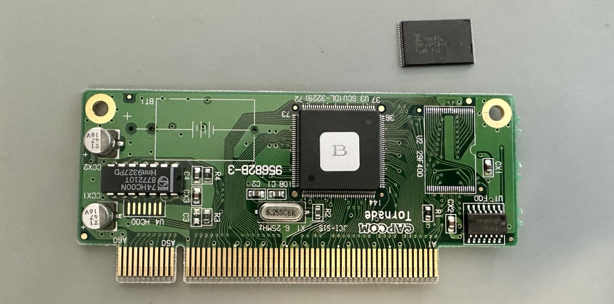

It should work irrespective of the bios (super or ultra). But updating the bios involves desoldering the flash, writing a new flash and then re-soldering it. Definitely not an "easy" task - especially if you've never done it before or have the necessary tools
Yeah, I don't have the skills for that.
What I do know is that the person I bought this from told me he purchased this in 2019 and had it stored since then because he never got around to getting a CPS3 board. I assume that would mean that this cart has the super bios? Regardless, for me to have a consistent install issue with one particular game across several images, something isn't right
I assume updating the BIOS on this cart is not easy as well right?
FYI for anyone that needs it: I update the BIOS on CPS3 carts for $35 plus return shipping.
