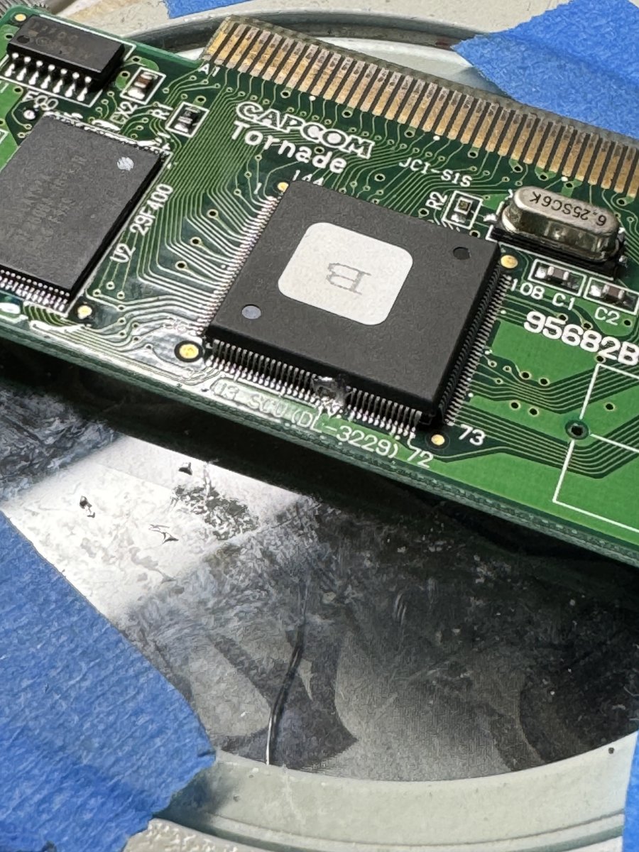

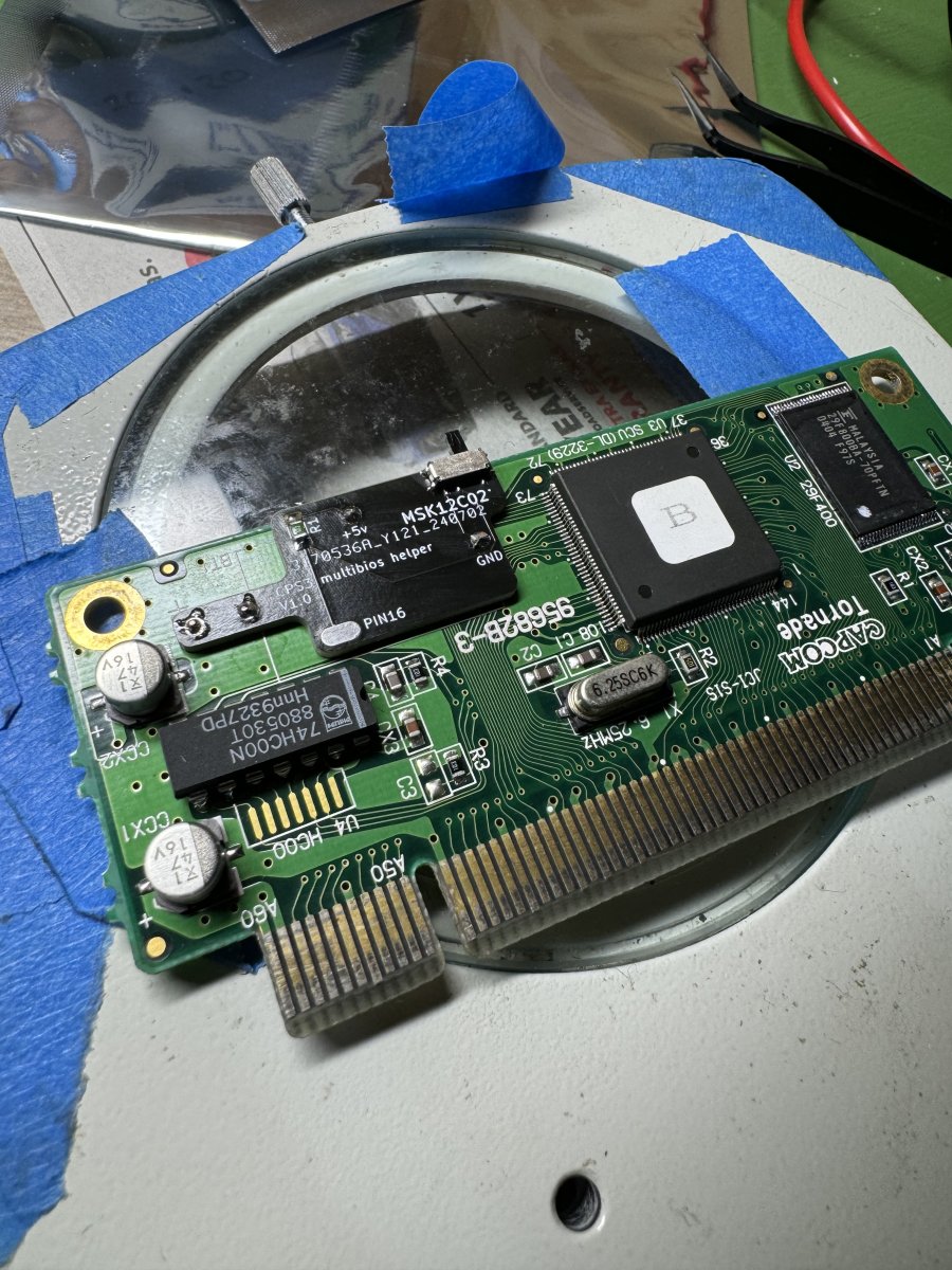

The dual-bios helper board fits on the “rev.b” cart I’ve had kicking around for a while.
Normally I would use hot air to remove the old bios, but this time gave it a go with Chipquik alloy. Works really well, would recommend

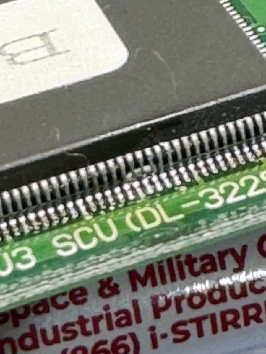

Would not recommend splattering excess alloy on the legs of other chips, some of the alloy got behind the legs of the SH2 and created a bridge, fixing this was mildly challenging

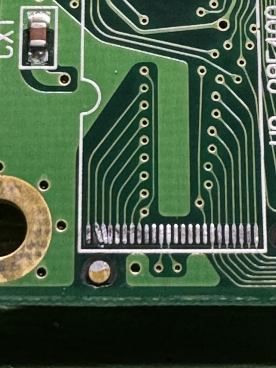

It’s also possible to put a lot of direct heat into the pads using alloy. Standard pad repair here, and these ones are also available on the back of the board if things get too bad (not in this case)
So all that remains is to jump pin 16 to the pad on the helper board then test it out.
What kind of wire does everyone use for this kind of thing. TSOP48 is .5mm pitch which is… quite small

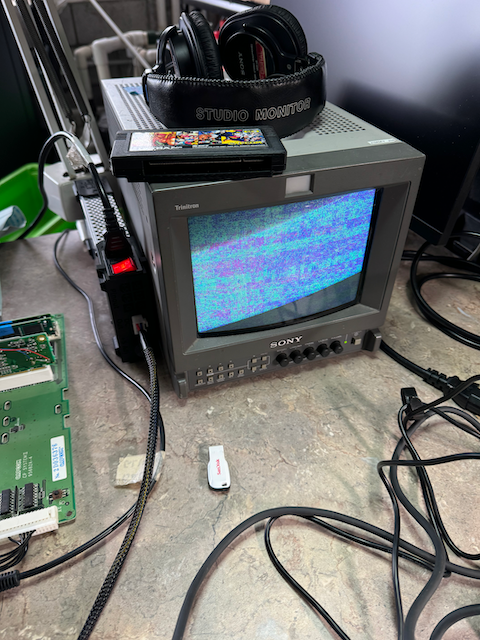

Rats! That feeling having soldered up a new project, 100% sure that it's going to work aaaaand....
Garbled graphics like this on a CPS3 normally mean "my security cart is dead". No secret hidden meaning that I've ever found in the garbled graphics, just whatever random noise happened to be in VRAM when the processor decided to dump it to the frame buffer. Back to carefully recheck all my work...

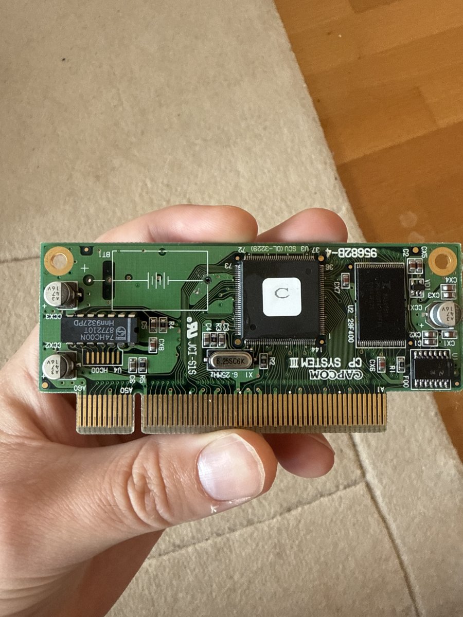

Board looks original, sticker on the CPU is original. That's almost certainly a custom CPU. No battery seems to suggest it has a Darksofted BIOS (but it could also be a 2I BIOS).
Repro cartridges have a STANDARD CPU and a Darksoft BIOS.
When you start the system with that cartridge, do you see the "PUSH 1P FOR DARKSOFT MENU" prompt? If so, it's a Darksoft BIOS, and you need to use the CUSTOM CD image. You must also rewrite the SIMMs with the game data from the CUSTOM CD image.

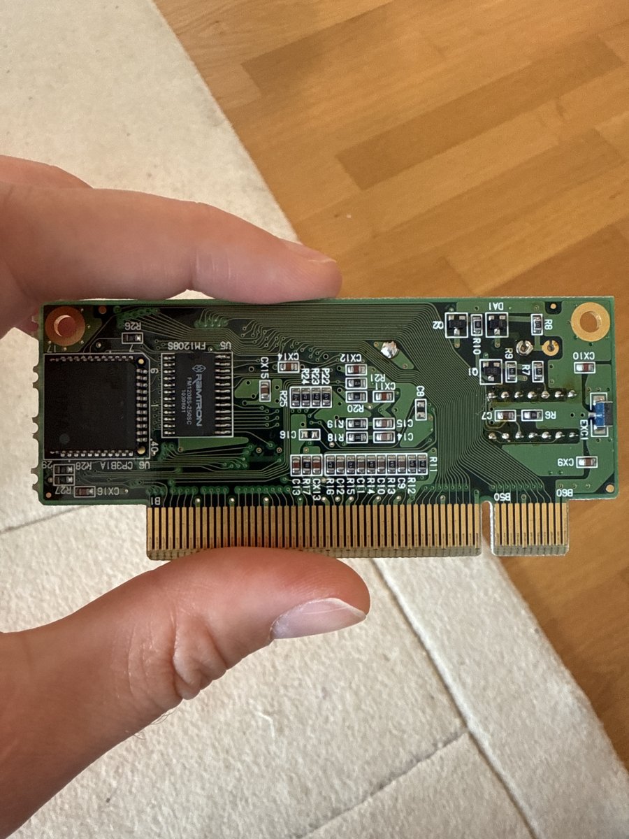

This looks like the standard cpu, is that right?
That’s a genuine CPS-3 cartridge with a custom CPU. You can easily tell by the sticker on there with the letter “C”.
Repro cart will have a standard CPU that has these markings on it. Furthermore, recent repro carts don’t have Capcom printed on the PCB.
If you’re using the cart for UltraSIMMs, I highly recommend the standard CPU / repro cart with the NoCD BIOS because you’ll unlock two awesomely fun mods of 3rd Strike (4th Strike and re:Third) that you can’t play with a custom CPU. I upgraded all my setups to this and it’s the ultimate config IMO.
for the record: on the photo above is NOT standard SH-2 CPU, but a bit custom chip for Sega. "standard" SH-2 chip is HD6417604
speaking in general - it seems all the Hitachi/Renesas CPUs labeled HD64170xx is the customized CPUs for 3rd party hardware manufacturers.
