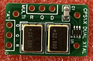

Latest (hopefully final) revision of the dual xtal pcbs finally came in, will send one out to ekorz to test. Once he gives the green light will send a few more out to other testers, if all goes well, these should be for sale in a couple of weeks.
Looks good man! I’m sure you have enough testers now, but if you need another let me know. Been testing and shilling for multiple members here 😉
Otherwise I’m a day-1 purchaser of this!
Looks good, can't wait to try this. So it will use the "dash" file present in the folder of games running on 12MHz mobo? Is there an explanation of the operation and connection somewhere on the forum?
