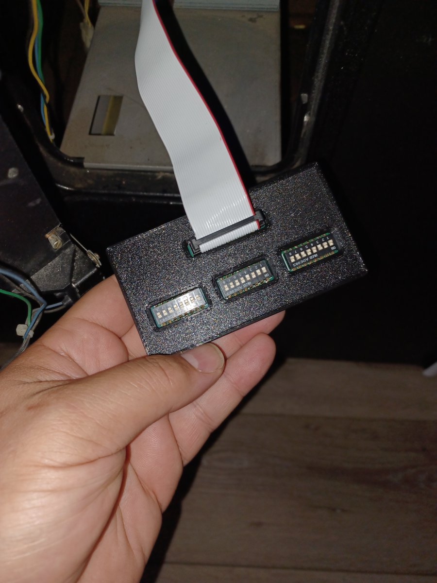

I got this great 3d printed DIP case from @APDWaldo6 thanks its perfect for my setup on the coin box.
