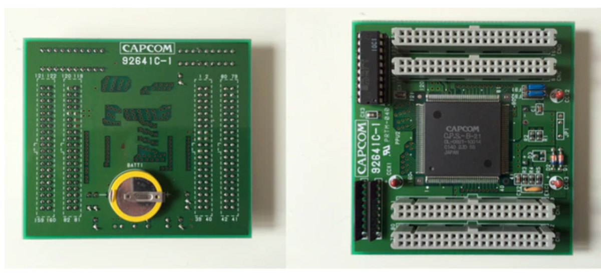

Just want to update that the A board has been confirmed to work with the Multi. So it's now down to the C board and the Multi itself. I have a C board incoming and it is supposedly unmodified so hopefully that is the culprit. Here's a photo of said unmodified board from the site.
I'm not sure if that's good news or bad.
Good, if it's the C board; bad, if it's the multi.
Let's hope it's the C board.
The C board pictured looks unmodified.
How has the A board been confirmed to work with the multi? You have tested on another DarkSoft CPS Multi?
I sent the A board to my friend who has a Darksoft CPS Multi. I left the Darksoft PAL and the wires on, so he literally just popped the Darksoft board onto my A board and turned it on. It worked first try. He made a video as well. Kikaso and Clint both watched it at least; maybe a few others. So, we know the Darksoft PAL and A board both work fine. So...I am realllly hoping the C board is the culprit cause I don't want to see what I need to do if the Multi is bad. lol.

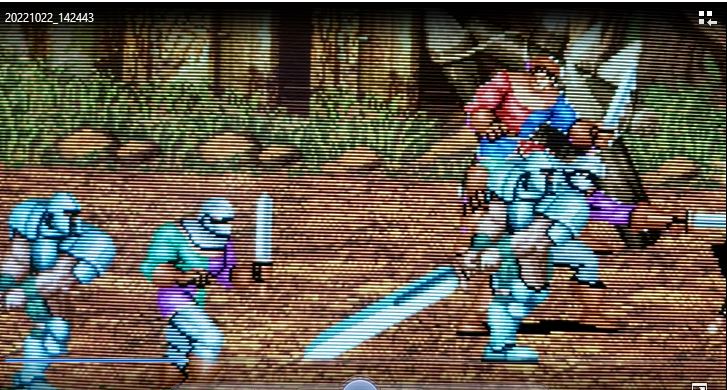

In the Japanese set where the multipacks are available online, Knights of the Round has graphical glitches. Confirmed it is the rom and not my board.
Can you give us the checksum of the files you are using ? crc32, md5 or sha1 is fine.
Also some pictures showing the issue please ?

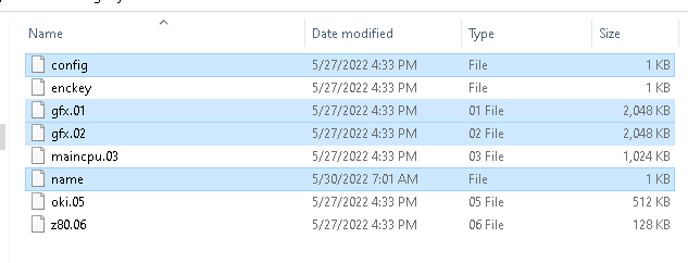

CRCs for following files in order. Taken from Japan v 2.1 pack.
Was hard to get a photo, but you can see white outline on red and blue solider in the snapshot below.
