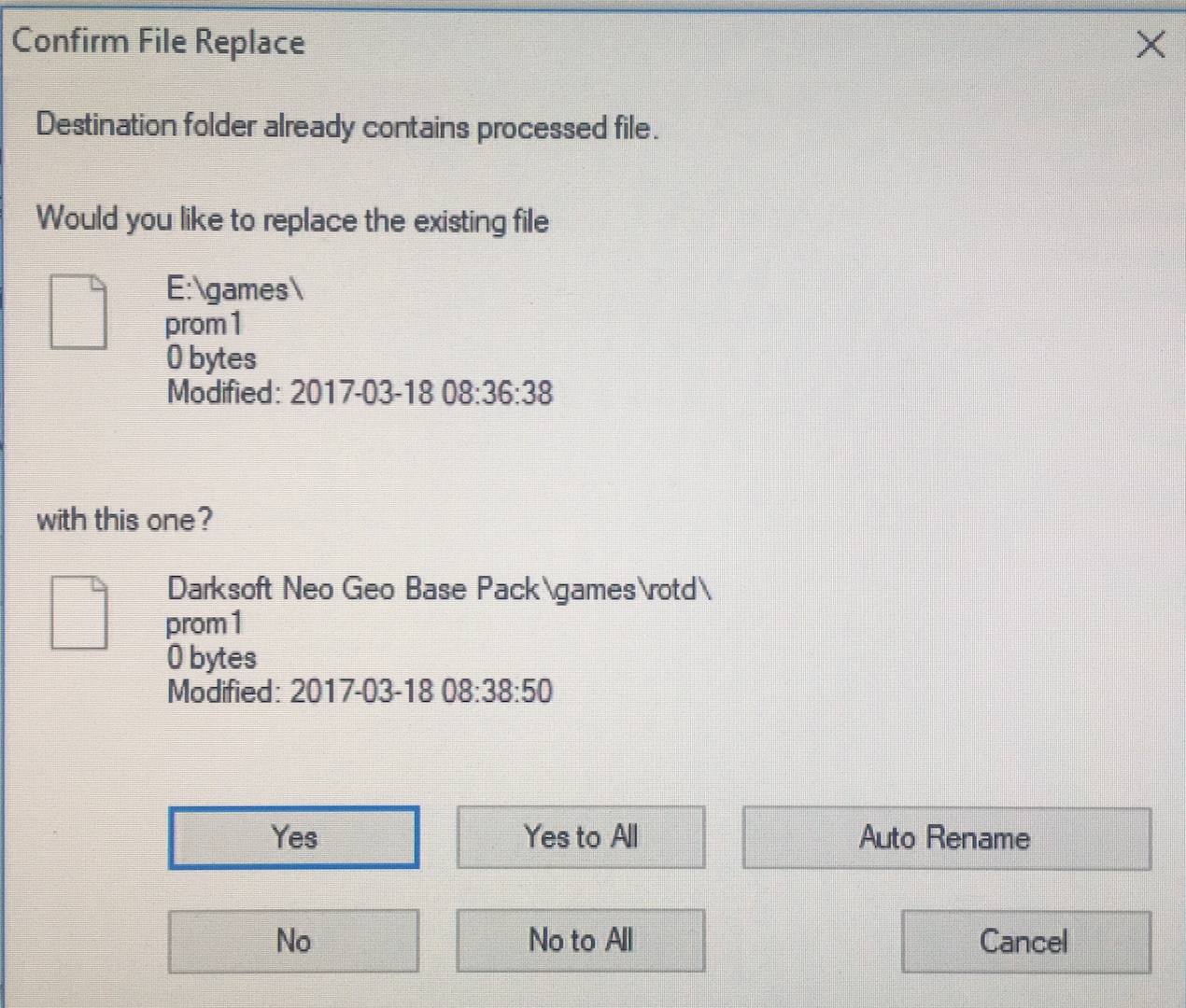

while using 7 zip to extract rom pack with freshly formatted card I get this prompt.

you shouldn't be extracting directly to the card, extract to your windows drive then copy the files over.

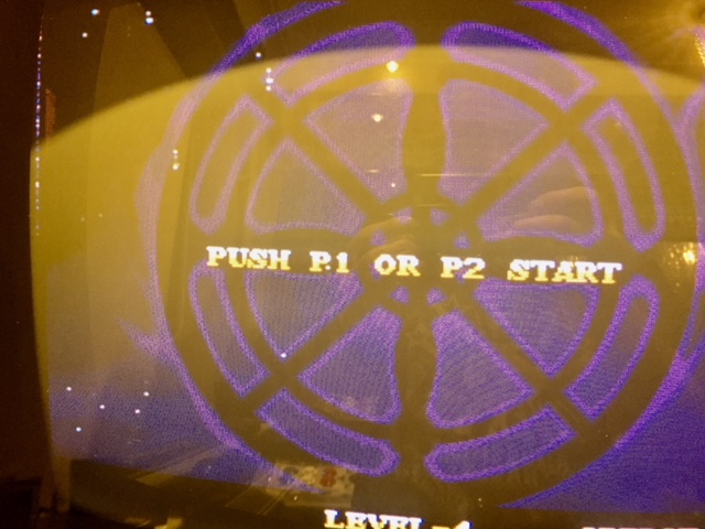

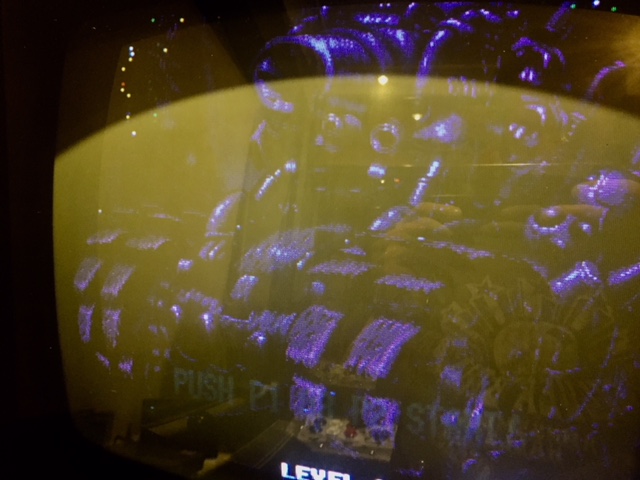

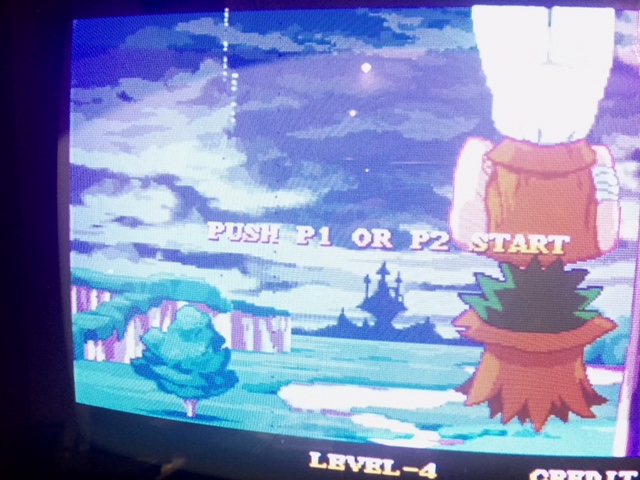

I've updated my cart with the latest Menu and FW and on my 4 slot there are still a few glitches although much improved on before.
I tried Turfmasters, Magical Drop 3 and Metal Slug.
@t-m I'm pretty confident that the source must be a different one. Not the firmware. Can you try with another motherboard or microsd?
