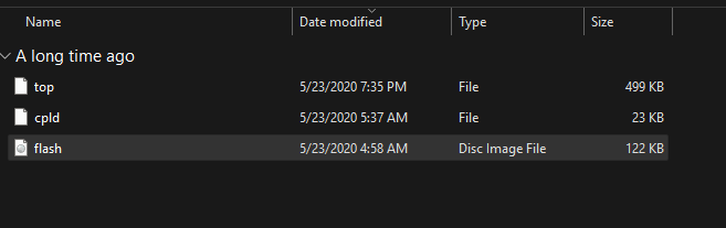

Does this look correct?

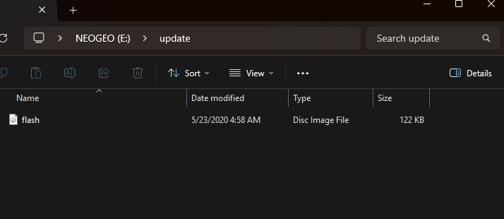

Or would you like me to add all these files too?
Do you want me to include menu in update as well?
Don't include menu folder and yes, only.flash file is OK. Try it and see if the file is deleted. Btw are you using a Mac?
Ran it again with flash in the update folder. The screen went white and then it went back to the same image I've been seeing. I brought the SD card back to my PC and the flash file is gone from the update folder.
That is good news. Put the other 2 files (top and cpld) and see if it does the same please.
Then you can try with the menu folder and it should also dissappear after a successful update.
