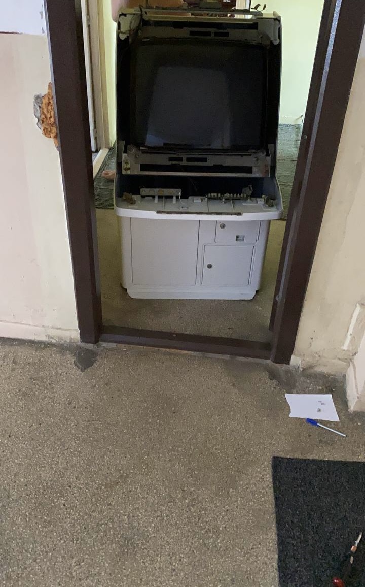

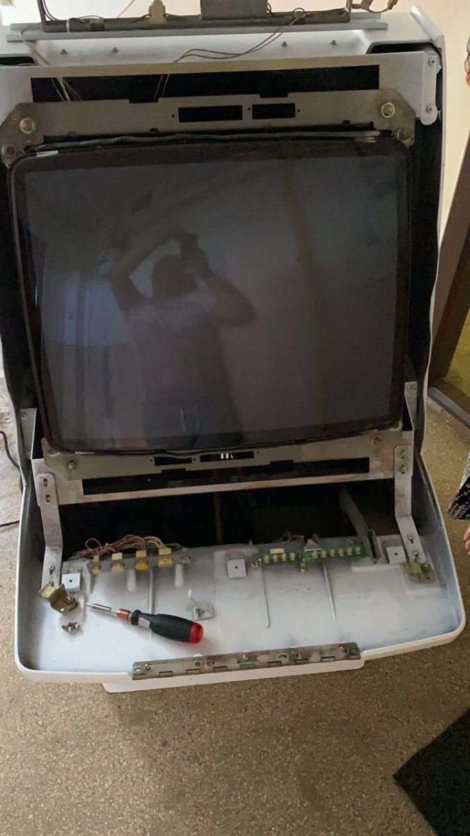

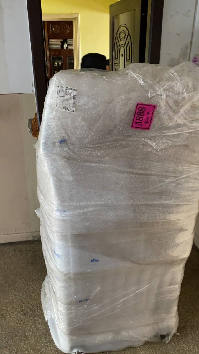

Is super easy ✌🏻. at least .. for me was easy . i found that when i was in front in the front door apartment …. we bring this up along with other 3 persons . 4 persons , 2 floors , 16 steps + from the front of block enter building where the driver left it .
If i knew , i would have disassembled it after the driver left it in front of the building 🤦🏻‍♂️🤷🏻 (it would have been much easier to climb with it to the 2nd floor)
