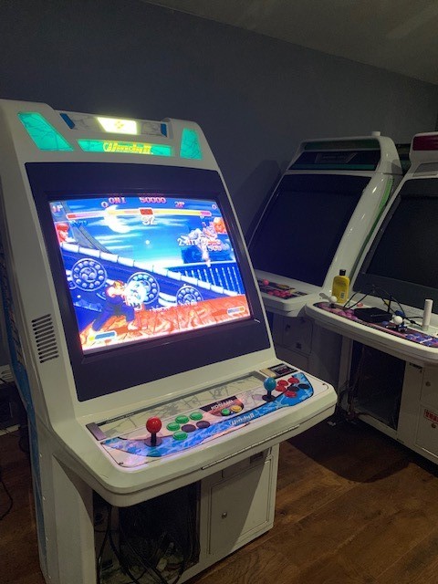

It's a MAME PC. It can't take separate H/V sync. So watch out for that. Yoke swap was needed. The AC connector on the chassis is the same that is in the Windy. I found the yoke cables are far too short on the 29E31S so right now it is sitting on a family size cereal box in the cab. Will buy stand-offs later. I don't want to cut the yoke cables and solder on extra length. My 29E31S came off a flat screen monitor, so the geometry isn't correct in the corners. I see some pots on the yoke, but have no idea what they do so I am iffy about touching them to adjust for the "clover-leafing" effect that I see in the corners. Right now, it is mickey-moused in. Will likely reterminate the video connection on it to JST so I can plug it right into the Windy. Demag isn't connected as I don't have the right connection. Will build an adapter.
Hesitant to spend more dough since might send the WindyII chassis off to Grant. That's what I can think of off the top of my head.
so I basically just need to find a family size cereal box since my sanwa CRT came with that chassis. Ok good I was affraid.
