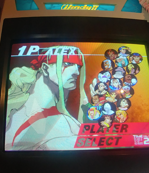

The chassis performs as well as the original but the width capacitor did have to be changed so that narrow games (CPS3, etc) will fill the screen. Everything else is great, colour, geometry, etc...
My chassis has been running for ~16hours without issue. I'll post some pics of the flyback this afternoon.

Not personally as I don't have any 31k games at hand. My Type X2 & Naomi are still boxed up after moving house but it is known to work.

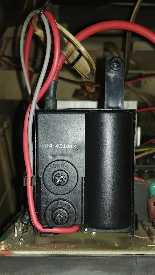

Image of flyback. This is the only writing on it as far as I can see.
