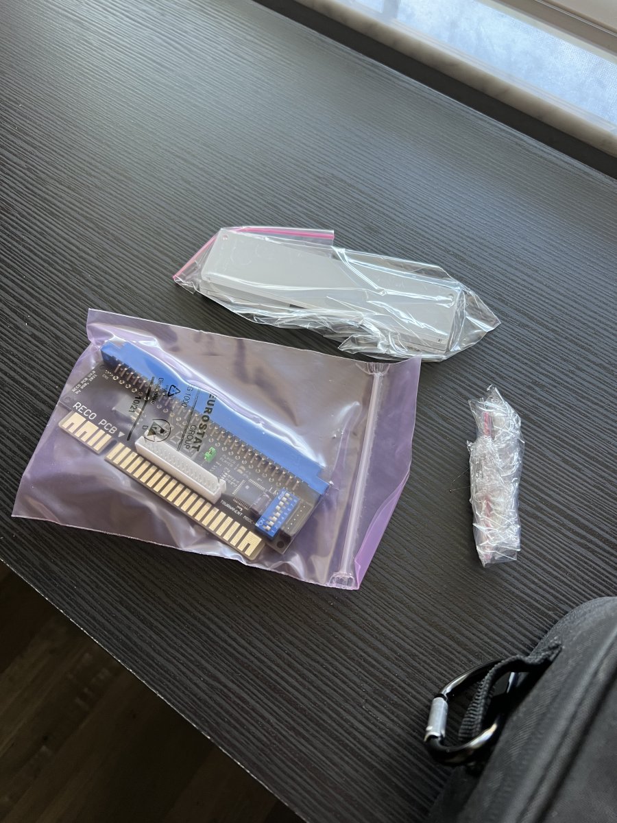

Got my RECO board today—thanks, @RGB
Cant seem to properly map buttons on Neo Geo 1-slot, however.
I have a CPS2 kick harness connected to buttons 4, 5, 6 of my control panel which connects to the RECO board on the other end but the buttons don’t register in re-mapping mode. I have DIP switches 7 and 8 in the ON position at the RECO board.
Hopefully I’m missing something obvious here 😅

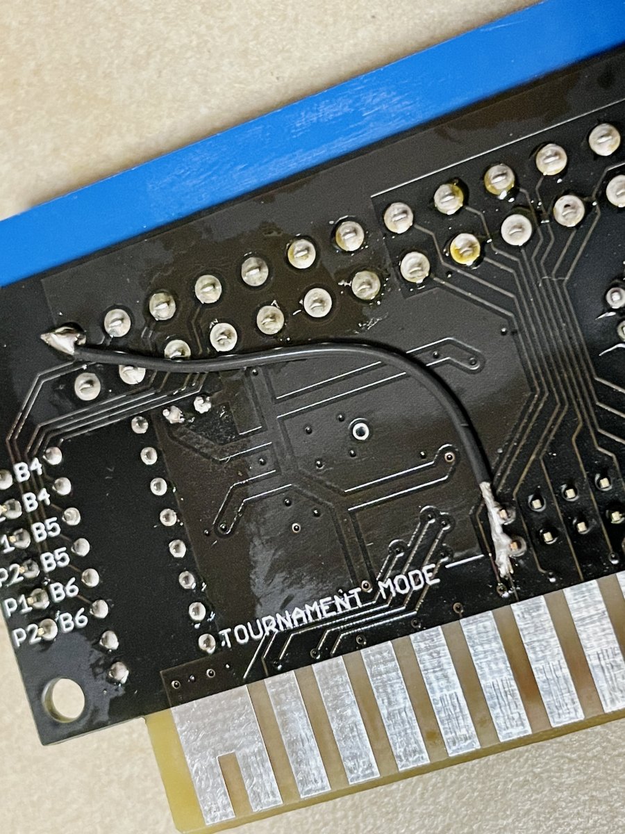

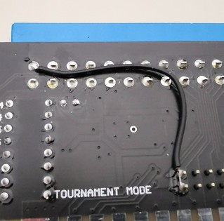

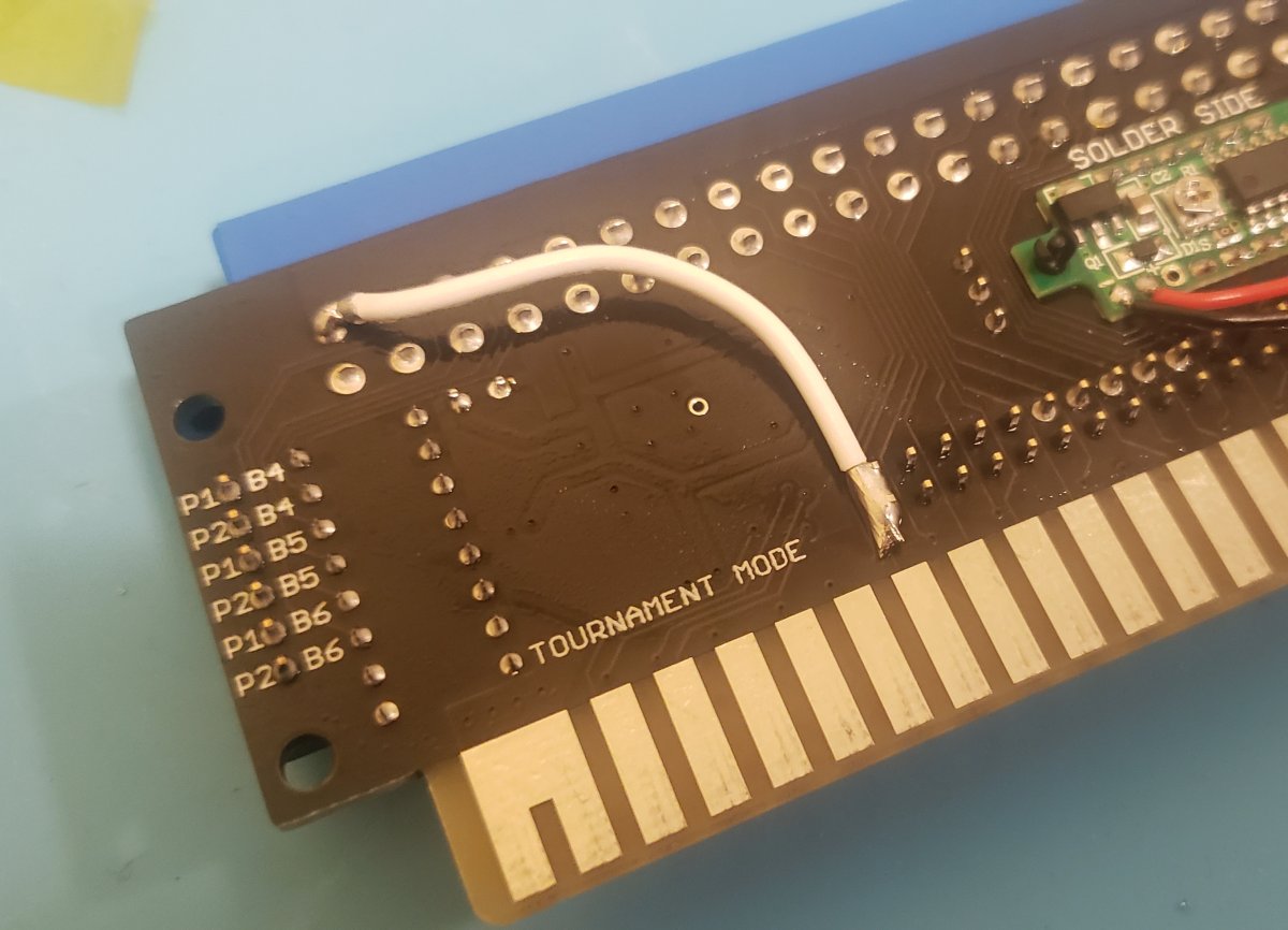

This is embarrassing, but I forgot to map GND to the CPS2 connector input. Not everyone will be affected by this, but if you are, please PM me and I will make it right. I'm really sorry for the inconvenience.
All RECO units for sale will now have a fix for this, a simple jumper wire.
This repair worked perfectly for me. A two minute job.
