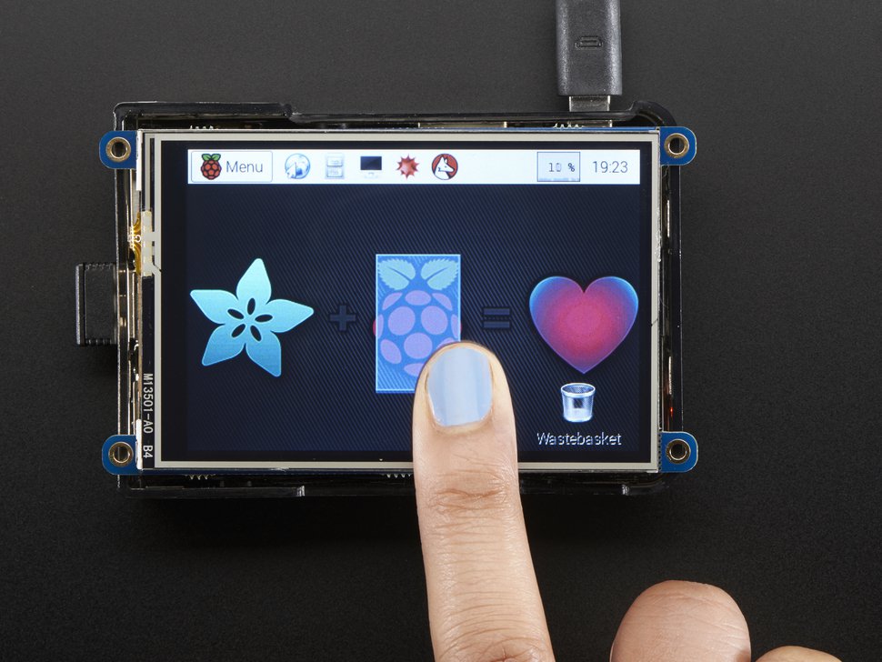

Has anyone here used the Pi with the 3.5” screen with the piforce tool? Would it be the same process steps to setting it up with the piforce tools, and where would you place the picture so it can display like this

I have such setup. The only complain I have is the lack of feedback on what’s happening after you press to launch, and that each press on the game to start it queue it up. So it you double press or more by mistake or thinking you did not press it right due to the lack of feedback, it will execute the loading of the game in a loop over and over again.
Thanks for the review :) , did you set it up the same way you would set it up with a 16x2 screen ? And also where did you place the picture for the games?
TBH, I got it premade, probably provided by the same guy from that french video you've linked. The setup is a bit different than what I've seen. It does not seem to need a zero pic either. The games need to be on a specific folder on the Linux formatted partition of the memory card, and the pictures need to have the same name as the rom for it to work. here is the video that was provided to me to show me where:
Images worked as jpg or png.
I have that exact touch screen on a control setup I built for my 3D printer the touch functionality is TERRIBLE and the screen is overpriced IMO. I'd take the normal keypad+character LCD any day.
if you want a touch screen just buy a cheap iPod Touch and run a web-app, it'll be 1/4th the price and wireless.
I concur :P That lack of feedback and accidental press makes it really tricky to operate for just a tiny bit of eye candy. Also sometimes the images are hard to read and you have to squint to see which version ot game it's supposed to be.
Thanks you guys for all the feedback on this, ill just go with the regular keypad+character lcd.. the big screen with pictures of the games is a nice feature but not worth does little headaches :S ... back to the original plan :thumbup:
