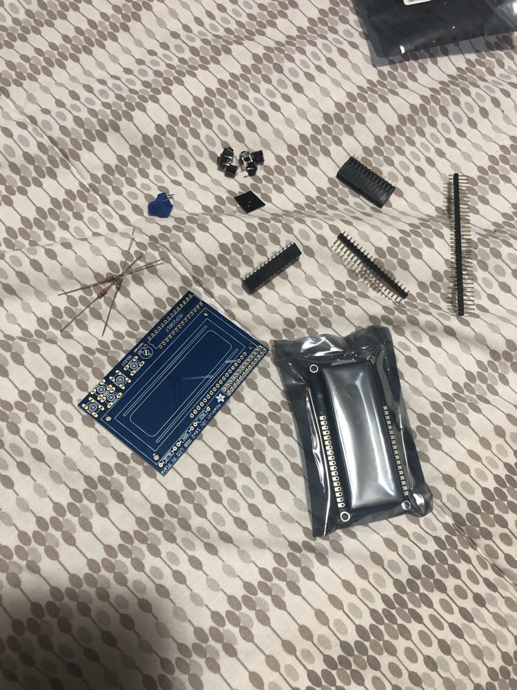

Gonna give this a try :)

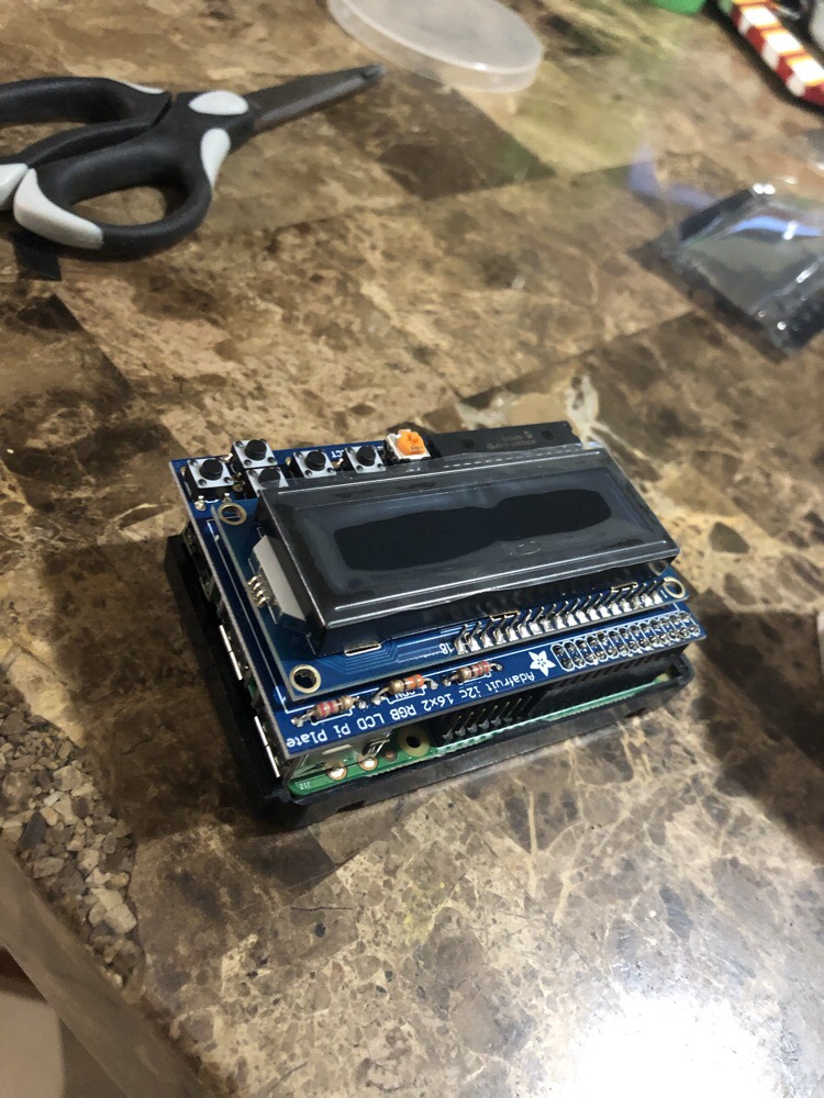

Came out good :thumbsup:
Question for someone here, do i have to follow the python installation first to make the screen work or do i just install the pi force to the PI and The screen will automatically start working?

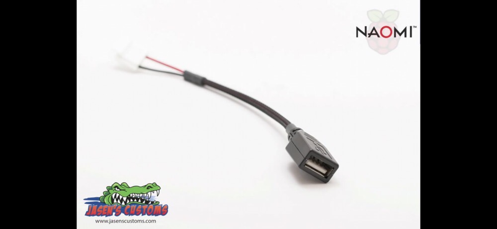

Anyone know where i can get one of these for the pi power cable -> naomi? Jasen costume dont seem to sell it anymore :(

right on.
I ended up making 3 of them about a month ago. I had a few usb extension cables and an old power supply I jacked the floppy power adapters from. Extremely easy to make.
