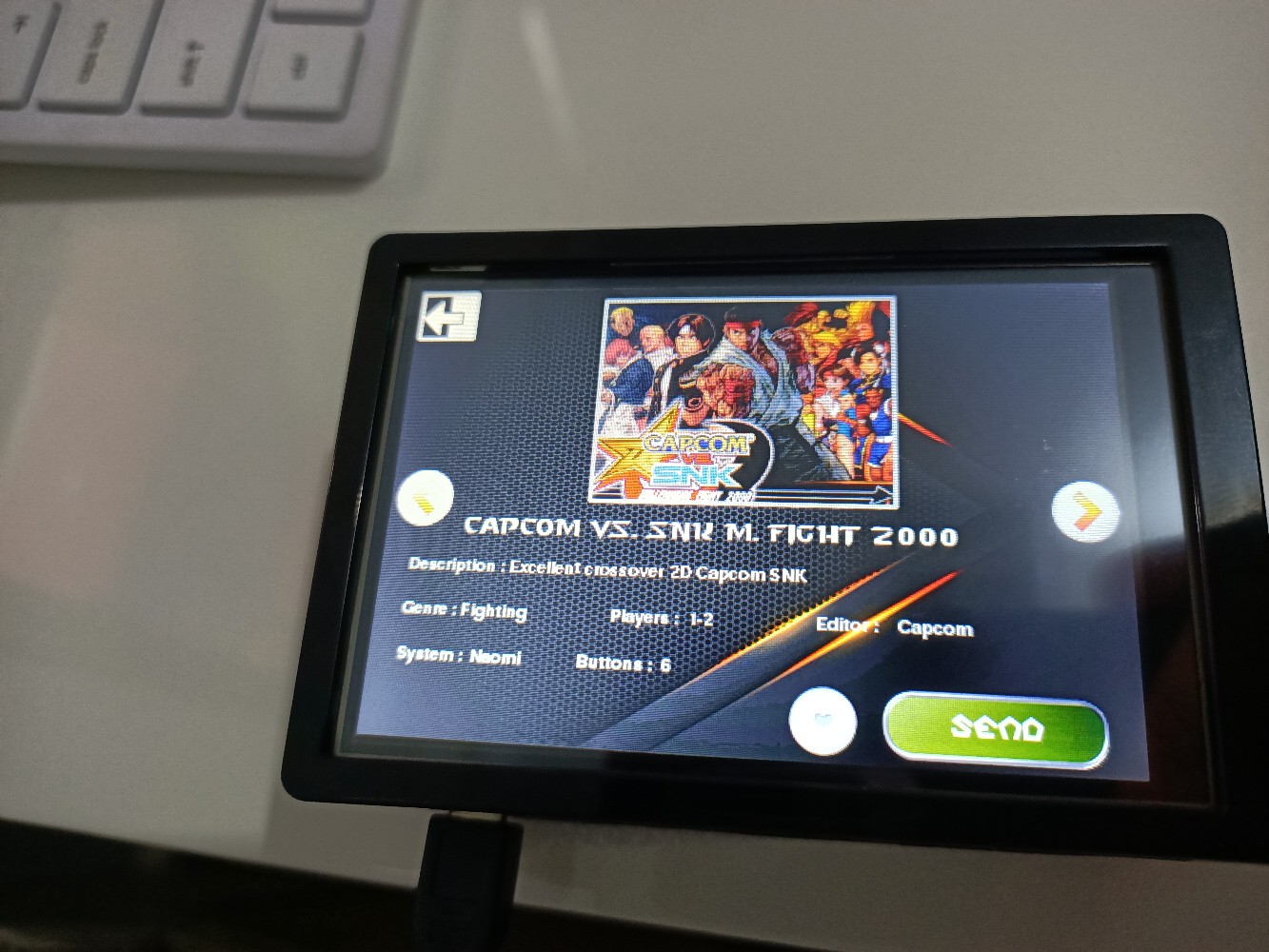

Please note that it is written for a specific LCD and Touchscreen driver. If you are using different hardware (which you are) you will need to manually configure these drivers yourself.
I'll happily get the correct screen, thank you for the link. Any model in particular besides the one suggested or will any do as long as it's within the dimensions?
I'm a complete scrub with linux and compiling on windows so I don't think I'll be modding any drivers anytime soon. I only have the skills to work with pre-built images.
Easiest way is to use the exact LCD module used by the author of that image. It's available on Amazon.
It's very nice. Includes a plastic enclosure to neatly house the Rpi and screen. Software image works straight out of the box.
https://www.amazon.com.au/gp/aw/d/B07N38B86S?ref=ppx_pt2_mob_b_prod_image
That's the Amazon link for the screen. I'm in Australia so it's an Australian link, you'll need to find it yourself on your version of Amazon.

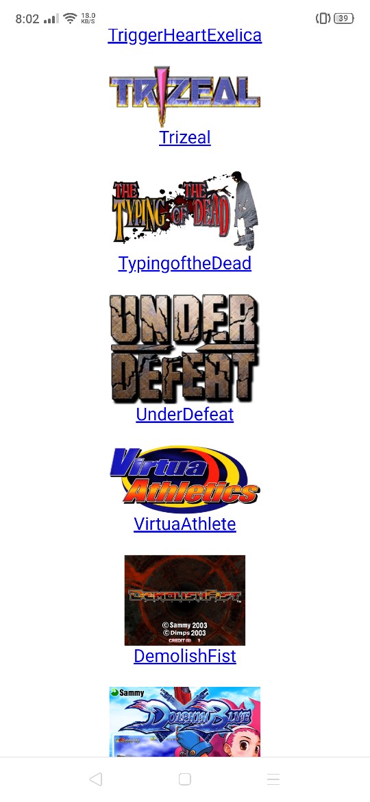

Another option, use the mobile phone version. That also works extremely well and is very easy to setup.
Link to mobile phone version:
https://github.com/dev-tty0/Piforce-Web/wiki
I personally like using the mobile phone version.. I find it quite easy.
I tuck the pi inside the cab and don't even have to touch it.

The web version is just that, it transmits wifi from the Pi, you connect to this wifi network via your mobile phone, and use a web browser to see the and operate netboot GUI.
