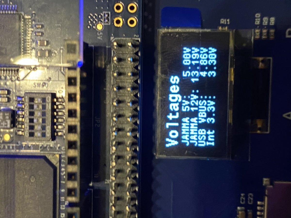

Hello, I’m late to the party. Im using in my mini cute from hurst. Mean well RT-125A powersupply. I adjust 5V to 5.00 but the A B buttons don’t work. Is the high 12V the issue? Thanks

If nothing happens when you press the A/B buttons its an input voltage issue I found. So I would guess the high 12V is halting the expander.
