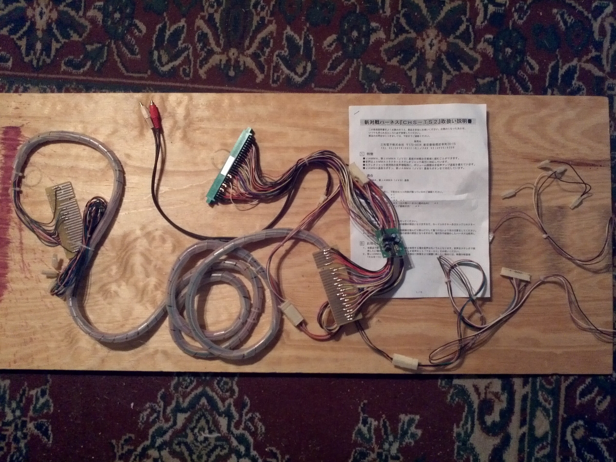

I would recommend the vs link setup. you just designate one cab to be the master and it gets the PCB and the master end of the link. Some links are made better than others... and may or may not have the same features.
Here's an example of one I used to own. This is a pretty nice one because it has extra features like the video amp pcb, stereo sound, and the auxiliary buttons to CPS2 kicks adapter. This is exactly what you'd want to run SF3 to its max potential on vs cabs.

How did you make the video amp and then distribute to both cabs? I would like 2 sources( two cabs) and another one to convert to hdmi(by ossc) and then plug into a recording interface.
I didn't make the cable, I bought it. a video amp is not necessary for all applications. It kind of depends on a lot of factors. If you want another output I would recommend double splitting on the master side... Like take a jamma edge capture device (such as the splitfire) and plug that into your game... then plug your vs harness into the splitfire... then plug your PCB into the vs harness.
