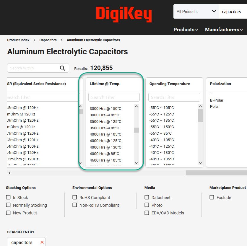

There are 2 things you should check when buying caps: the lifetime AND the temperature of said lifetime.
Digikey has a nice selector so you can choose only what you want:
( I usually go with 5000Hours @ 125C or higher if available and not overly more expensive)
