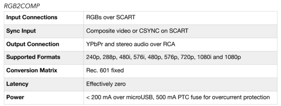

This video converter has un-noticable amounts of lag, right? I've heard it talked up in the past but that's my primary concern. Either way it doesn't seem like I have much of an option.

According to the specs in the manual, the RetroTink converter is essentially lag-free, so no worries there. LIkewise, the cable shown in your picture of the HAS is indeed the power cable. The spade connectors will need to be connected to your new power supply.
