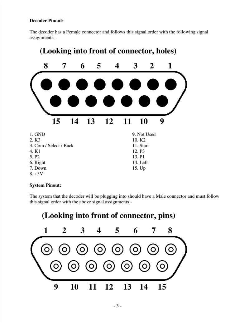

Anyone tried connecting Undamned Decoders with MultiJVS?
I'm having this weird issue with MultiJVS with the following unmodified mapping:
InputOutput
1P1P
2P2P
3P3P
1K1K
2K3K
3KCoin
Coin2K
StartStart
2K,3K, and Coin are not mapped properly. MultiJVs does allow mapping a profile, but having issues trying to load the app. can anyone help build a profille correcting the issue above?

Digging in further. What is the pinout for the DB15 on MultiJVS? Is it the following? This is how UD-USb is pinned, also shows what it's looking for. Maybe the cause of my issues?
Source: https://drive.google.com/file/d/0B3...TjA/view?resourcekey=0-WrRdFFMuxJZnZLOjxyhgfw

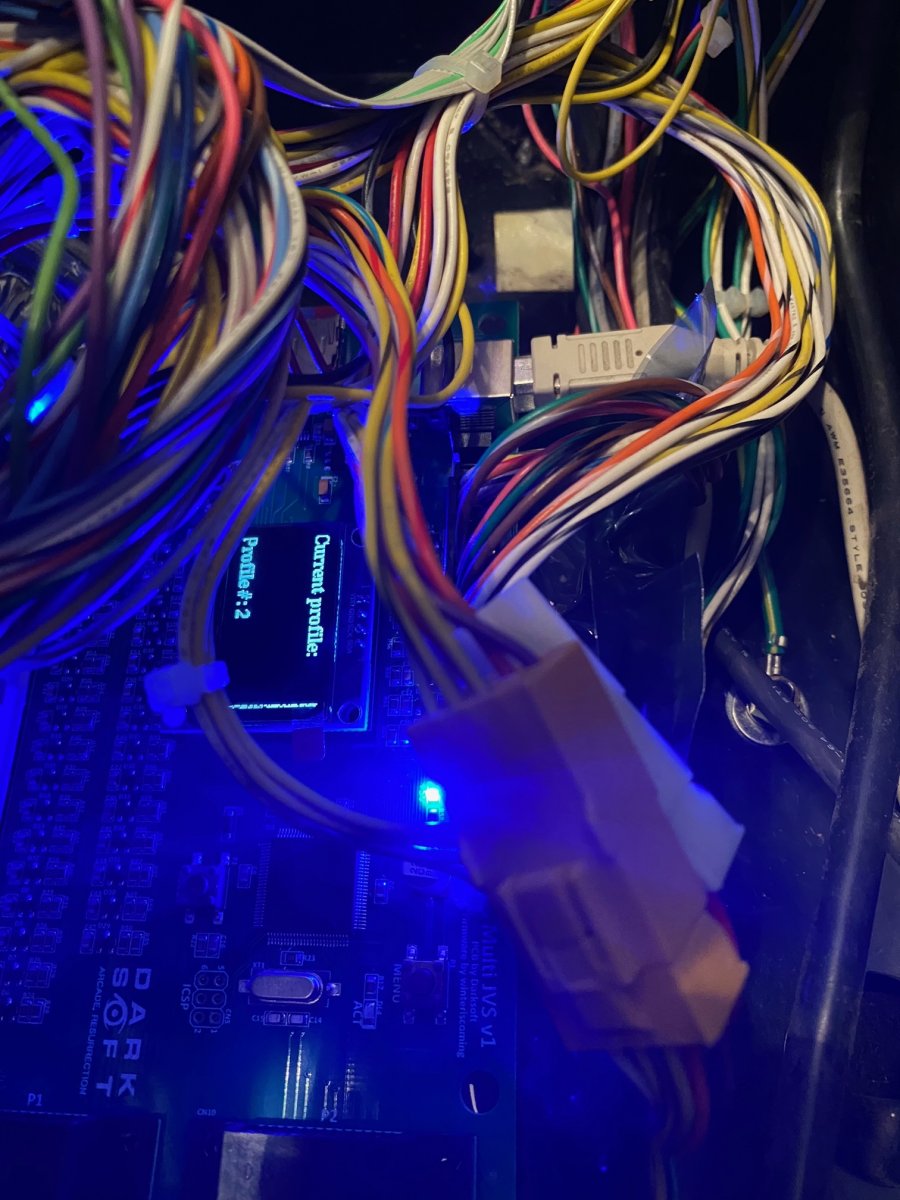

I purchased a Multi JVS v1.0 and I'm having some issues. I'm using the board in a stand up Jambo! Safari cab and have confirmed everything is hooked up correctly to the board. When there is no micro SD card inserted, the lcd screen says DFLT and the controls work normally.
I've tried it with the following files from the repository on the micro sd card:
1. With Ids.hex, lastprof.hex and profiles.hex on the micro sd card- The lcd screen on the IO board displays profile 0 and the controls work. I can go through other profiles, but they do not display on the lcd or work with the controls (not even start, test, etc. ). The profiles have strange names when they display on the lcd screen (see pics)
2. With ids.hex and profiles.hex on the micro sd card- resulted in only profile 0 displaying and when I hit the menu button nothing happens (does not change profiles.)
3. With just profiles.hex on the micro sd card - same results as #2.
I have had these same results with 5 different micro sd cards, each varying sizes and makes. Not sure what to try next.
Do you mean that all controls work well in your Jambo! Safari cab without any microSD inserted? So probably you want to try other games on that cabinet, right?

Do you have the files on the root of the SD card?

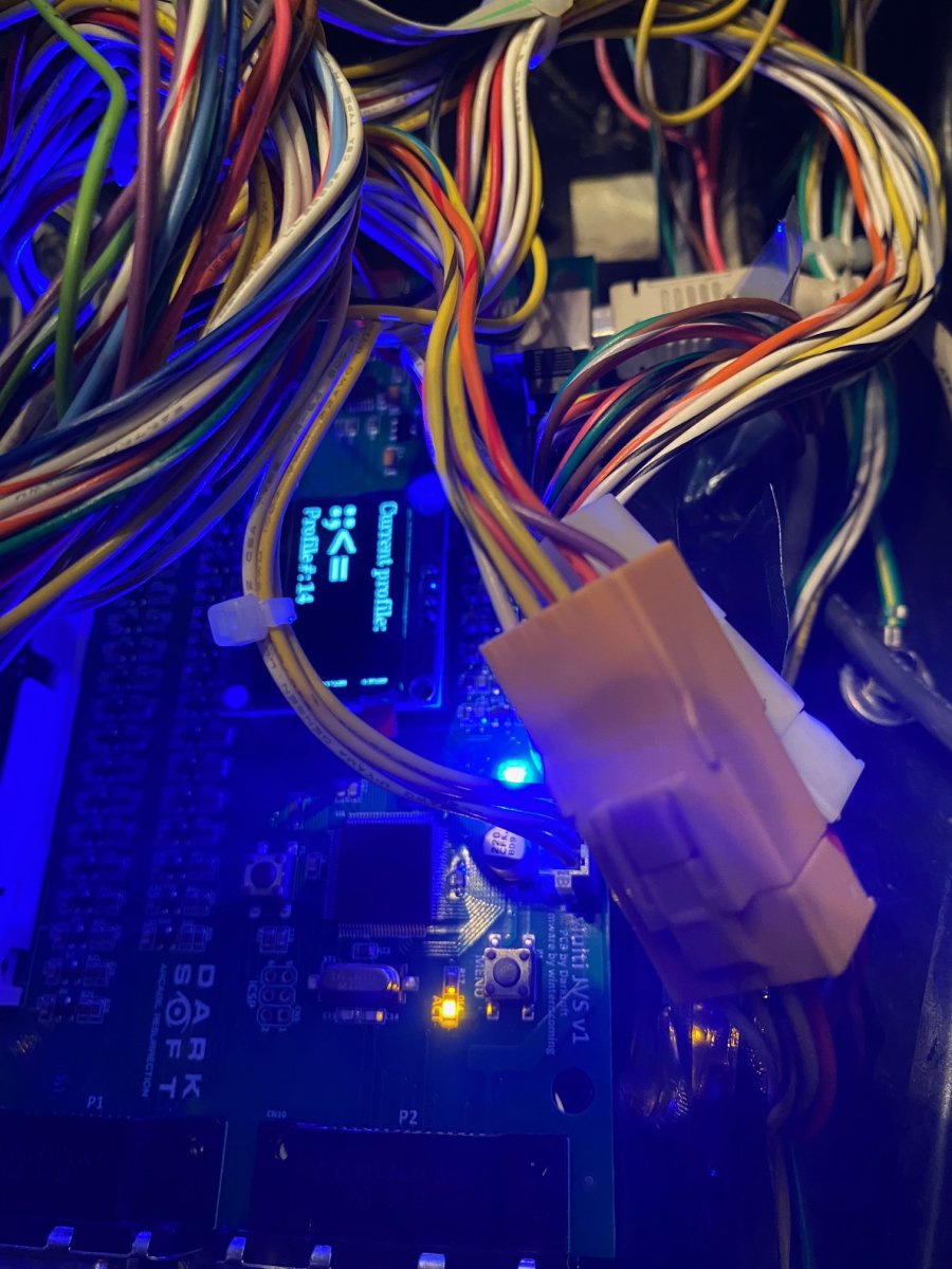

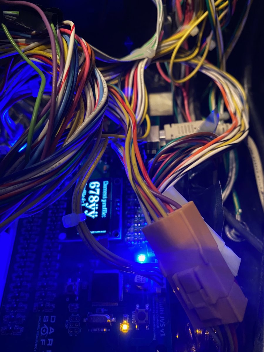

I also noticed when changing profiles I get jumbled characters.

Yes, I have the files in the root of the microsd card.
I think this is likely that you're running a version of the firmware that does not support the profiles you're loading.
Please update your firmware to the latest and try the latest profiles file that is posted in the repository.
Basically the profiles are getting parsed from a packet of data in the file on the SD card. When the profiles were updated to accommodate changing additional inputs, the data model had to be updated so that each profile has more data than before. An older firmware will parse the new data format and end up with corrupt-looking profiles after DFLT. It would be a similar issue loading an old version profile into a unit with updated firmware.

Looks like you never got a reply to this. This is addressed in the latest firmware and profiles. There's one called NEOG that should correctly map the ports.
