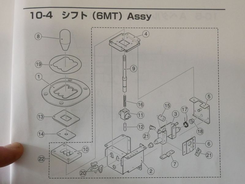

Just for the sake of posterity, the 6 position shifter on WMMT is comprised of 4 inputs, with some of the gears being a combo of 2 simultaneous inputs. It's not a terribly complex mechanism, but it would be difficult to replicate.
At any rate, my limited testing of the 2-position shifter in place of 6-position in the MEGA JVS firmware made me think it works quite well. Probably one of the few people to have tested it otherwise, and way more than I have, is @rocket if he cares to share any feedback.
Thanks for clearing that up :thumbup: one of these days I would like to get a twin WMMT, but drivers take up tons of room as you know haha so if I can have ID cabs do double duty that is valuable to me.
I pulled apart one of them recently:
Basically there's photointerrupters (20 in the drawing) for left and right movement, microswitches (21) for up and down. So 1st gear is a combination of left and up, 2nd gear left and down, 3rd gear just up, etc.
