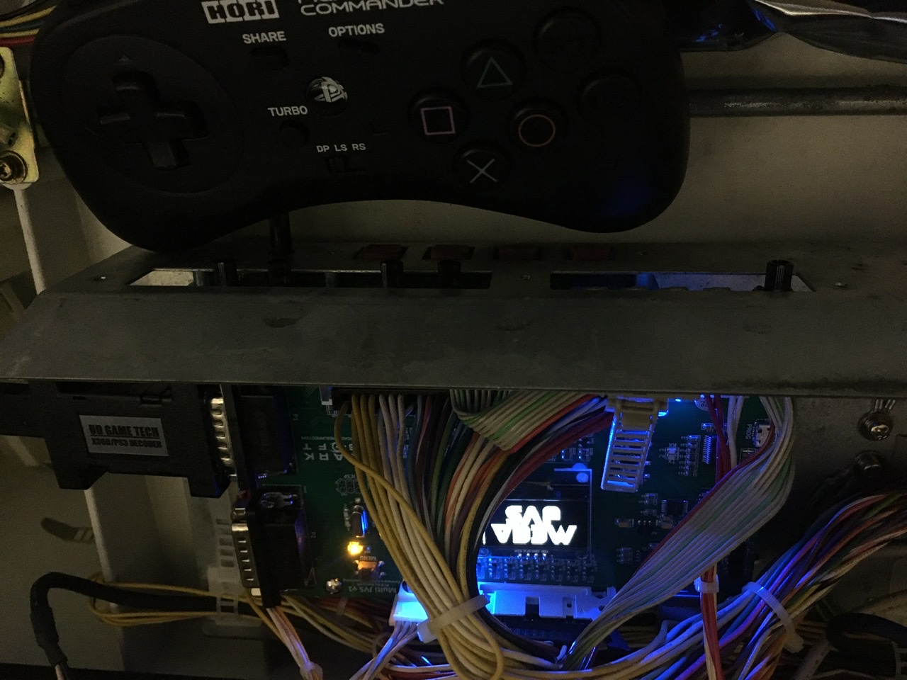

This little gem came in the mail today. It was fairly easy to drop into my cab. It worked very well playing Ringedge 2 with the cab’s control panel and my gamepad via db15 and @undamned usb adapter.
Now, what do you recommend to power this JVS IO board outside of a cab for a supergun-style setup?

@Mitsurugi-w is making some nice power adapters. Also, powering from USB should be fine if you just plan to use the JVS functionality and dont plan to power any LEDS,etc. then you need to plug the 12V.
For a Supergun-like setup with a SEGA Ringedge 2, I was thinking of using the DC out from it to power the I/O. Would that work? It would be nice to have for taking it to locals once we're all free to do stuff again.
