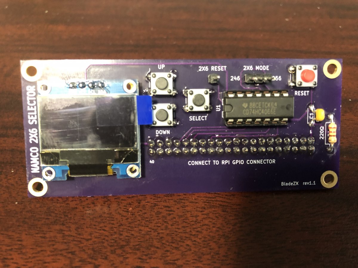

Very excited about this! Just ordered the boards and will pick up the other parts.... :)
I will have (1) extra after I am done building these - if anyone is interested.

The wire you need to solder to the motherboard reset is totally necessary because without it it will not hold the system in reset while updating the dongle and disc image

Hi @BladeZX - i got my boards from OSH today! Woohoo! I am going to start building them.
Quick question - are all the files (.iso for the images and .bin for the security dongle) just put into the root of the thumbdrive?
And - what is the password for the wifi? And last but not least, looks like login to the pi isn't pi:raspberry?
Matt
The dongle files are in the Pi image so leave those alone
The isos u need to put them at the root of a 256gb USB flash drive and plug that into an OTG cable and then into USB0 on the ODE simulator
Plug USB1 on simulator into USB on RPi
the ISO’s I got from the rollup thead
