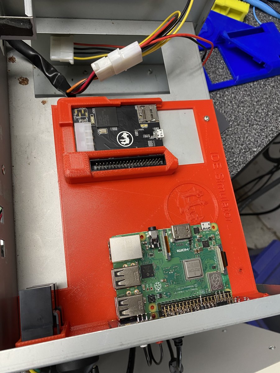

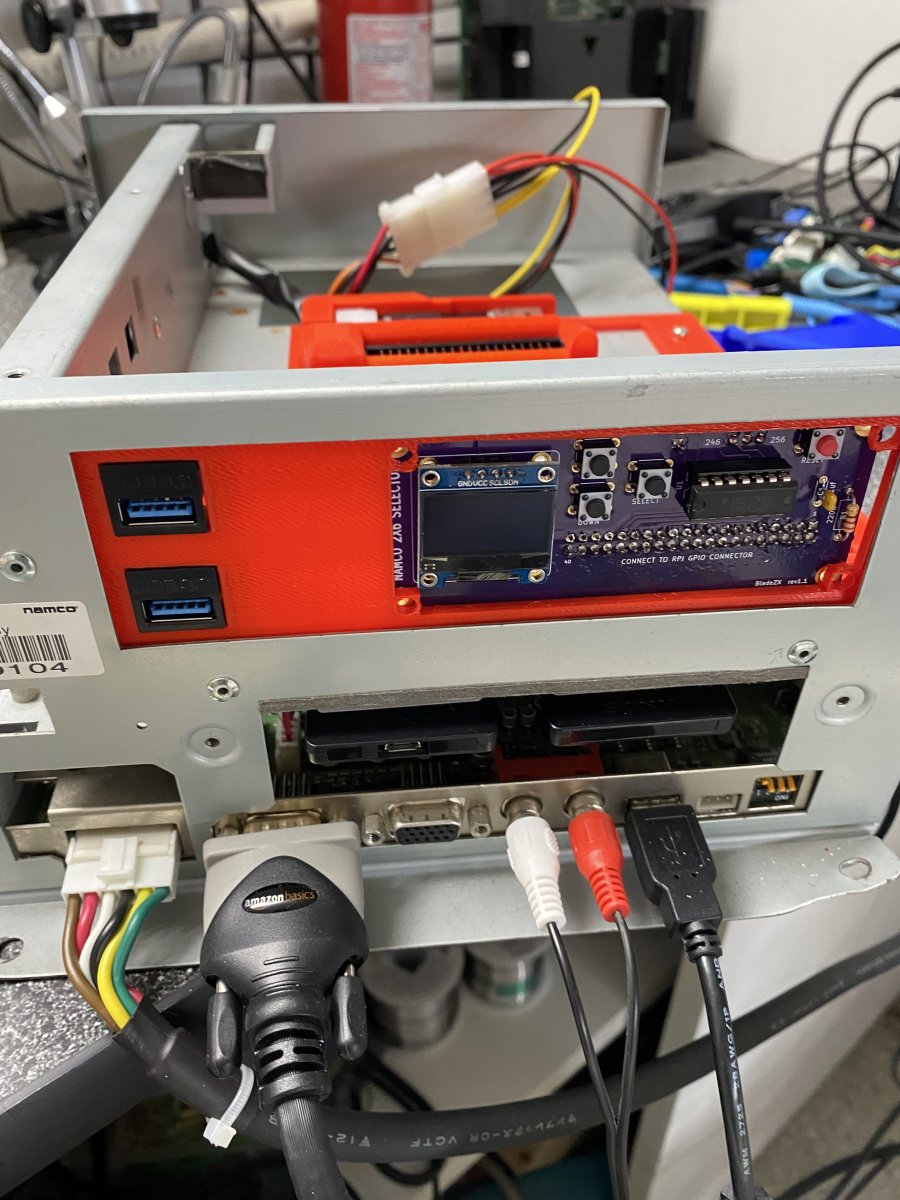

I did some messing around with electric_monks original holder... here is what it looks like right now - the final I will print in black PLA.
it uses 2 keystone usb-a connectors. I have some usb-a to usb-a small cables coming today - assuming those all work, I think this will be great.
I am also going to experiment today with breaking it into two parts and then gluing them together. This was all one piece - but printing the faceplate "face down" is much stronger.
