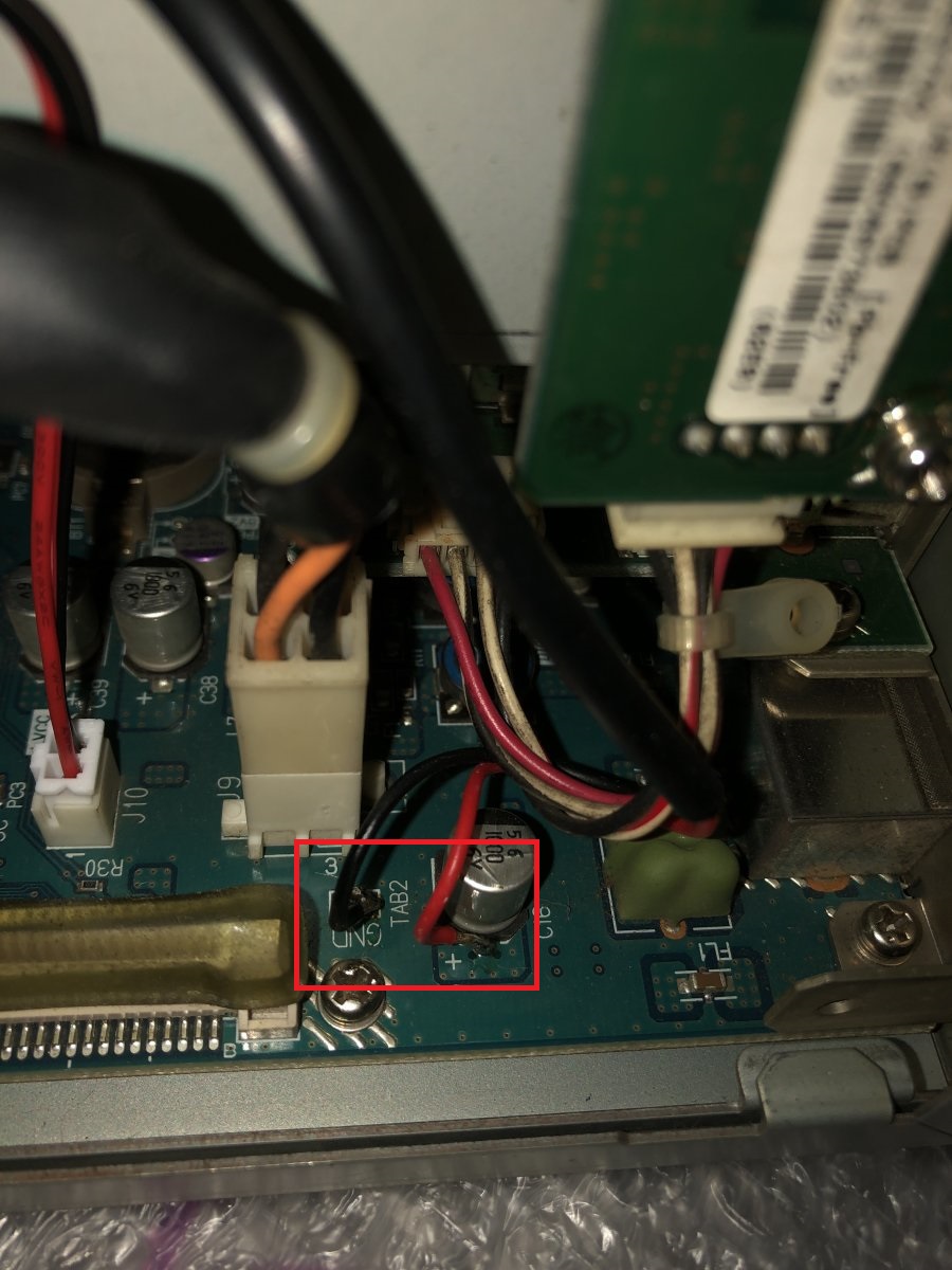

On my 256 I have the molex plugged into the ODE simulator. I have USB plugged into the Rpi but I got the 5v from the motherboard on my 256 - I will update this post with a picture of my 256 and where I tied into 5v and GND for the Rpi usb cable - ** picture attached
On the 246 I could not do that so I tied into the molex cable 5v and GND
*** This picture is for the 256 ONLY
