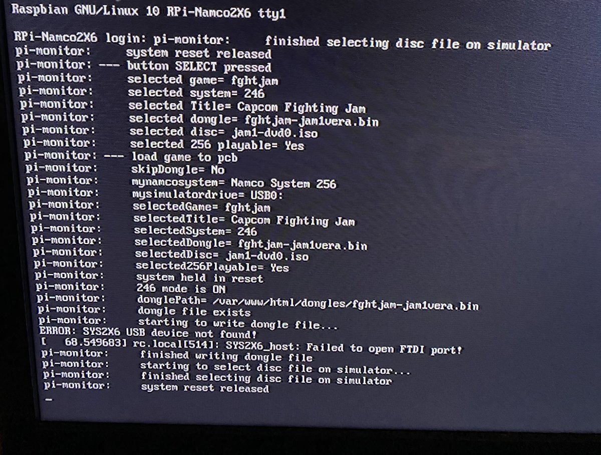

Hola @BladeZX et al , I’ve been putting together a 256 multi with @mathewbeall ’s help. Everything seems to be in order but it won’t flash Brizzo’s dongle, always says SYS2X6 USB DEVICE NOT FOUND.
The dongle flashes just fine manually on the computer.
Setup:
-Dongle plugged into 256, and through front panel to rpi
- USB thumbdrive to ODE USB0 (through ugreen adapter)
- ODE USB1 to rpi
- have the reset wire soldered and the 3 wires going to the 256/246 mode connectors
- power goes from molex through adapter to rpi, ode powered from rpi
I’ve replaced each of the wires and connectors just in case it was a faulty cable, and nothing has changed.
Any ideas? Thank you!

@FrAshi
Code:
 *            SYS2X6 USB DONGLE SOFTWARE SETUP FOR RASPBIAN
  FTDI Drivers and Configuration
Download package:
https://www.ftdichip.com/Drivers/D2XX/Linux/libftd2xx-arm-v7-hf-1.4.8.gz   (As of 2019-06-08 this file is actually a .tar labeled as .gz)
Extract and follow insturctions in ReadMe.txt
  Define UDEV rules for SYS2X6 USB Dongle:
1.) Create and edit file /etc/udev/rules.d/99-sys2x6.rules
2.) Add contents:
SUBSYSTEMS=="usb", ACTION=="add", ATTRS{idVendor}=="0403", ATTRS{idProduct}=="6015", ATTRS{product}=="SYS2X6 USB DONGLE", MODE="0666"
ATTRS{idVendor}=="0403", ATTRS{idProduct}=="6015", ATTRS{product}=="SYS2X6 USB DONGLE", RUN+="/bin/sh -c 'echo $kernel > /sys/bus/usb/drivers/ftdi_sio/unbind'"
3.) sudo udevadm control --reload-rules
