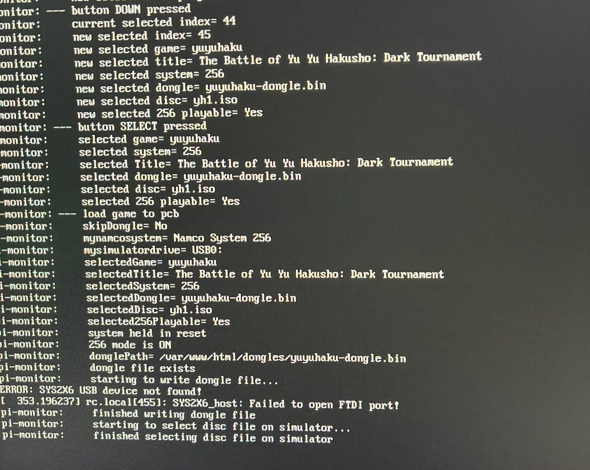

I’m still wrestling with this setup. I’ve got the multi installed in a 256 and everything works EXCEPT dongle writing. I’ve double checked that the usb cables are data (using same cable used to rewrite the brizzo dongle on my pc, which never has an issue.) It works great if I write the dongle manually… but the rpi (3b+) won’t rewrite.
IDE emulator has the updated firmware. I’ve quadruple-checked all cables, made sure they are data carrying, etc. Just won’t rewrite the brizzo dongle.
Any ideas?

Ok- error seems to be:
SYS2X6 USB device not found!
[ 361.181065] rc.local[455]: SYS2X6_host: failed to open FTDI PORT!
Edit: this is the same that comes up when the dongle is not plugged into to USB port, so confirmed that it’s not recognizing the dongle. Computer has no problem rewriting it.
Edit 2: ok, I took a longer cable and went directly from the dongle to the pi, bypassing the passthrough connector on the multi mount, and I’m in business! So now I’m wondering if the passthrough somehow connector is faulty? Or the pi has a problem with micro-usb cable that my pc works fine with. Either way, I’ve got it isolated to a couple things, so troubleshooting about be quick.
Final edit/problem solved: It was the micro usb to usb cable from the dongle. Works fine for dongle rewriting on pc, but not on the pi somehow 🤷‍♂️
Thanks Matthew for steering me right!
**REAL FINAL: Actually it turned out it wasn’t the cable… after a few game switches, the dongle rewriting seems to stop working. Power cycle seems to fix it. Wild ride!

Is the ftdi_sio kernel module being loaded? That may conflict with sys2x6_host. There should be a blacklist entry for the module, or at least call "modprobe -r ftdi_sio" first, I think.

So actually it isn’t really working and it wasn’t the cable after all lol! Thought I had it figured out but nope.
Now the problem seems to be that it is underpowered… I’ll put up the recurring error later. Have tried two good Sun PSUs but am concerned about turning the voltage too high… although I understand that the extra stuff plugged in for the multi draws more power but don’t want to fry anything. What are you running your 5 and 3.3 at with the multi?
When underpowered, the pi seems to skip functions or freeze. I’m guessing that this is more of the culprit for dongle writing/recognizing than cable issues.
Temperamental is right! 🤗
On my bench, I use a CBOX to power the Namco 256, and in my cabinet, I use a arcade power supply, and then an adapter to provide power to the Namco. In both cases, I provide enough 5V rail so that that the Namco is stable. It isn't uncommon for my Rpi to say "undervoltage detected", but all of this isn't very power intensive for it. Do you by any chance have another Rpi you can test with? I haven't had a situation where the Rpi just froze up before.

Tried with my other pi, exact same issue - very inconsistent recognition of SYS2X6 USB device - about 5% of the time. Tried different data cables. :(
